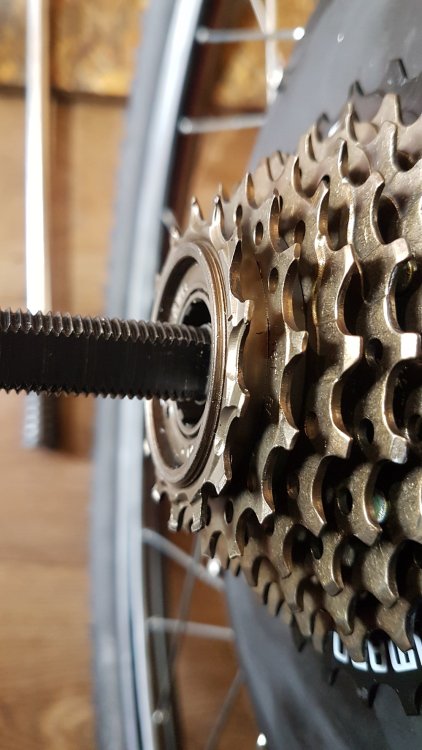

  11. So I have a new rear wheel kit. Trying to fit a 7 speed shimano freewheel and there is no clearance? The washer hits the cog please see images? Am I missing some proper spacers?
