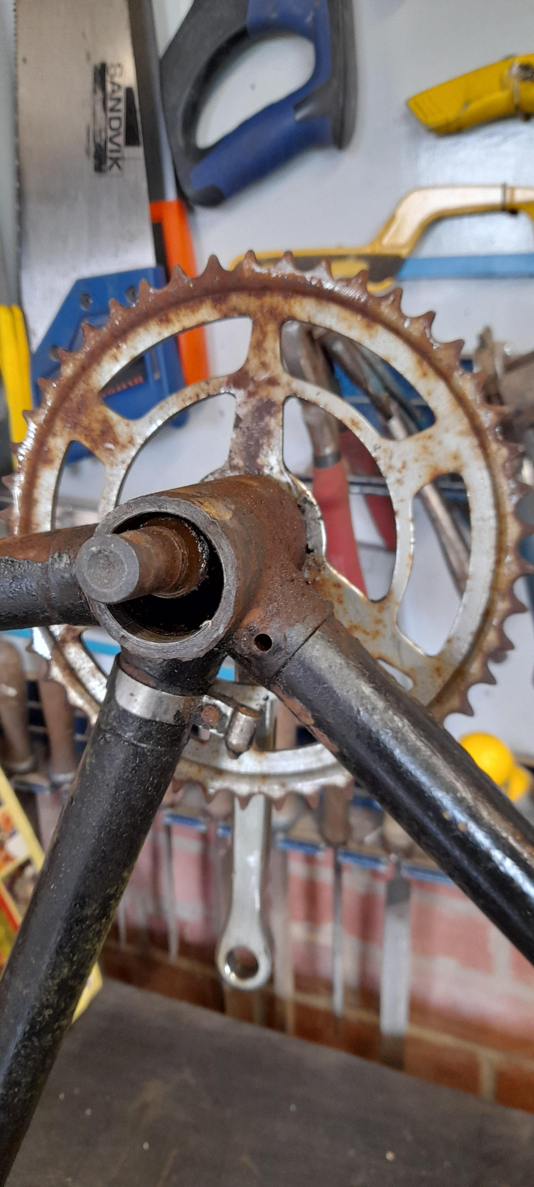

Thanks! So crank and chain ring should just pull off like the other side so I can get to the other bearing? Its very tight. Might have to get a puller of some sort....

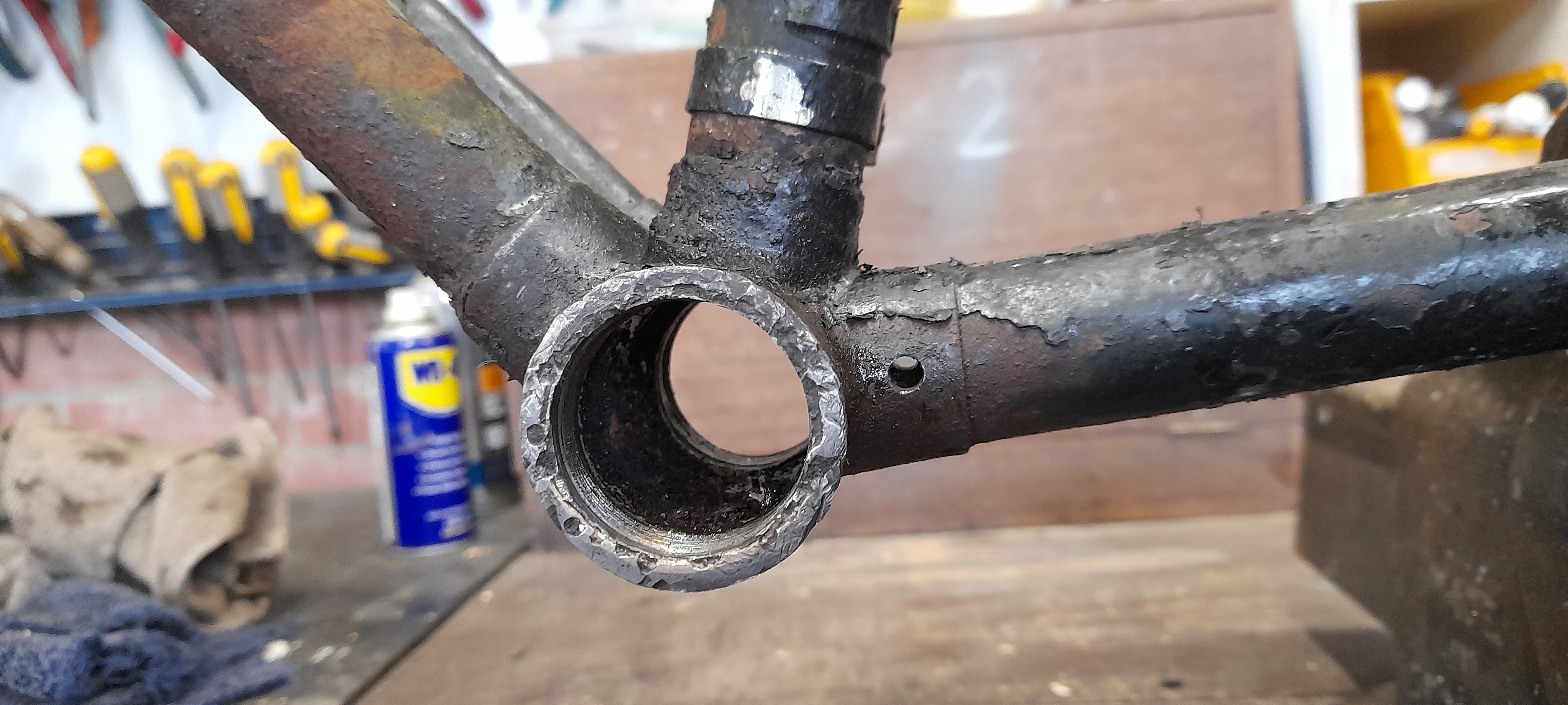

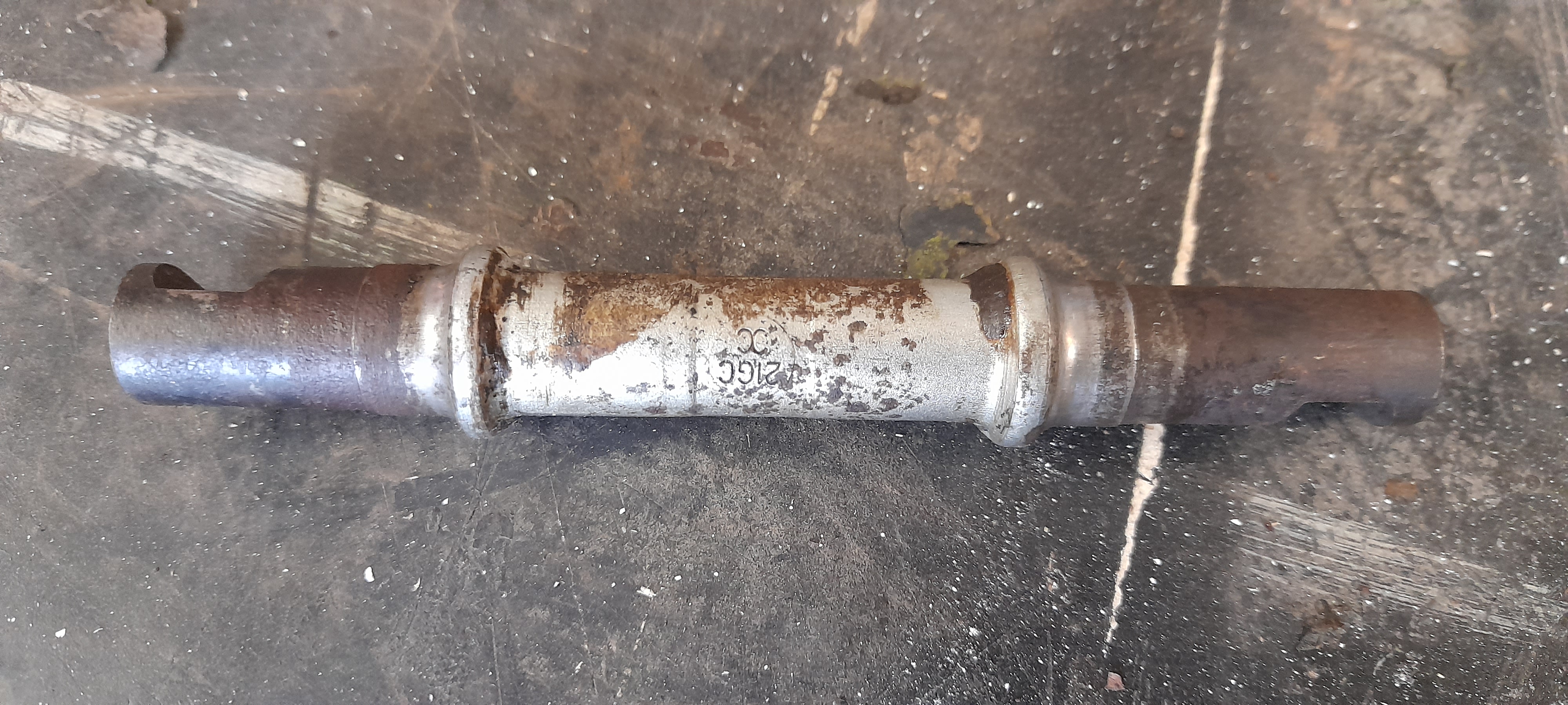

So I got this far by simply unscrewing the LH side of the bottom bracket assembly, surprisingly easily! How does the shaft come out though???

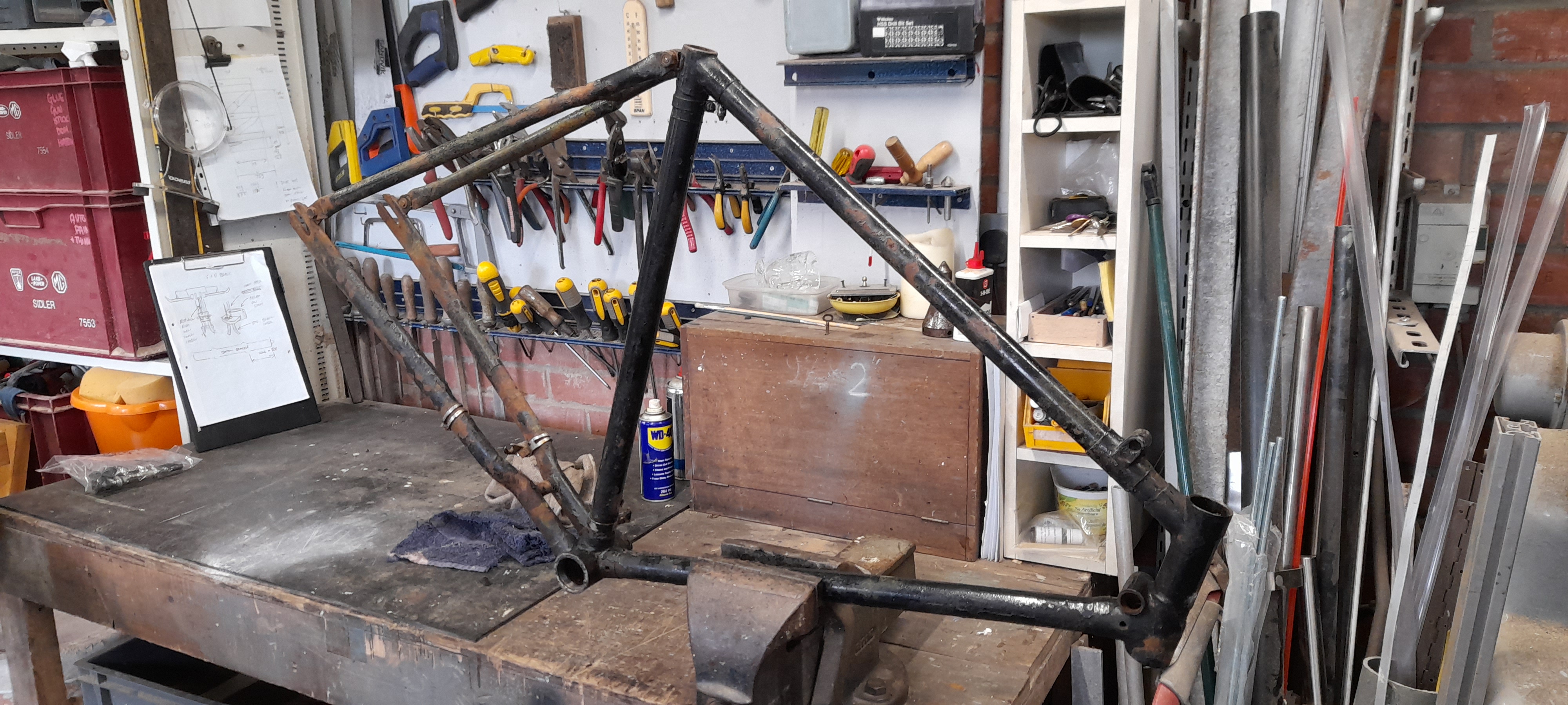

Forks are out and seem OK. I'm stripping the frame right back then getting the paint all off too, so far nothing structurally scary- Front hub conversion on vintage delivery bike. Battery suggestions and best motor query
