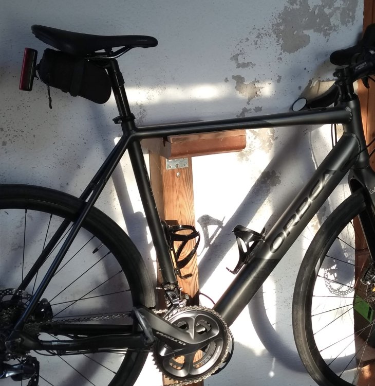

  8. Excelente Antonio. You have found that the extender provides more than the 2a charging current when the motor is drawing more than 4a under load. This is what I had hoped. But would this be possible if the extender acts as a passive charger, and as the main battery is depleted more quickly when under +4amp load, that the extender is simply putting more charging current into the main battery? Have you tried to establish whether the extender will equalise slowly (‘charge’) the main battery if the extender voltage is the higher of the two, or whether, as Volabike claim, current is taken solely from the extender under load until the two batteries are at equal voltage?

  10. No, jump on in! I am definitely coming to the conclusion, reinforced by the gurus here and many others, that all of these extenders work the same way. Passive ‘charging’, with some form of reverse protection and relying on the internal battery‘s BMS to limit the incoming amps to 2. If you take the charge port apart on the gain there are two thick wires and two thin. Perhaps this does relate to an original intention to somehow parallel the extender using the thicker wires with the two thin wires used for the mains charger, but for me, I am simply happy that mine works. If we ever get reasonable weather here and I get the time I will def run some tests, but I think both the Mahle and Volabike extenders may well be simple batteries with the addition of a Schottky or Ideal diode used for protection. Pretty cynical stuff if so, and an opportunity for a small-scale manufacturer to steal the market, like Volabike should have done, if they hadn’t been greedy.
  11. Hi Antonio - I’m the same Yak as Yako Rides aGain, so yes I did and it works perfectly.
  12. I’ve spent a lot of time trying to track down and talk with the guys that have built their own Gain range extenders. Most posted 2019/2020. I’ve had no luck reaching them and am beginning to picture their charred remains in various places around the world as their att attempts ended badly! I’m going to go ahead though…I really need the range until I’m fitter - and look how stealthy that second 7ah battery is!!
