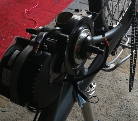

  1. Hi [mention=9614]Nealh[/mention], thanks for the suggestions but I don't have wheel sensor /spoke magnet and I'm reasonably sure that the motor didn't hit the ground. The problem occurs as soon as you turn on the system at the handlebar control - one flashing LED which the manual tells me is a battery fault. Last night I reconnected my old Sunstar battery which works I'm sure (has a limited range), exactly the same fault reported.
  2. Hi, I’m hoping there might be somebody with Sunstar ibike experience here (it’s a Japanese crank drive system that is now out of production)? My Sunstar battery only gives me a few miles range now so I bought a new x-go 24v battery from ebay and soldered it in a couple of days ago*, initially it seemed to work fine so I took it for a ride. Unfortunately I caught my rear wheel in a pothole which ripped the tyre/tube and damaged the rim so I had a long walk home! When I had the bike up on the stand at home I just tried to turn on the ibike as usual via the controller and it now doesn’t work. It shows a single flashing red light on the controller which according to the manual is a ‘Battery fault’ – so I was blaming the issue on the x-go battery. I have since swapped my old Sunstar battery back, which I know works but with poor range, and I get the same flashing light. Any thoughts on troubleshooting? I am now wondering if the ibike motor took a knock when I hit the pothole although I can’t see any obvious damage (unlike my wheel!). Many thanks, Chris

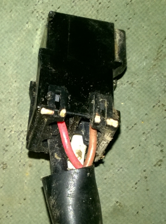

  5. Hi, I've had another look on the German forum I mentioned earlier ... it looks like the connector from the motor to the battery has 4 wires - a black and a white thick wire for power and a thin red and thin brown wire (the 5th connector on the battery holder doesn't seem to connect to a wire). And it does seem like people are saying that you can just connect the thick wires to the 3rd party battery (make sure you get the polarity right) and just bridge/short/connect the other two. I've attached a couple of pics, one showing the connector on the motor side and the other showing a project from the German forum, towards bottom center you can see the same 4 wires without the connector block and the two thin wires appear to be connected. Has anyone here tried this and can confirm it will work before I buy a battery. Cheers, Chris
