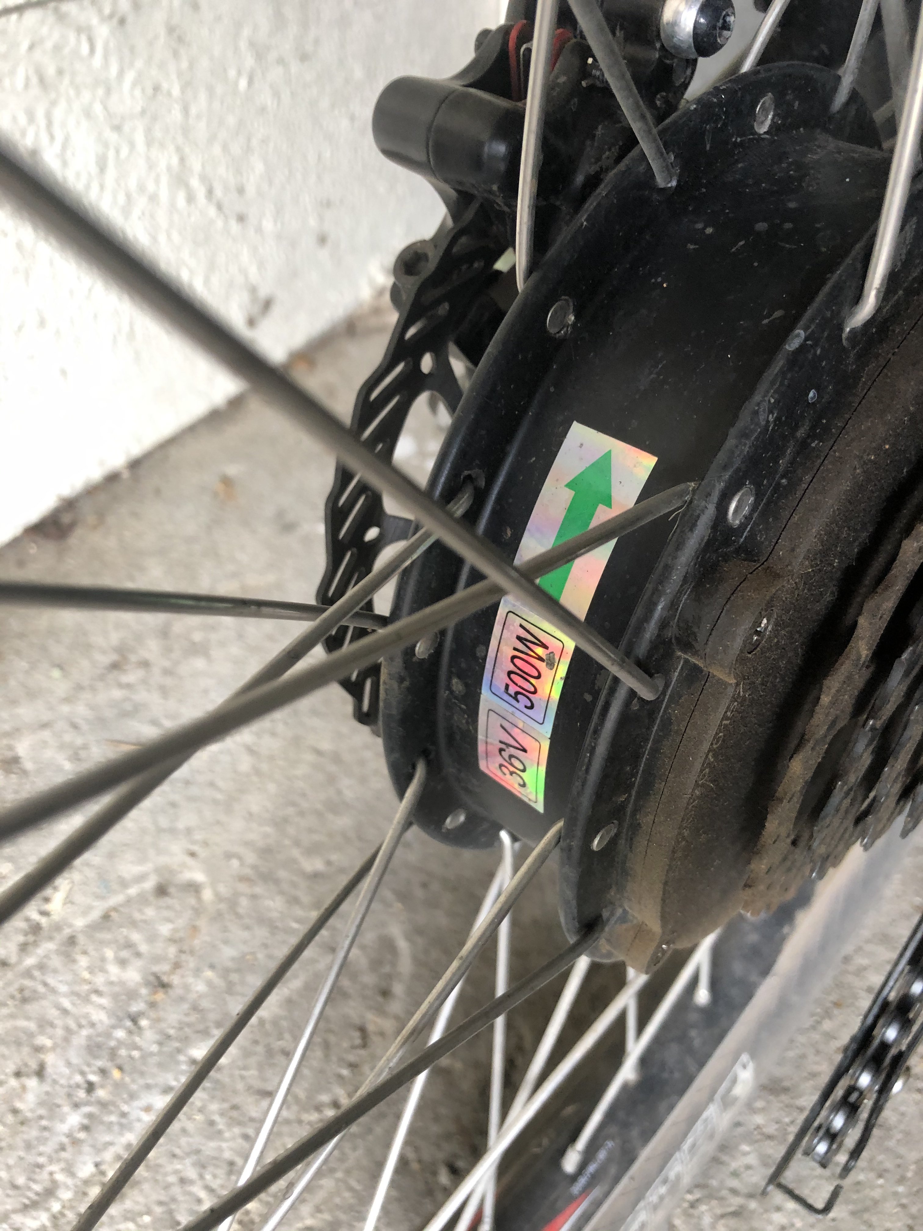

  11. the only writing/info on the hub is on the attached photos. I’m more than happy to take more from other angles is required?
