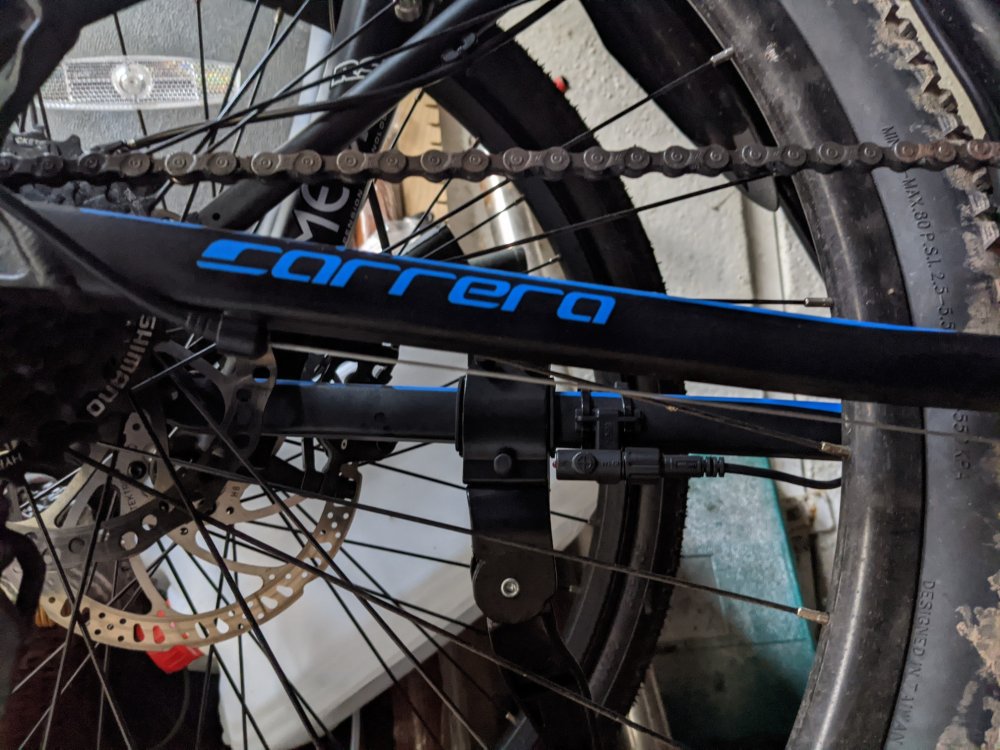

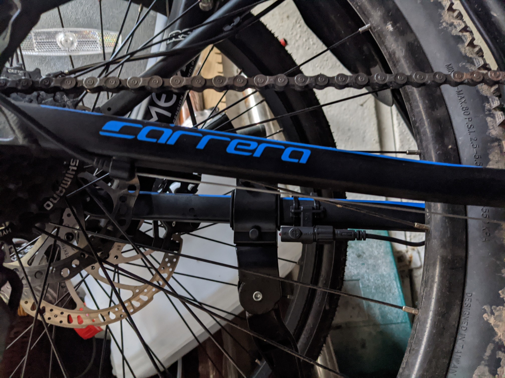

  3. That's it I don't have an out, apart from the very end of the cable.. see pic , cable outer end just under the C of Carrera
  4. sorry its a mid drive ( 750w )Carrera conversion
  5. Afternoon, As the title says, has anybody fitted one, I have a few vids all showing a gear cable covering which the carrera doesnt have.. its just a bare cable thanks

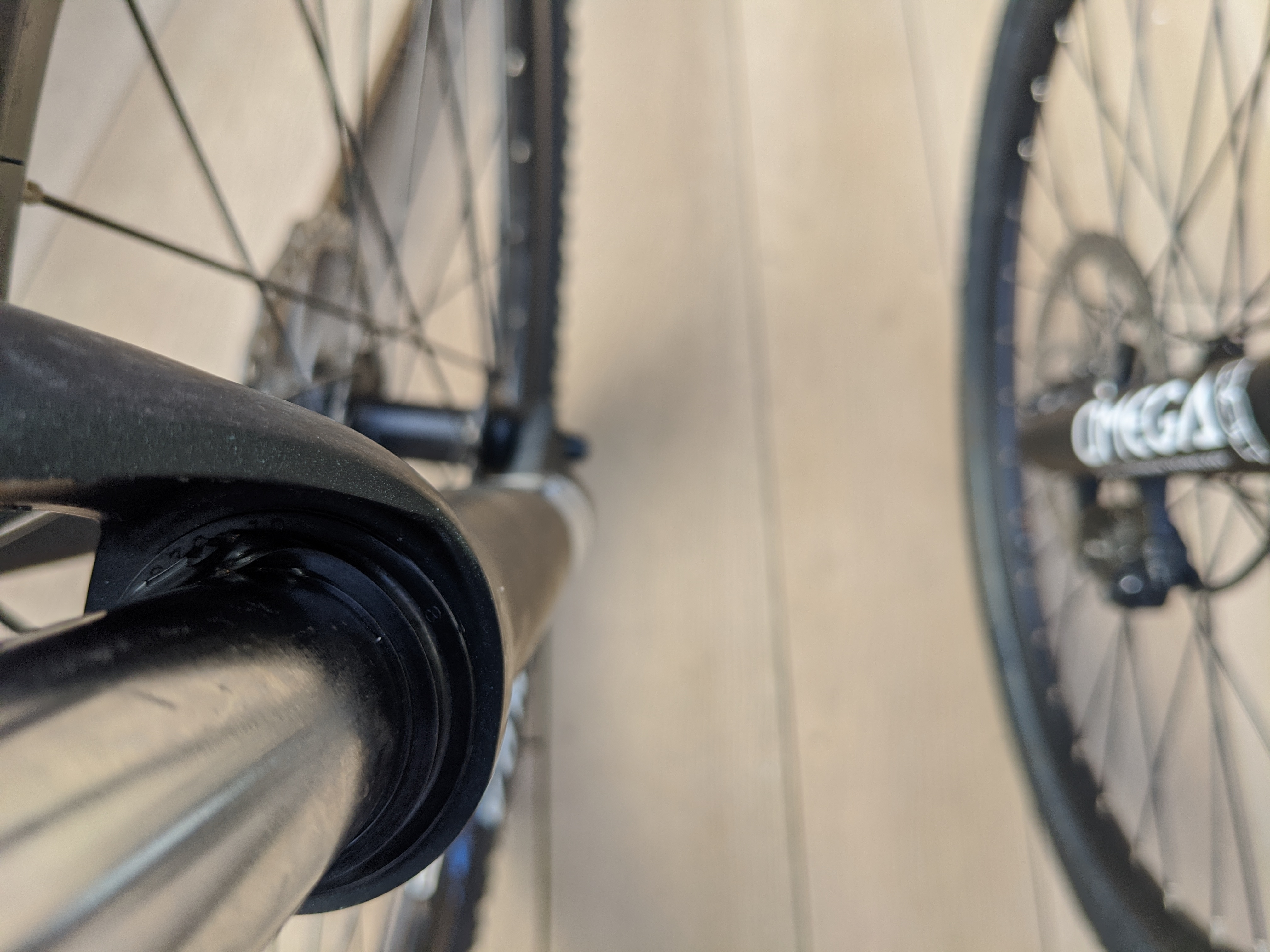

  6. So coming back from a good ride out today I've noticed the seal on my left fork has twisted, caught the fork somehow ( maybe sand related ) Any help how to fix this or is it a bike shop. New seal replacement Thanks

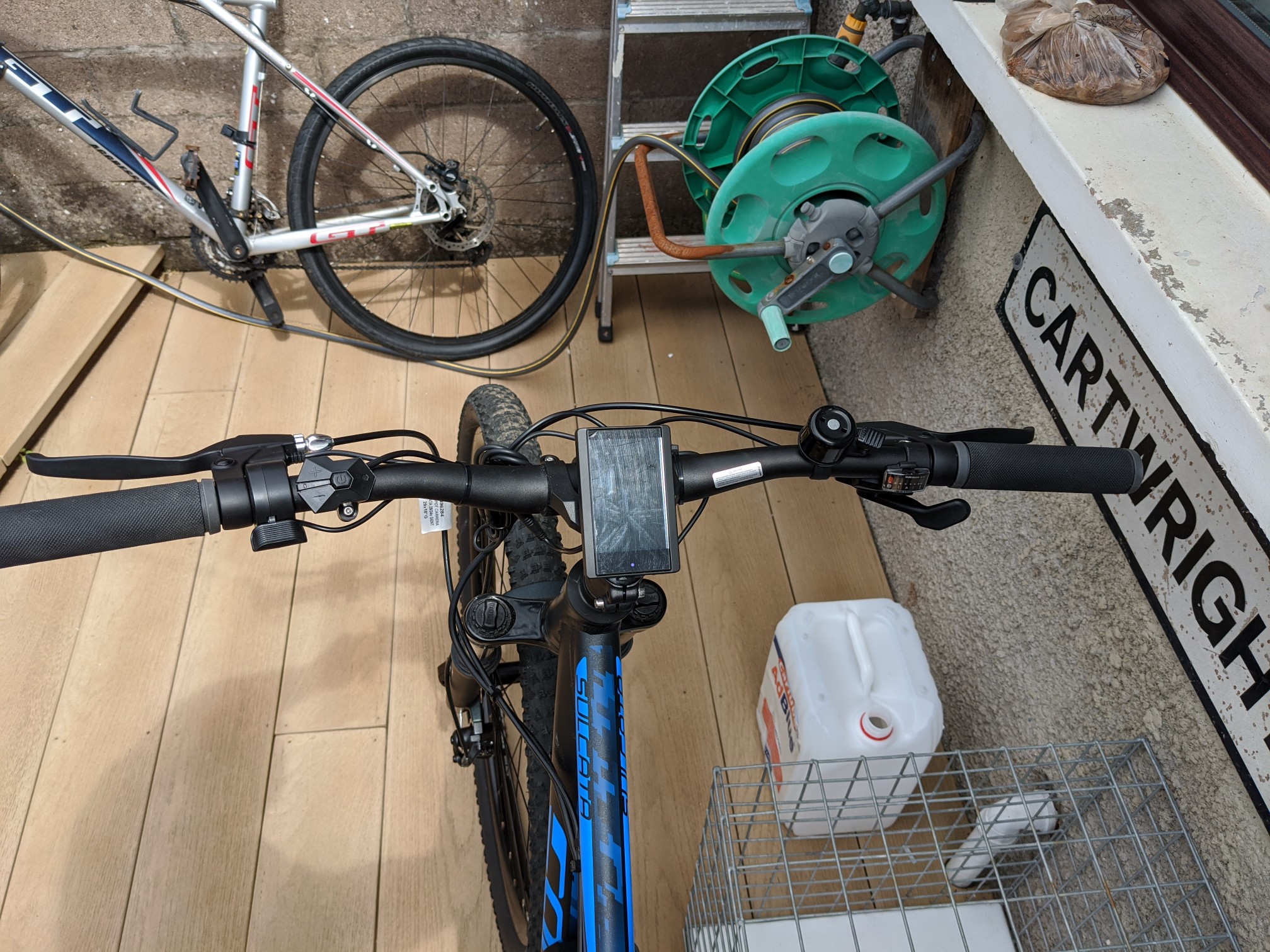

  9. I dont mind being a guinea pig just an idea really.. also whilst im here, I just been on a ride ( 15 miles ) all good apart from a red "i" icon in the top right of my diplay , the display is the p850c , it comes on and then disappears, there is no error code so not sure what it is

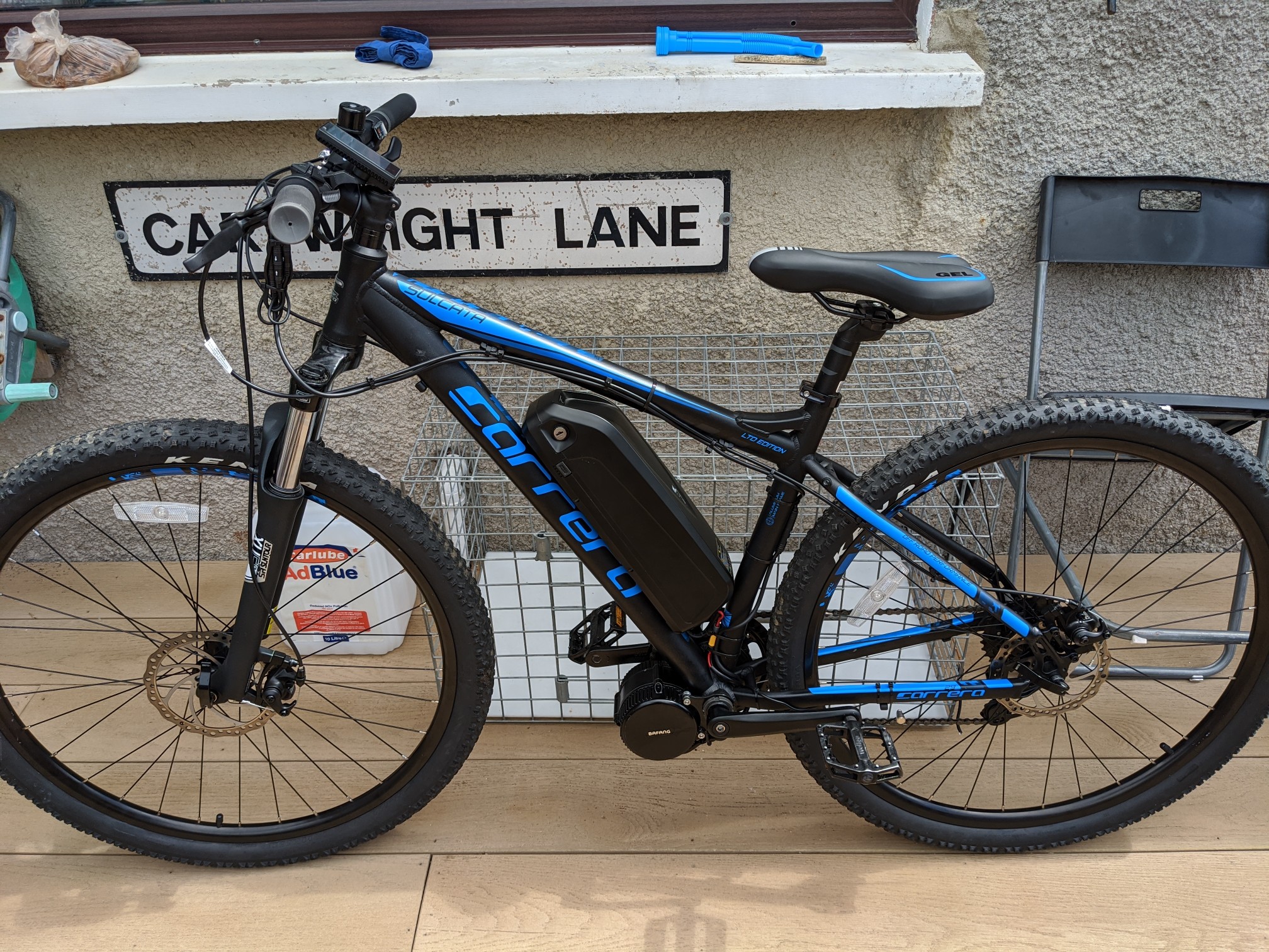

  12. All good, feels amazing to ride, only bug bear the the noise the brakes now make when I stop is awful, no doubt it's a tweak
  13. I went through your whole thread, nice bike and build ... Not sure about that bike ride from Heywood to Blackstone edge haha. Felt tired reading it
  14. thanks guys i'll let you know how i get on

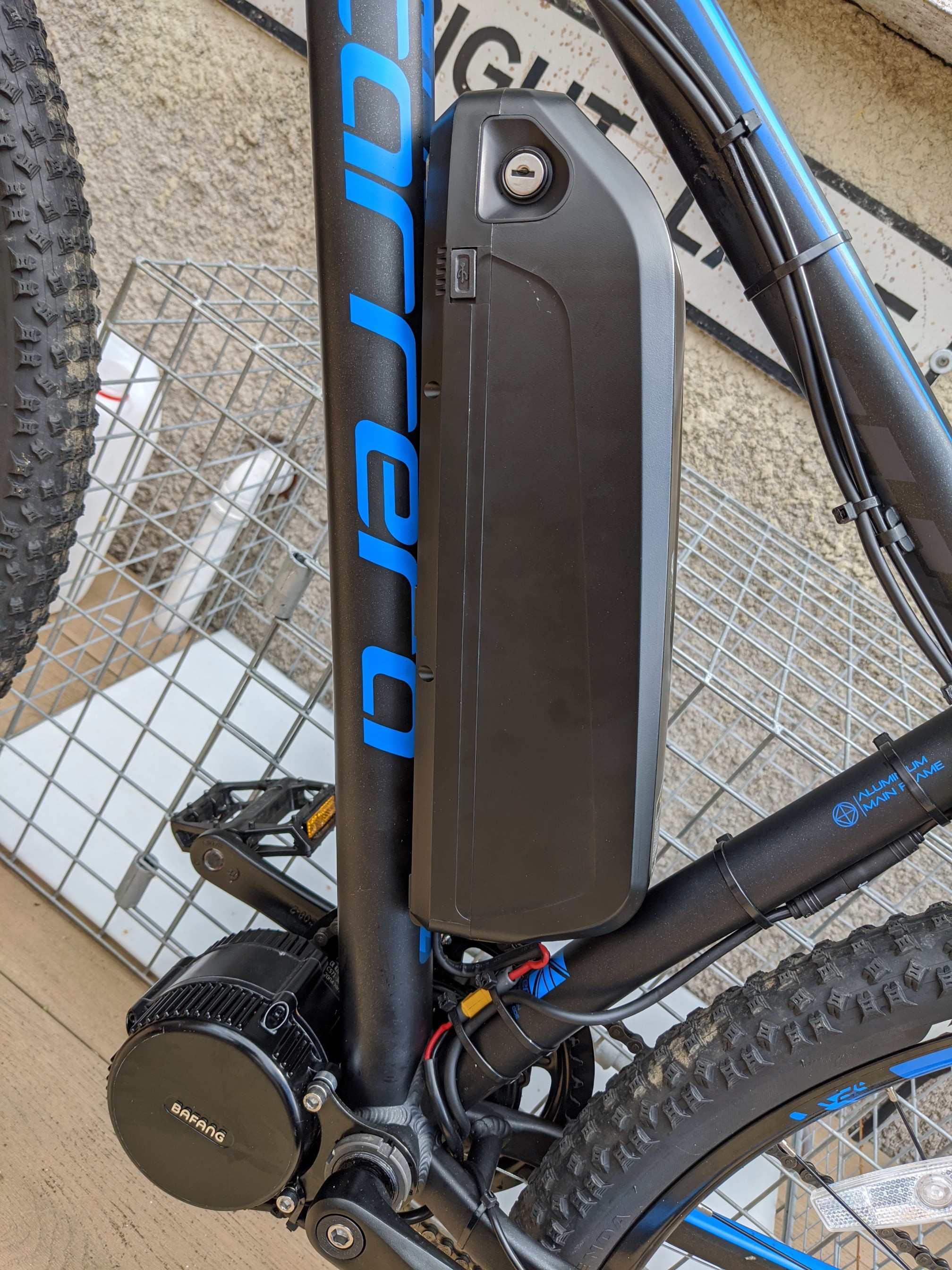

  15. Today received my bbs02b mid drive motor & battery, couple of issues, 1. There isnt enough thread for the M33 locknut to attach too, is this ok to leave off?? also the battery is going to be a struggle due to the bottle holes in the wrong place ( too low down the bar ) the carrera's mid section isnt the biggest so placing the battery with enough room to then take off will be touch
