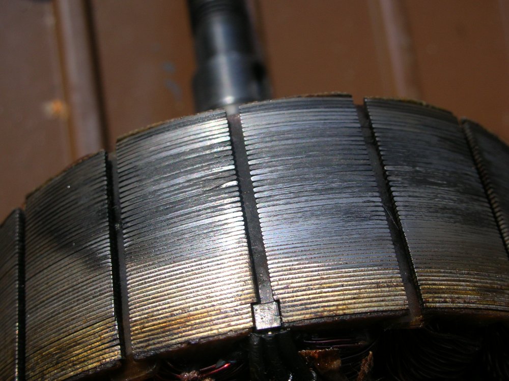

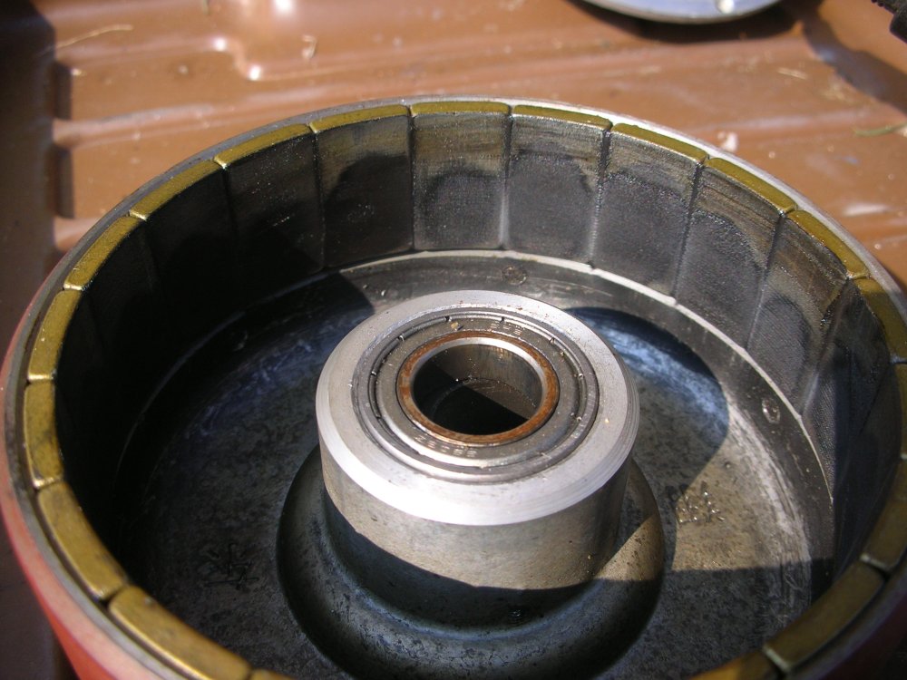

Well with advice from Flecc, Nealh and Scorpio and some careful repairs I now have my trusty flying machine back in action! A few 'red herrings' along the way just added to the satisfaction of hearing it (almost silently!) spin into action. Stripping the rotor out identified the problem? The hub was rubbing tight on the stator winding in one place.....(no idea why) The inner surface of the rotor looked to be coated with a black film....like a PTFE pan! (but partly worn through) The two sealed bearings were smooth, the jerky feel was as I though, the pull of the magnets.The high spot on the stator (probably 2 or 3 thou was dressed off with a fine file. This tight sticking spot was why it would not 'reverse' This plus the 'overgearing' via the sun/planet gears just could not spin the wheel backwards....bit like trying to push start a car in 1st gear! The one way carrier was as I suspected, OK. part of the normal epicyclic train. So, all reassembled and the fiddly wiring plugs sealed up it hummed into action. I wonder, if my washing the bike after a muddy run, then the next day it was noisy rough....the one poor hall sensor contact(wet when opened up) may have jiggered the motor? Oh, when I washed the pedal sensor disc....it fell into a dozen pieces, but I use the bike on throttle anyway!!! A great outcome, well pleased, thanks Pedlecs!

Hi Scorpio, your pic of open'ed up motor (24 volt?) confirms what I think, an internal bearing...that might have sized on my motor? You comment on stripping useful, as I once open up another brushless motor...the magnets were vicious, finger choppers! So far not ordered anything as I do not know what I will need, and the motor is 12 year old,probably obsolete/superseded. I can't see any real damage, v slight wear on nylon gears and the jury still out on the 'one way'? clutch/carrier. Can you say if yours turns just one way, locking in reverse? exciting weekend ahead I think....more familiar with classic Mopeds !

Hi ,Update, had another look at motor, it seems rather stiff to turn magnet/cover, which drives the sun wheel. Maybe this is the 'bumpy' action on the magnets and normal? The clearance around winding seems( with some 002" brass shim stock) more tight over on one side. With a 'mock up' of the wheel in a vice, very slightly turning the magnet cover enables the wheel to move slightly in correct direction. Forcing the wheel 'backwards' (and aiding magnet cover backwards to move will allow some backward movement. (The action of 'overgearing' an epicyclic train does this). SO....I think the one way ratchet carrier is functioning a it should. Some stiffness in the motor innards....( a sleeve bearing?) might be the fault.....but opening the motor ....I need further advice! forgot some pics, oh the gears are not cracked, it was a scratch mark, but well spotted Flecc! thanks Ted

Well, the nylon gears, whilst no missing teeth (a reason for the mysterious banging?) they looked a bit 'slack/sloppy' on the ring gear, the centre running area of the gears was probably 0.010" (ten thou) worn. The puzzle is the sun/pinion wheel carrier. It seems like a one way ratchet? It moves smoothly....but will not permit reverse direction? Which means the wheel, when mounted will not permit the bike to be wheeled backwards...(it was possible before, but, with some slight resistance). I see replacement gears are avail from China for £6.00 a set ? or maybe £6.00 each, depends which seller's copy I read! There was no bad smell from the electrical motor, so probably OK? What I found when slitting open the cable connection 'sausage' was water ! and some 'green' on tiny transistor feeds.....could this have induced an electrical 'switching' bang? (I had a hall effect transistor fail in a Powerbike years ago and it made the motor do a regular 'bang' . Probably worth ordering new gears, some are white, some are blue? Not sure if the grease is specific for nylon? I have HMP 'moly' bearing grease. Do you think the carrier/one way clutch is a problem? I can always lift the front if needed! Thanks for your time to read this essay! regards Ted
