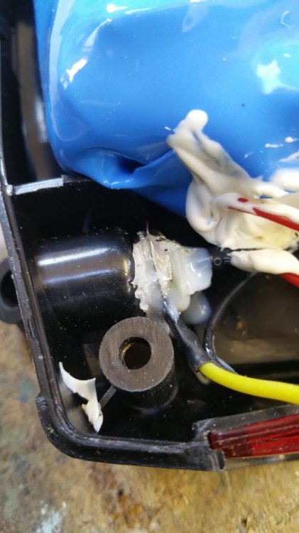

  3. Hi Wisper owners. Another electrical fault, this time on my wife's bike, which I thought may be of use to anyone with the same fault. The charger connection has been intermittent for awhile now and yesterday the only way to make it work was to pull slightly on the cable and plug and hold it like that. So I suspected a poor connection behind the socket and sure enough that was what I found after taking the battery cover apart, see photos. I had to remove the sealant which had set hard, which was the most difficult part, and then tighten up the lock nut which grips the -ve connection tag. All is well now!

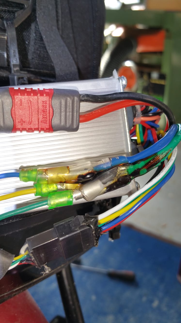

  5. Wisper fault update. New control box from Wisper fitted, cut off the bullet connectors and fitted MT60 3 pole 30 amp gold plated connector available here (thanks Nealh). Big difference, more power and no stoppages, 20 mile trip with some serious Cornish hills and no problems. Incidentally the clicking sound on each rev of the crank also solved by tightening the pedals with spanner and long pipe for extra leverage. Thanks for the help folks!

  7. Nealh, thanks for that recommendation great idea if they will fit in with all the cables otherwise I would solder and heat shrink. Problem before was it was all stuffed in the small space and the control box must get quite warm so very little air circulation. With Wispers legendary support service I hope to have it fixed soon and get up those hills round here!

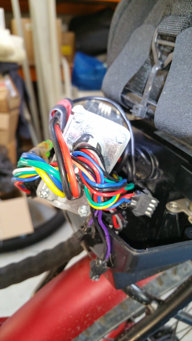

  8. Thankyou David, I have done that and sent the attached photos which I believe show the fault. I took the cover off the control unit to reveal a narrowly missed potential fire! I have to say I was disappointed to say the least at the quality of the electronic connections in that tiny compartment on an expensive bike. I await a reply from Adrian

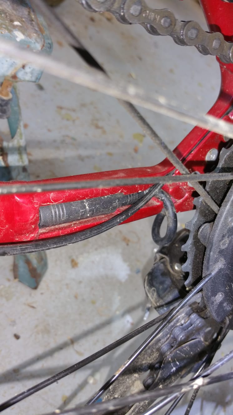

  10. Thank you for the speedy response. I have made sure the connector has not come apart at all but it is a major job disconnecting and electrolubing it, see attached. And its under warranty. I am surprised the connector is in such a vulnerable inaccessible place!
