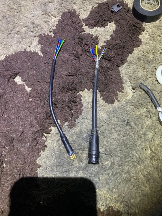

  12. i did notice different p codes / settings when scrolling through the menu on the display, as i read on the instructions that you could adjust the speed limiter on the kt controller or on the display, whichever controls it. i will have a more in depth look when i get home as i didnt want to fiddle too much with it as it was working, also the chinese to english instructions arent exactly clear as some things are worded exactly the same but in reality are different.
