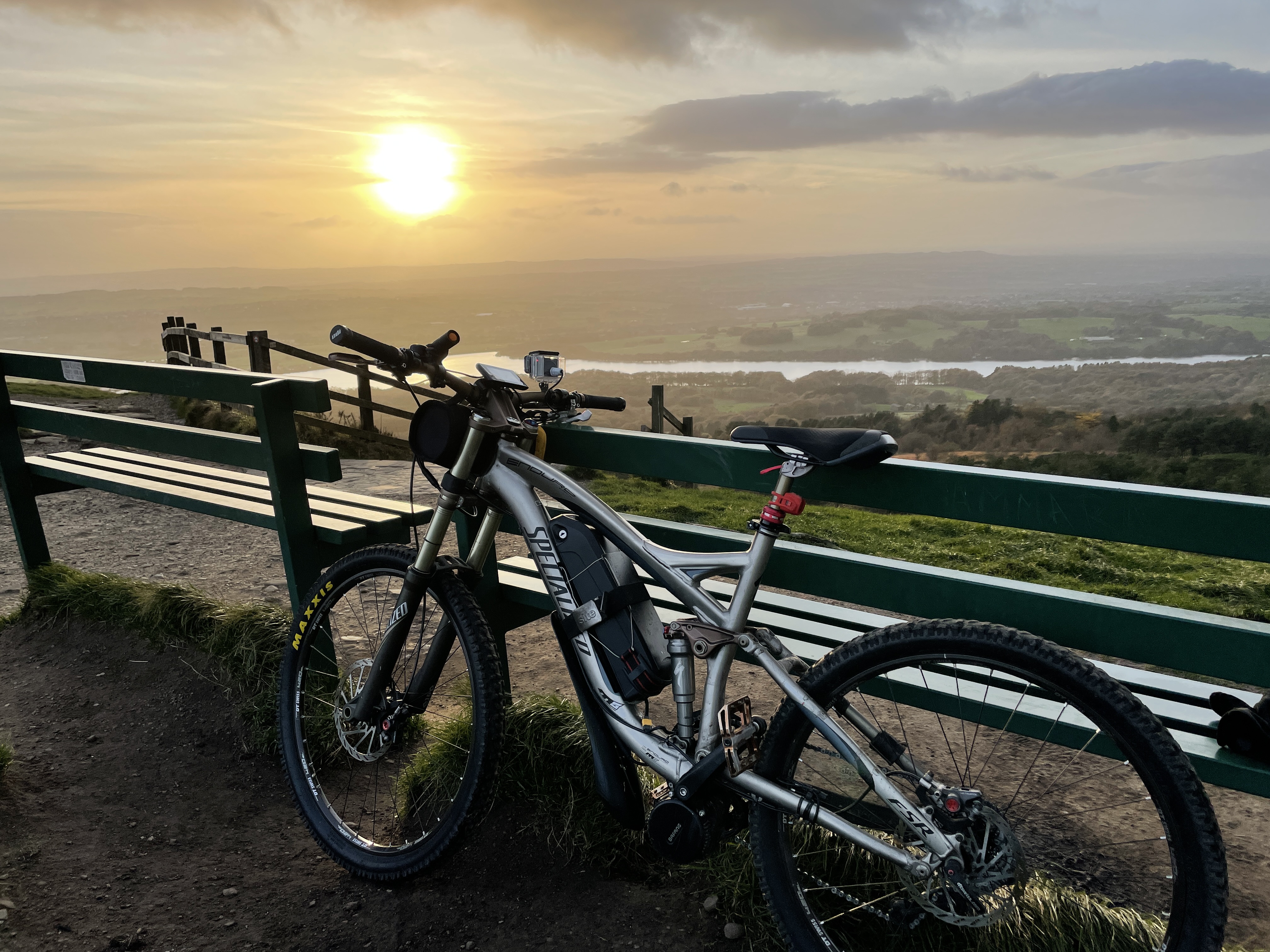

  1. Hi All, After a year of trouble free and enjoyable riding clocking up 1200 miles of lanes, tracks and canal paths (no downhill other than brief times) My Mate with the same motor on a hard tail is always out in front of me, How much wasted effort am I using having the full suspension compared to his hard tail given the type of riding we do? That got me wondering if I bought a frame only for my existing 26 inch MTB Would it sound possible just to move all the components from my existing onto a new hard tail frame given that the components are a good spec ? I've seen a Cotic BFE frame on auction and wondered if I should bid and convert. Any advice on frames suitable would be appreciated. Cheers Gary

  4. Hi all, I’ve fitted my bbs01 kit a couple of weeks ago and had two good runs out and about while this dry weather is here... It goes along ok while on pedal assist quite a steady pace but when I used the throttle it pulls away like a train..... is there an option to make PAS and Throttle have the same output? Thanks
  5. I’ve bought and received the kit and am looking forward to fitting it hopefully this weekend, I checked my frame and the standard battery does fit in but not with enough height to release it from the cradle, I’m hoping to create a foam lined bracket that will hold it in place.
  6. That looks good, does it bounce loose if you’re going over rough ground?
  7. My neighbour has a fitted a whoosh kit a couple of weeks ago, I will try to measure his standard In frame battery to double check it definitely won’t fit in my frame, the chamfered top of your battery looks like it would help get it in?
