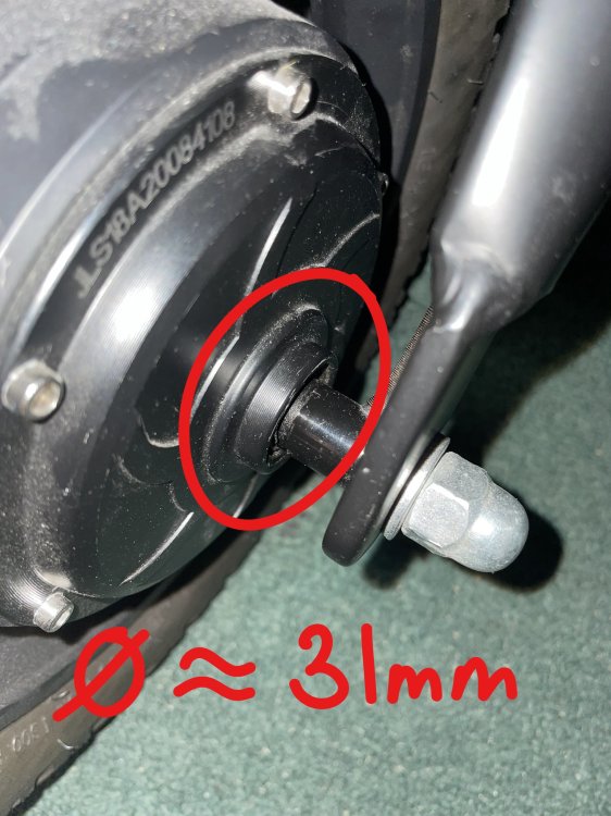

  6. Hi, I understand it is a compact bike, from my judgement, I can see (and hope) that the pedals shouldn’t hit the ground, especially when dis/mounting lowered curbs. I am also potentially considering changing the entire rear hub for one which can accept a freewheel more easily.
  7. Hi, I understand it is a compact bike, from my judgement, I can see (and hope) that the pedals shouldn’t hit the ground, especially when dis/mounting lowered curbs. I am also potentially considering changing the entire rear hub for one which can accept a freewheel more easily.
  8. I thought my picture captured the threads but I was originally under the impression that there were threads already present - can be felt when running my nail across the ridges. I always assumed any freewheel of that diameter would fit but on second thought, I am beginning to see how that may not be possible given how sleek the threads actually are. Having seen your webpage, I am also currently considering perhaps getting a different rear hub motor which can accept a freewheel more easily - your well documented install may be ever so slightly outside of my abilities!
  9. I thought my picture captured the threads but I was originally under the impression that there were threads already present - can be felt when running my nail across the ridges. I always assumed any freewheel of that diameter would fit but on second thought, I am beginning to see how that may not be possible given how sleek the threads actually are. Having seen your webpage, I am also currently considering perhaps getting a different rear hub motor which can accept a freewheel more easily - your well documented install may be ever so slightly outside of my abilities!
  10. Hello All, I currently own a CityBlitz CB020 operating at 36V 250W. It came with static BMX pegs from factory with no chain. I would like to add a set of pedals and a gear/ chain setup to begin to make it slightly more legal and road worthy (can move on to the pedal assist sensors later). As I am new to this, I have no idea what parts I would need and where would be fastest (maybe not China) to source them from. I have included a few photos and dimensions of things in which I believe could help others if anyone is able to guide me and provide me with links of things I would require. I have watched a few YouTube videos of people doing similar things but I am still unsure on what spec of things I personally would require. Thank you for reading. Any help appreciated.
