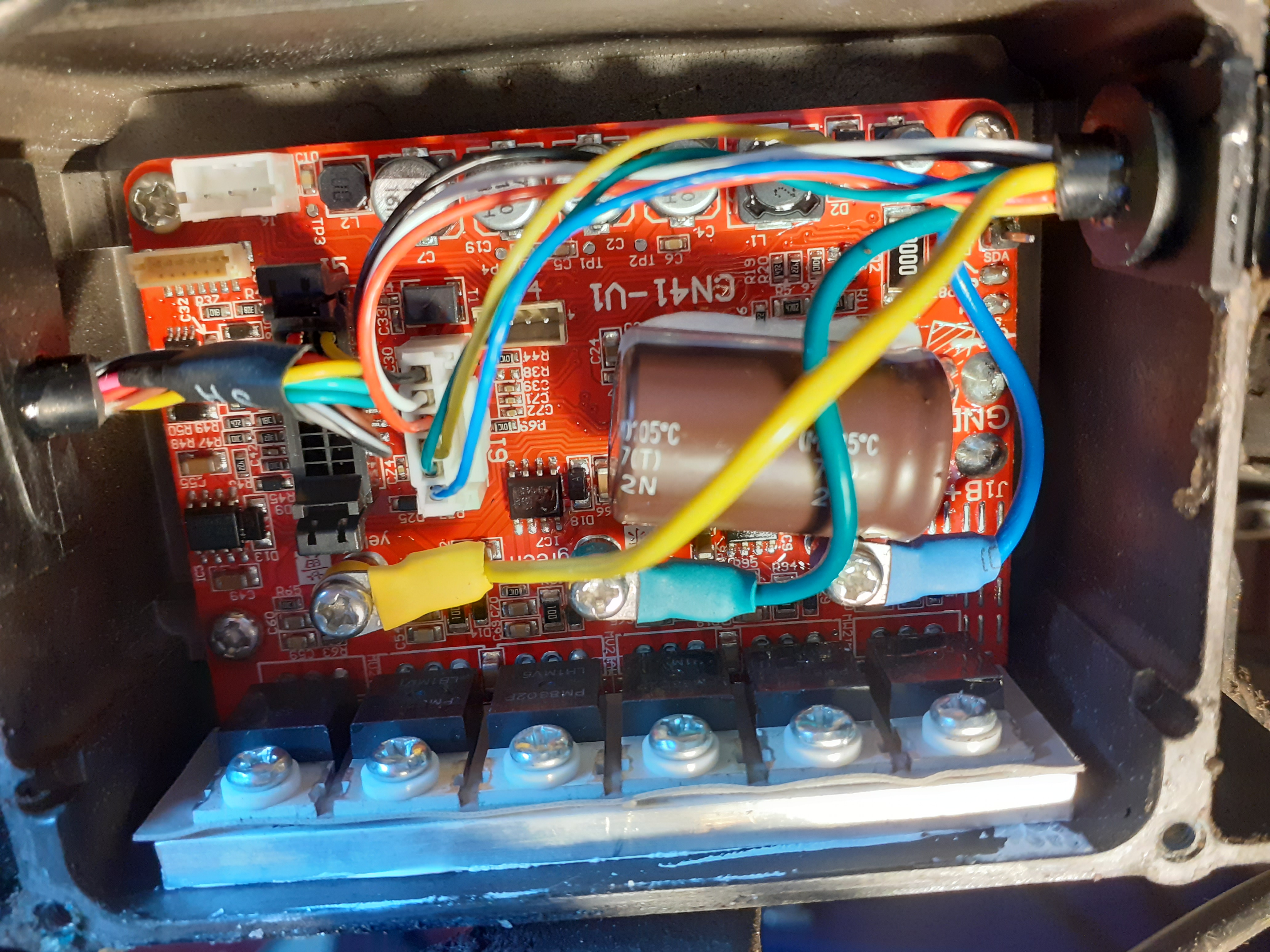

  3. It is a BL21. It has 4 pins and the outer two are 40-41V (unloaded) There are two inner pins that don't show any voltage Are they supposed to be 5v? That would explain a lot. I can't find any documentation to say that what the pins are for
  4. yes I am getting 40V to the board (across the two blobs of solder to the right of the capacitor) even so, no sign of life from either the display or bike lights It's only my hunch the fault is somewhere on the controller though
  5. Cyclebuddy, you are amazing! I will ask at Halfords next opportunity. Giving up hope, I decided I couldn't make it worse by opening up the controller and taking a look. Everything seems OK on both sides of the PCB and the power connection to the board says 40V. (There is white sludge underneath the capacitor but I am guessing the capacitor is folded down to fit inside the box and the white material is to stop it bumping into any contacts on the board - there are no signs of leakage) I will see if I can measure any voltage going into the DP15 display but it is difficult to diagnose further without a spare of everything
