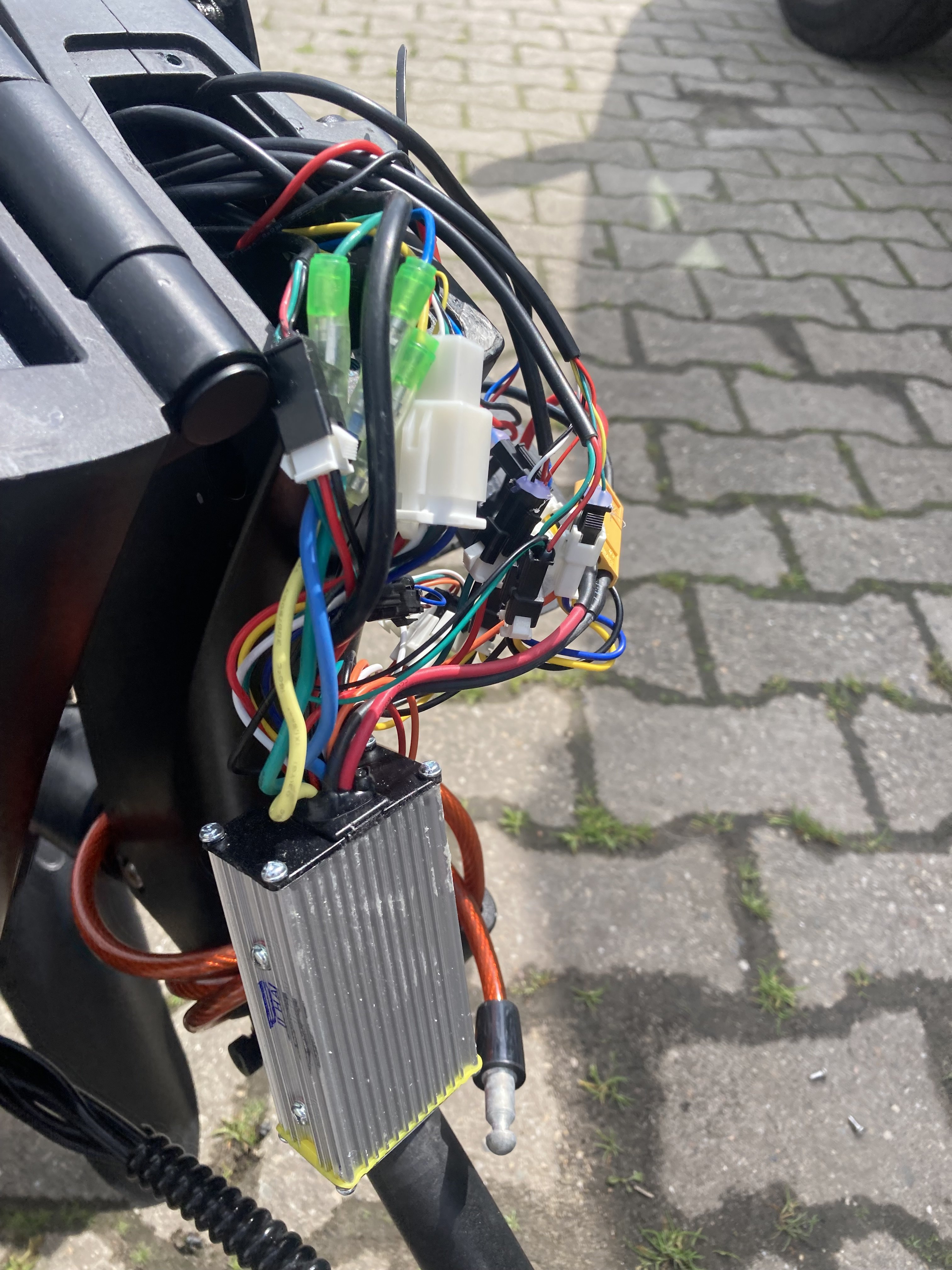

  1. As promised here’s my update. Firstly many thanks to AGS for the link to Onebot’s site. I emailed them at service@onebot.bike and eventually got a quote for $30 which I was able to pay through PayPal. They provided a tracking system and the new LED screen arrived this morning. All back together and working well. The new one is marked up differently to the broken one. See photos - new one on the right.
  2. Ok, I went to your previous post and cross referencing photos of my defunct led and the one I’ve ordered, it looks like I’ll need to swap one wire. I’ll keep you posted
  3. Sorry didn’t see this before replying, sounds like it will be a bit of a gamble as to whether I’ll blow up the led because the wires could be in a different order in the block connector. Is there any way to check which wire does and join them alternatively to the block connector?
  4. bridged the orange and red wires using tin foil in the connector and shielding the other pins with pvc tape. It works with throttle and pedal assist just as you said, but very weak. But hey, you saved the rest of my holiday in flat Holland! After searching YouTube and Amazon I went on AliExpress and ordered an led that looks identical to the one I’ve removed, but on closer inspection the five pin block connector has slightly different coloured wires and the small block connector only seems to have one wire instead of two. What do you think the chances are of it helping me out?
  5. So the small two pin connector is just for the lights? I’ve seen I’ll try to bridge those wires and now I know that the two wire connector is just for the lights I think I’ll try to buy a cheap Chinese LCD that has a five pin connector.
  6. Thanks for sharing. I’ve seen KT displays on eBay and Amazon all with a five pin plug only, but mine has the five pin as well as a two pin plug. Is the two pin plug necessary to get me going again, or do I need a display with both five and two pin plugs.
  7. Thanks for the reply, I’m not really well up on changing wiring to improve performance, but I’ve attached a photo of the LCD. If someone could identify it and tell me where to get a replacement I’d be much obliged.
  8. This is the broken display and type of connectors. Any help about where to get a replacement would be most appreciated.
