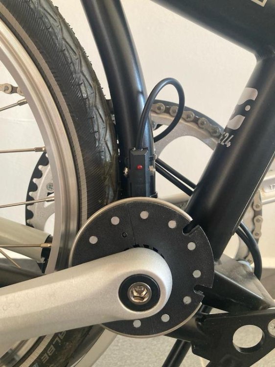

  1. I don't know if it's a double hall sensor or not. I'm attaching a photo of it.
  2. It works with C1=7 value.
  3. As Nealh said, the problem was caused by the distance between the magnet and the sensor. I narrowed the distance and the problem was solved. Many thanks to everyone who took the time. Good to have you here
  4. I am enclosing the photograph of the pas sensor and magnet disc.
  5. I did the p3 and c1 values as you said, but again the pass did not activate. I also checked that the pas inserted correctly.
  6. Thank you for your reply. I have checked the manual but I still failed to activate the PAS. Frankly, I don't quite understand what I should do. To give you an idea, the default values are as follows: P1 201 P2 0 P3 1 P4 0 P5 15 C1 7 C2 0 C3 8 C4 0 C5 10 C6 3 C7 0 C8 0 C9 0 C10 n C11 0 C12 4 C13 0 C14 2 C15 6
  7. I forgot to add the kit features. I have opened a new topic as you said. Thanks for your interest.
