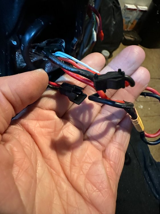

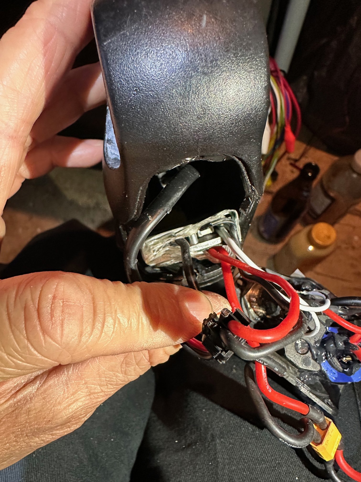

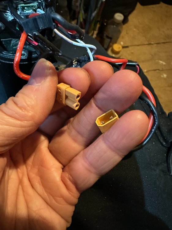

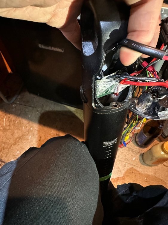

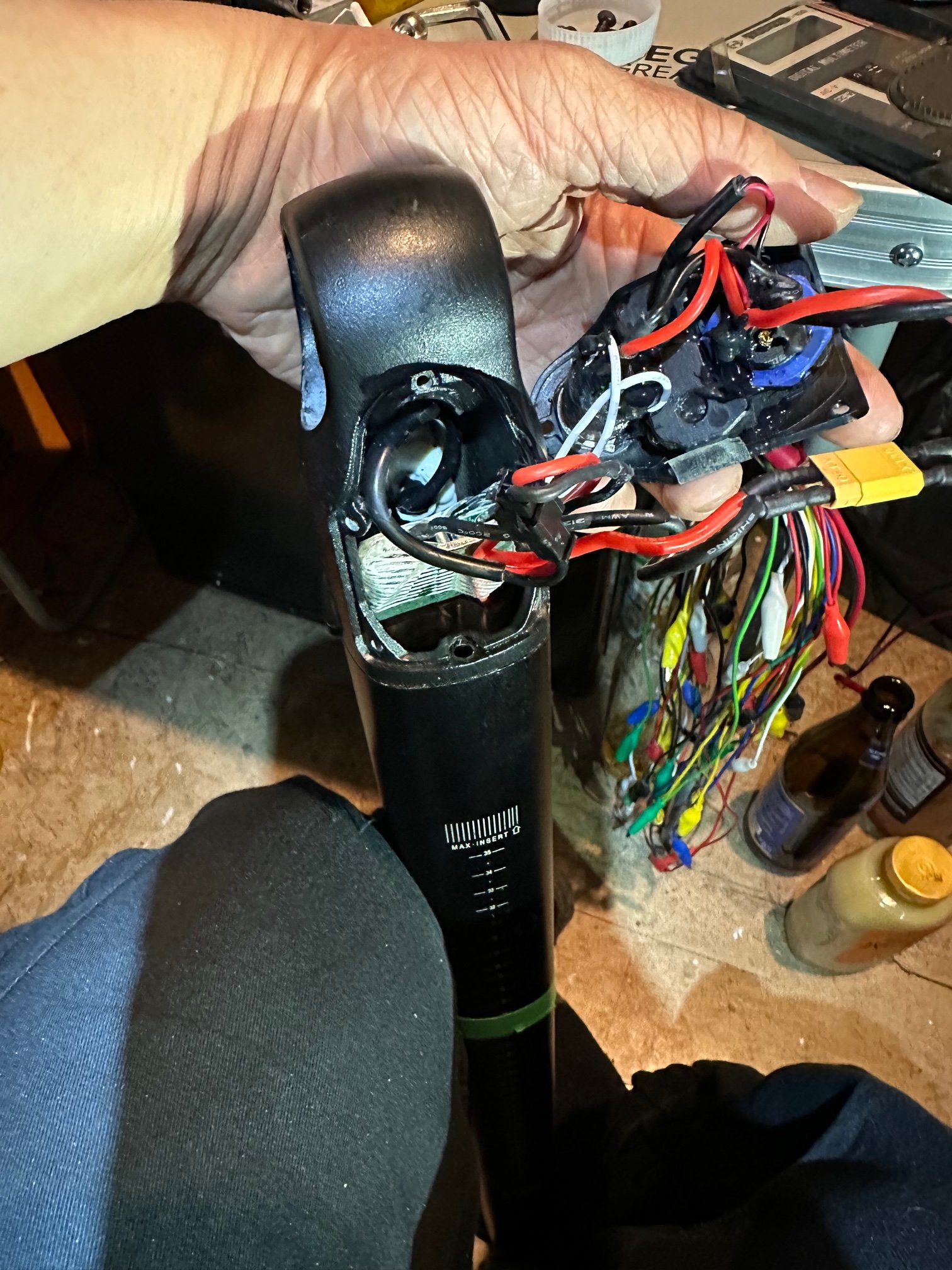

  3. We opened the cover! (total novices) Fiido says to check the fuse, and in their videos, the fuse is a very obvious blade-fuse thing on the red cable. 2 things we noticed: 1. My seatpost doesn't seem to have an obvious fuse like in their videos. The cables lead to some plastic-wrapped circuitboard. Maybe it's much deeper inside? Should we try to pop the bottom cover, or from the top? Hesitant to force/break something 2. There seems to a slight burnt smell, but I have no idea if they are like that normally. Photos attached. Grateful for advice
