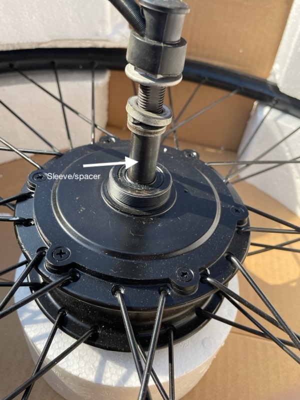

  17. hmm the description said front wheel, but that would make a lot of sense! The description when I bought it was clearly wrong, and no instructions. But thats a real newbie mistake on my part, not recognising it. Thanks, I'll go and try it on the rear!
  18. Hi I bought a "like new' ebike kit from bargainfox.com. No instructions in the book and can't find any online, looks like its a Chinese kit. This is my first attempt at an ebike kit so I am a complete newbie. I would appreciate any help and advice that you can give. The description said that its a 25" wheel with 100mm clearance between the forks. I have a Carrera Subway at the same specification. However, the spindle in the new wheel is much wider (220mm). And the sleeve or spacer prevents it fitting inside the end of the forks. See picture. I can't see how to remove that spacer/sleeve. I took all the nuts off but its in there solid. Is this normal, am I supposed to knock it out with a hammer and remove the spacer/sleeve? Thanks, Trevor
