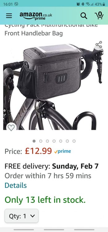

  1. Thought I would share this for a potential upgrade if you need extra battery or are having a problem with the connector later that can't be resolved. These are pictures I have found of what others are trying - This came from a facebook post in the group: Swytch Bike Chat. They use that balance/extra battery cable I posted in a previous post on this thread and stick the entire bag into a new front bag + extra battery. They cut a hole to pass the cables from the bottom of the bag and also cutaway some fabric on the top so you can see the display from the existing bag. That would be a fairly easy hack to extend battery range without doing much to the existing kit. Threading that balance wire pigtail through the existing opening in the Swytch battery bag is the only technical challenge. One could also bypass the entire cable connector harness and plug directly into the individual components like PAS, throttle, motor, etc. They are using water proof connectors inside the bag for PAS, Throttle, Brake, etc. Pictures shown earlier in the thread of these cables and ends. Most difficult part would be to map external 9 pin to an internal 9 pin cable. Perhaps someone else has already done that. I haven't researched it that far yet nor dissembled that connector harness myself to see what is the best strategy.
