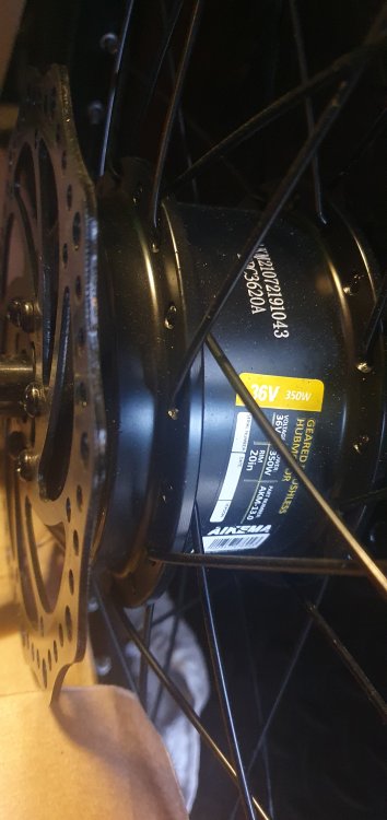

  7. On the 350w the pas setting 1 was perfect and gave just the right amount of assistance. On the 250w one I have to put on setting 3 to give any feeling of assistance. I will try the shunt method. Any recommendations on this mod? I am a fairly confident diy person. Just need a soldering iron now
  8. I originally had a 350w motor on a previous bike and the 250w on this d21 doesn't feel up to it. So would like a little extra. I thought maybe the 350w would be able to attach to the existing hall and phase wires.

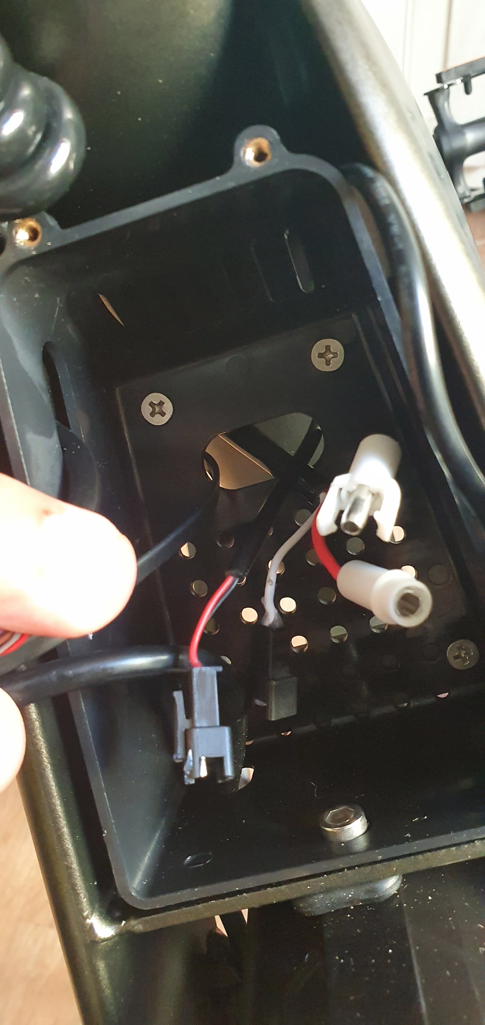

  10. Hi Thanks for the reply. From my basic knowledge I can see a 4 in to 1 cable up front where the two power off brake sensors, throttle and display go in to. Two cables come out one goes to the front light and other goes to back and splits to the two flat connectors. The black and white one goes to the rear light. I will attach some more pics.
  11. Thanks for the reply. I have taken a few more pics. So a few pics of controller and wires. Is it possible to get a 9pin adapter to connect the 350w motor to the controller and then it will work or will more need to be done? Thanks
  12. Hi new to the ebike world and I am after some advice. I currently have a 250w motor, 36v 11.1ah battery and the pictured controller. I also have a 350w motor available to upgrade to Would the controller be able to take a straight swap and give better performance? If not what would be a good controller to enabe this. TIA
