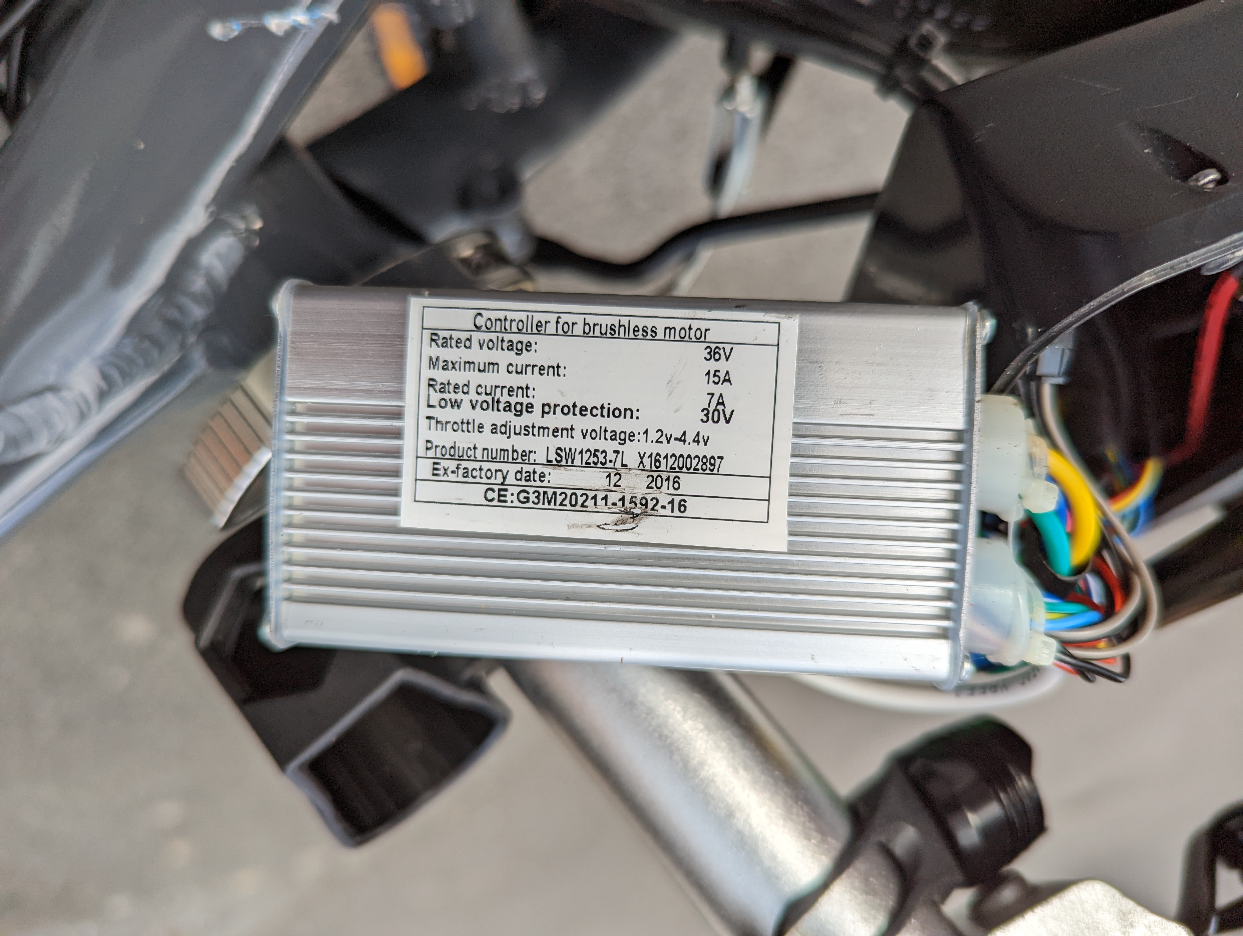

  10. This was pretty much my thinking, what I'm not sure about is whether there's anything I can do about it. Any thoughts?

  13. It does feel as though it might be dialing back the assistance early. The controller has a programming port as pictured here, apparently I can program it using something called an ST link V2, but that might be a little out of my depth since I can't find a lot of information on what software to use or how to do it. Alternatively I was wondering if a different display might work with it because I know some let you change settings in the display. The only identifying marks on the current controller are "790". Someone told me that it's a king meter but I wouldn't know how to check this. So I guess the question is, how would I know if a different display would work with this controller? Failing all that I was going to swap the controller with one that already has a display
  14. Hey all, I'm new here so apologies in advance if I break any rules. I have recently bought a 2nd hand ebike and as the title says, it won't go full speed (15.5mph) with the assistance of the motor, topping out at about 12 or 13mph (according to GPS speed on my phone). I have a 24V bike too and it's not even as fast as that, so something's definitely not right. Mechanically everything is fine. The bike is a no-thrills 36V elife voyage. I've put a multimeter across the battery and it reads 38V with about 75% charge, so I assume that's about normal. The controller is as pictured, a G3M20211-1592-16. Does anyone know what the issue could be please? Other than just replacing parts to see what fixes it, I'm all out of ideas. Thanks
