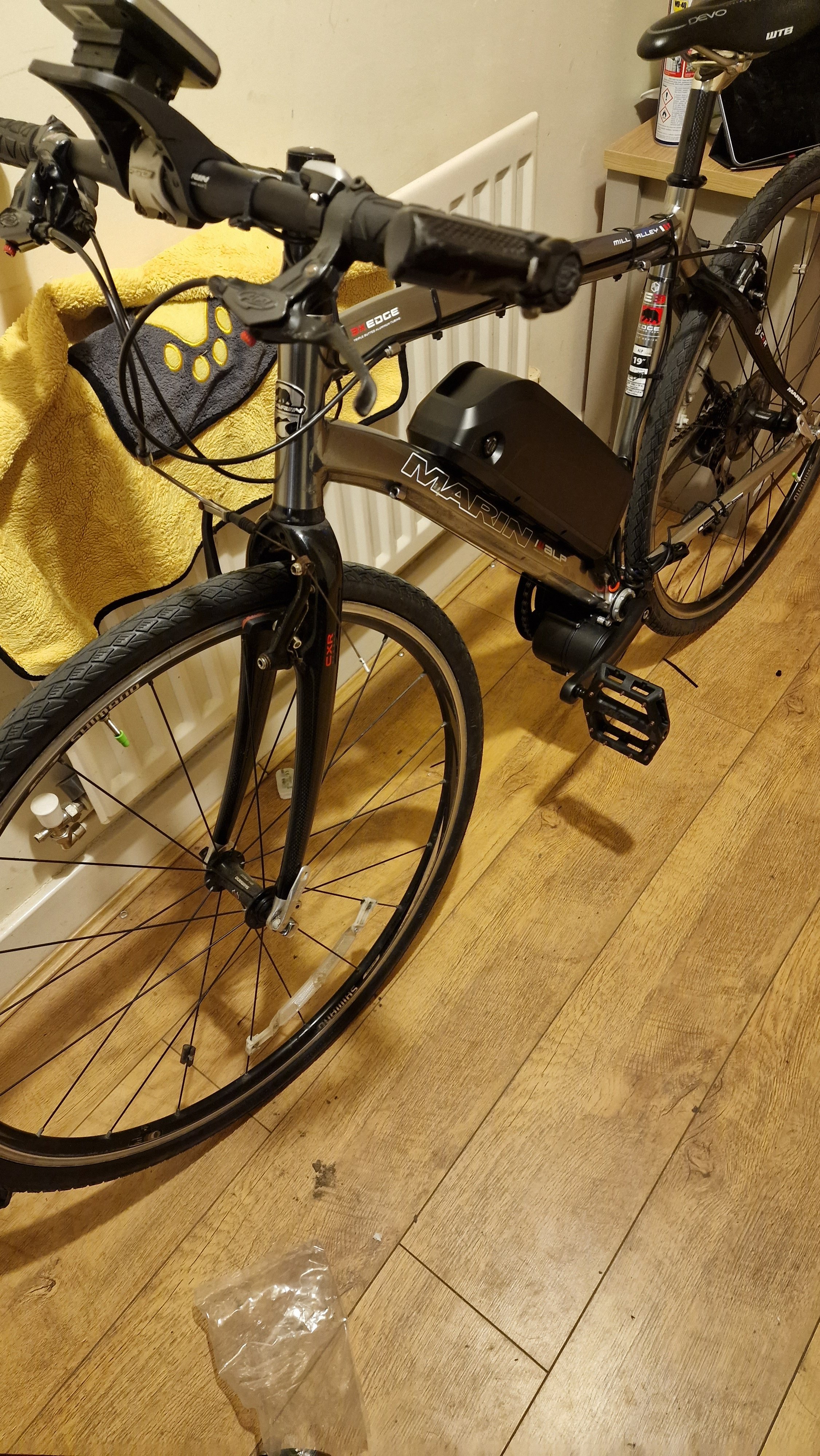

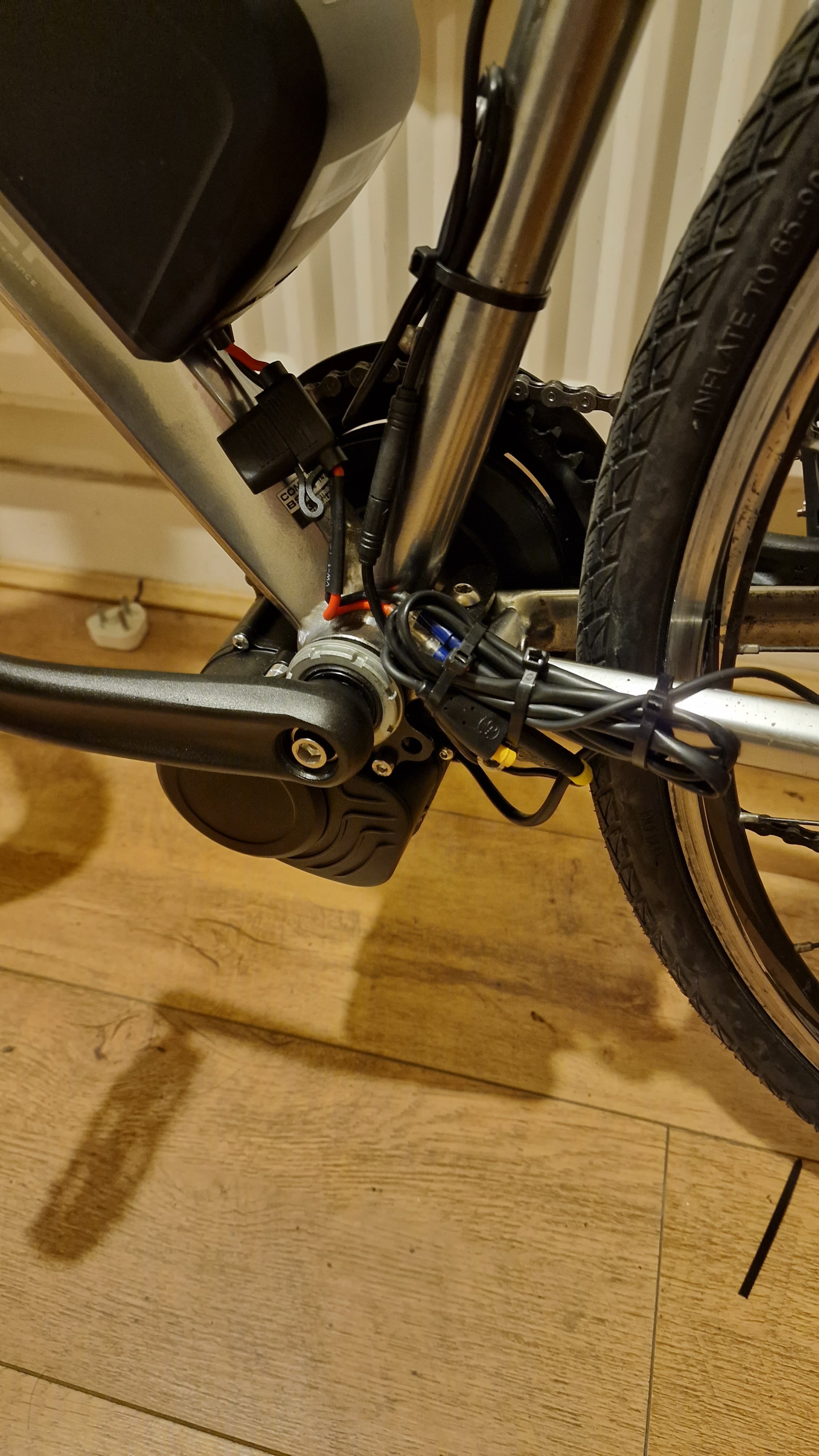

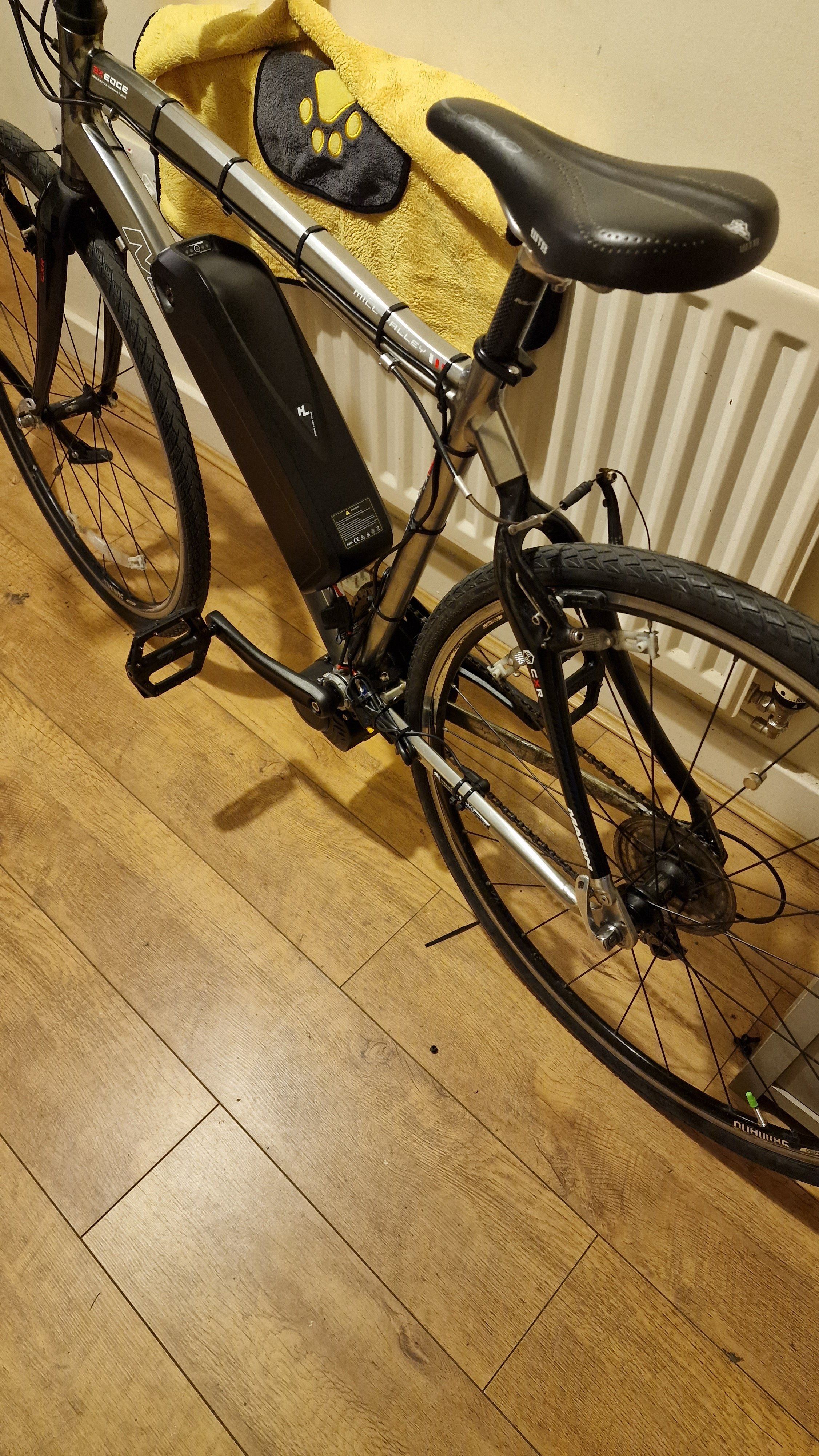

Ive just finished my conversion tonight. I had tried to convert a Whyte Mountain bike but as I was told here (but ignored and tried anyway), it had a flared bottom bracket so was never going to fit. So I dragged my old Marin hybrid out of retirement and the fit went beautifully, finished about half hour ago. ....(except fiddling with display which i need to google instructions) Just had a quick ride round the block and its bloody lovely .... except .... As soon as I stop pedalling and free wheel I get a clunk , clunk, clunk... Any idea's ? It is a brand new unit now 2km on the clock. Any help would be much appreciated. Rik

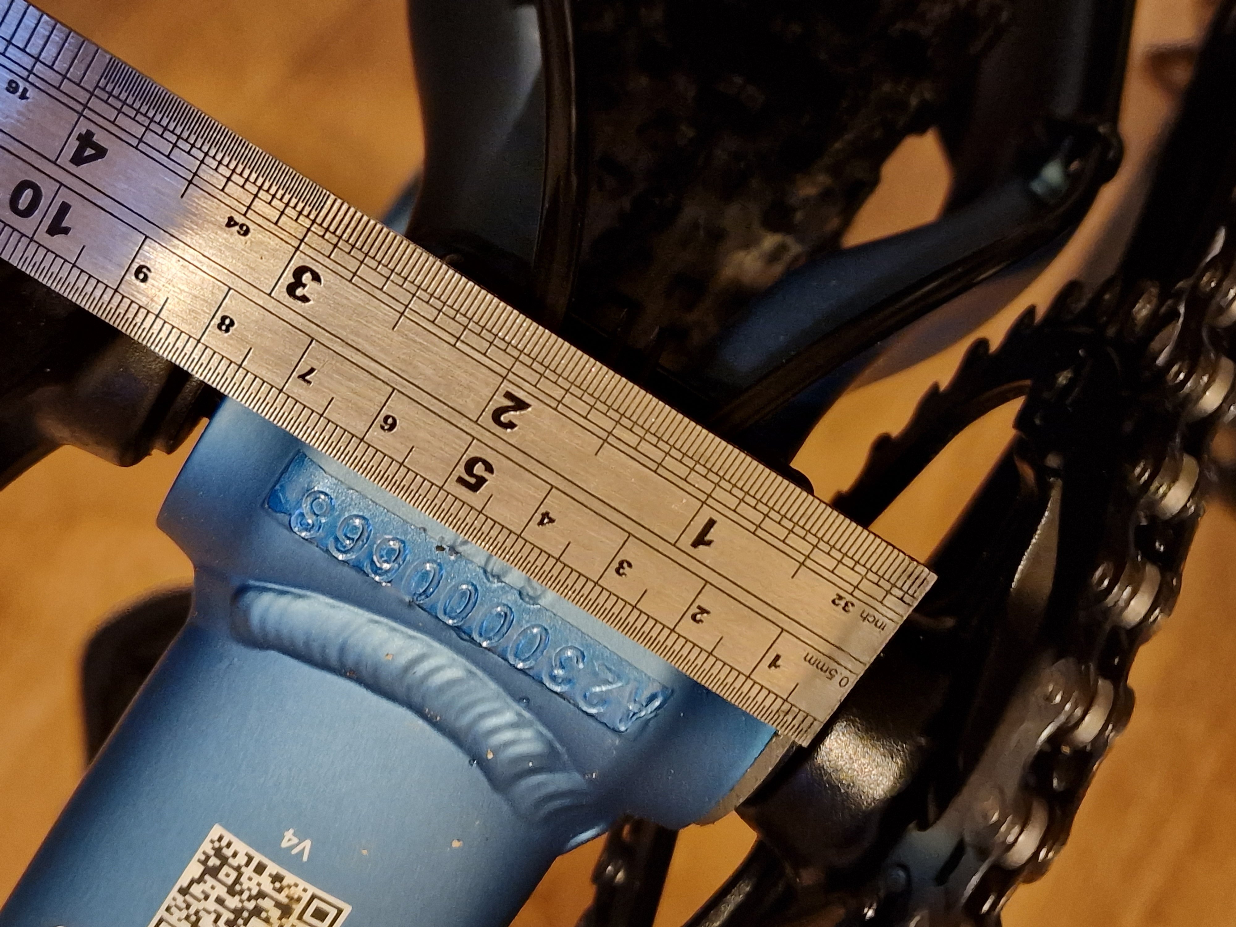

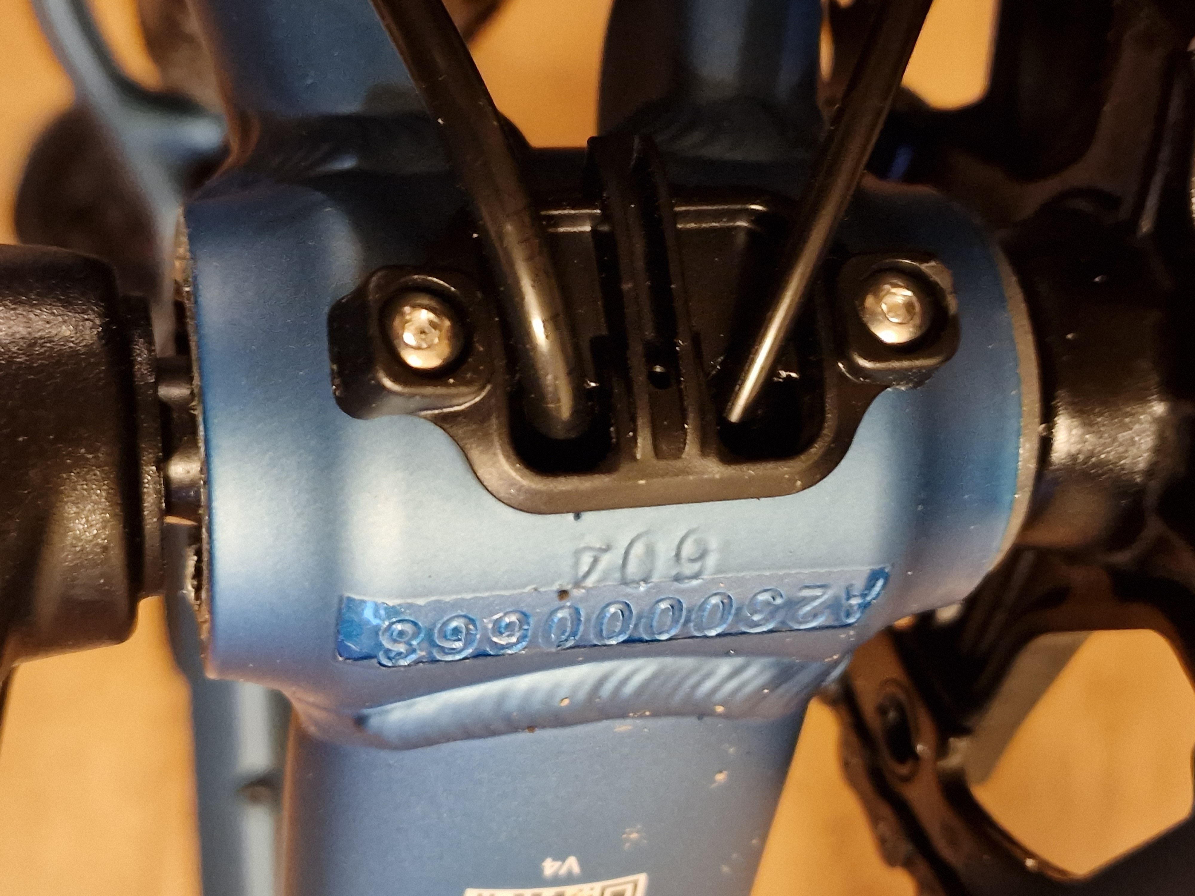

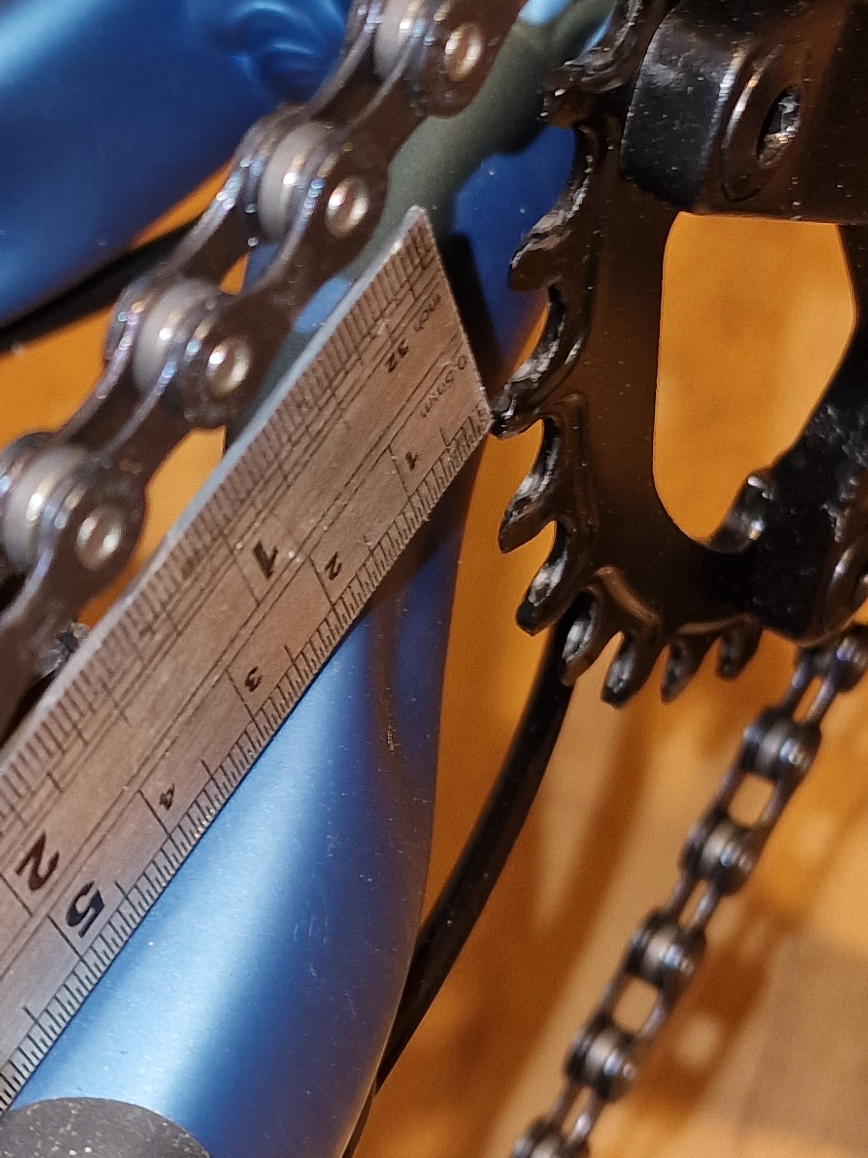

I am just about to embark on my first ebike build and need all the help I can get.... After a lot of reading I have decided the TDSZ2 seems to be the way to go. I am no longer built for my old flat bar road bike so couldn't resist a Whyte 604 compact in the sale. Before taking the plunge and orderinga kit, I have a few concerns / questions. See picture attached, there does not seem to be much clearance between the 32T crankset and frame. The Tongsheng comes with a 42T so is obviously going to be bigger but does it sit out further. I've only got about 15mm of clearance (176.5mm -136.1mm / 2) means I am going to need 21.2mm of clearance at least unless it sits out further... Am I also going to need a new chain. Full set up below. Cassette: Microshift CS-H093, 11-46, 9 Speed Chain: SunRace, 9 Speed Crankset: Prowheel, Alloy, 3pcs Cranks Single Narrow Wide, 32T I am also unsure of the legalities of the throttle version. Woosh only seem to have this version in stock at moment but I thought throttles were a no no ? Plus bike has hydraulic brakes so would need to fit sensors so more messy wires.... Finally, bike currently has nice tidy internal cable routing. It comes out under the crank. I am thinking of just removing the plastic guide underneath or would I need to reroute these two cables ? That is going to be beyond my abilities so would need to talk to our local bike shop.... A couple more pics attached. Thanks in advance, Rik
