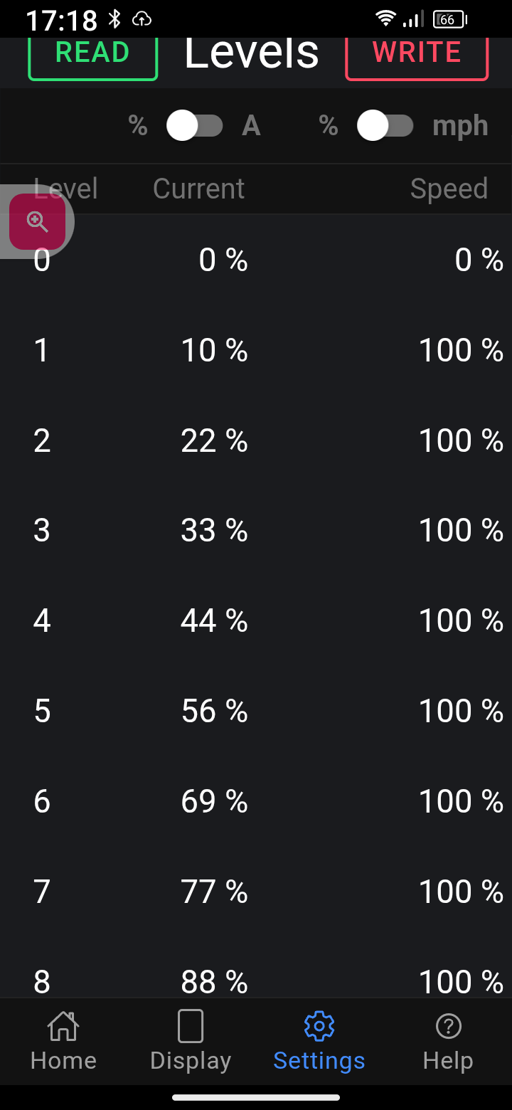

  1. no sorry dident ask he just said its not uncommen and im afraid to look as running best its ever been ,i guess the speed limits have been removed on the levels which has made it nicer . problem is i'm not good on computors so whilst ok with speeed ap talking about diferant ports ect on a computor might has well speaking double dutch .

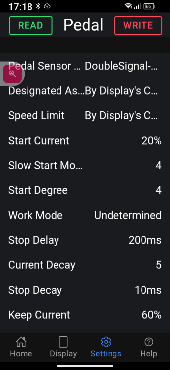

  4. hopefully /// can post screenshots of settings ,

  7. can get on tablet but wont connect to a port,possibly not available on tablet, looks a nice interface though , any way returned settings to factory and double checked to no availe, just kicks in with more power above set speed,checked all the settings now with speeed and eggrider and nothing not set properly , might see if missis will lend her laptop but not keen ,

  9. more noticable in higher settings , definatly need read a few times and print off also good idea to reset to factory settings , i have the programing tool but not got a laptop so not able to set using computor , will give it a go in the morning cheers
