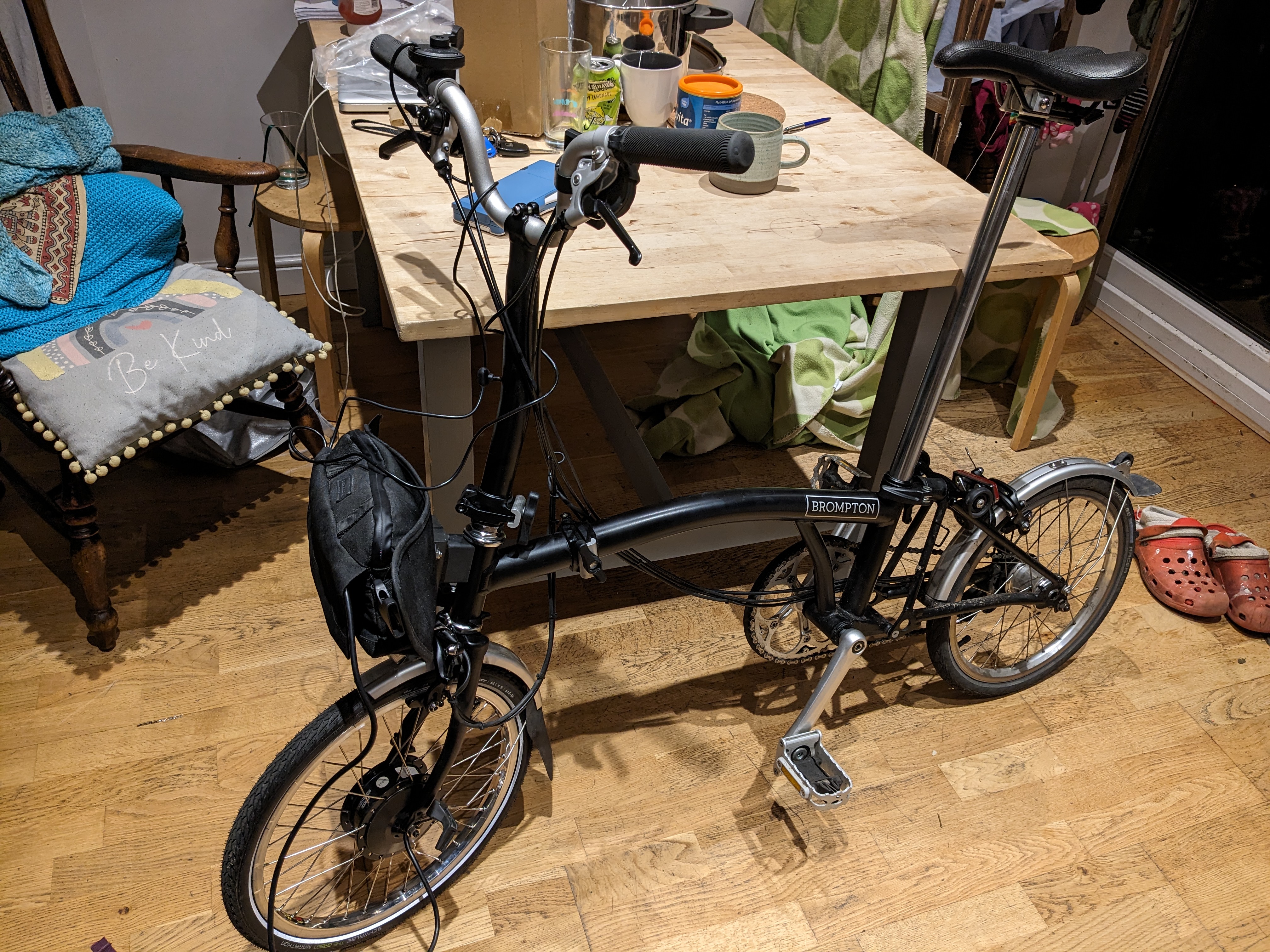

Here are some pictures Needs cables tidying still,, but you can get an idea of the spoke pattern and bending.. they are like a gentle s shape bend. 2mm diameter spokes. I can't find a rim available online that has 36 holes with angled holes. Angled ones are available for Brompton with 28 holes and it sounds like a fancy spoke pattern with different length spokes will make that ok to thread 36 hole hub onto 28 hole rim. The battery pack I'm very happy with how compact it is.. I don't know how long the juice will last in reality yet.. but it's 36v 7ah. So in theory at 250 watt it should last 1 hour. The motor is very powerful on full throttle level 5 assistance, I don't see the need for anything more and can see why that's the legal limit for a bike to be honest.. feels like your going down hill when your going up hill with just a little peddling your flying. My partner had a go and it's quite funny to watch someone on a Brompton traveling up hill that fast.
