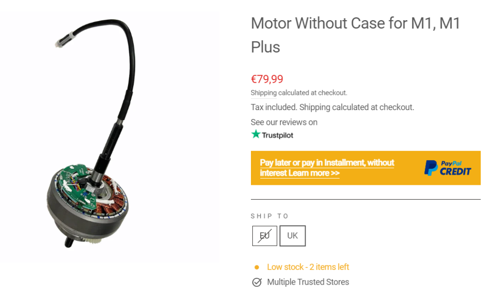

  25. These are the prices in the EU: I think especially the first one is intersting as a a spare as it i replaced within 30 minutes withou the ned to mount a new set of spokes.
