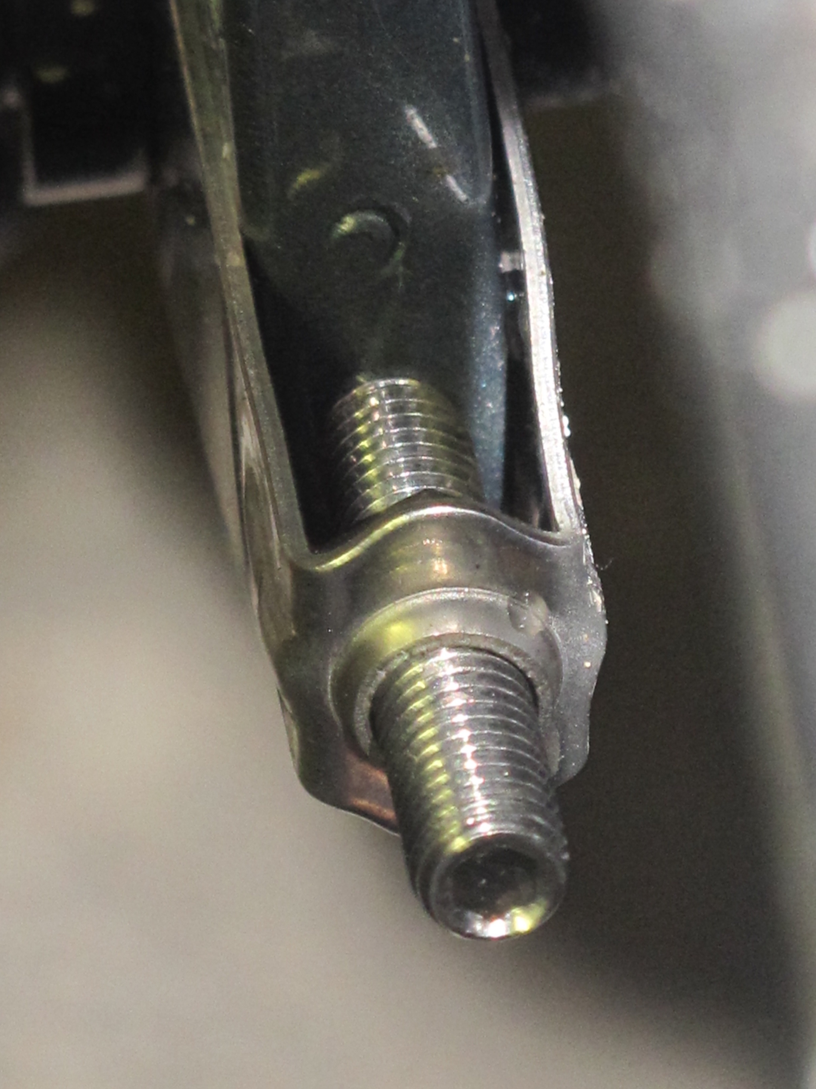

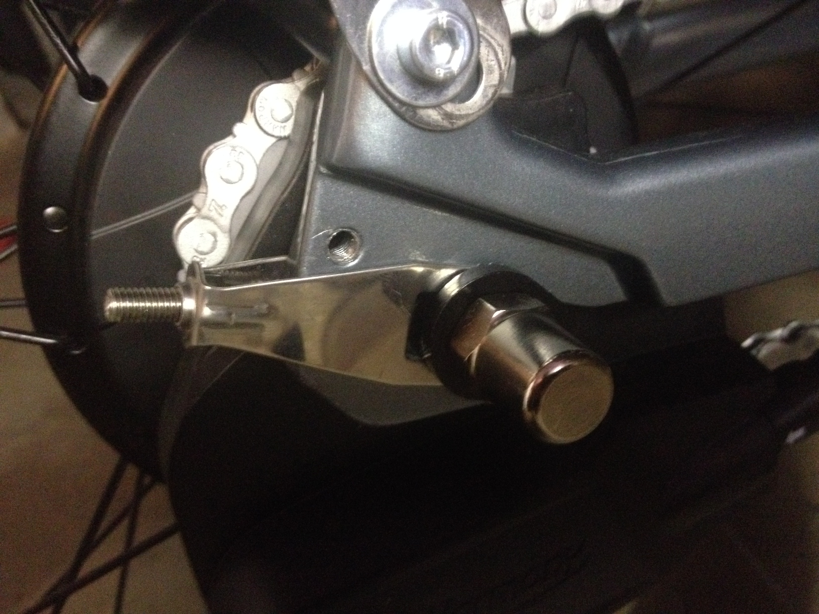

  9. @[mention=9180]JohnCade[/mention] It's the latter. There is no nut head/adjustment bolt on the bolt/screw, so none that that is tightened against the dropout to spread the load. However, the bolt is nowhere near as wide as the dropout. I'm attaching some pictures of how the bolt is contacting the dropout - on each side. You can also see the indentation for the Allen key. This issue of the bolt thickness is part of why I wondered whether the larger chain tensioners might be a better solution, as their bolts might be more substantial. However, from a quick look, all the sizes seem to use a common bolt thickness. On the issue of future adjustments, I have no experience doing this. When do you tighten the tensioners and by how much? No, I don't suppose I'd want to get the bike shop to do it every time, but I'd like to know what I'm doing, given my history of problems with Kalkhoff e-bikes. On an earlier point, yes, I agree, the P&P was extortionate (9 euros 50 as I recall) if you were only ordering something small. But you could save by ordering more.

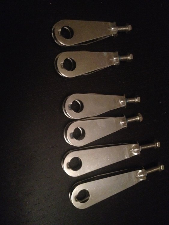

  10. @[mention=9180]JohnCade[/mention] Mystery solved! I emailed the Holland Bike Shop and described your observation. They replied thusly: "Thank you for your e-mail. This is a new model, and this is normal. You can adjust it with a hexagonal wrench on the bolt head." Which is pretty much what my bike mechanic observed when he took the part from me. By the way, the other three versions I ordered did have the adjustment bolt, as you can see from the picture.
  11. @[mention=9180]JohnCade[/mention] Okay. That's interesting. However, if you look at the picture from my earlier post on Dec. 4, when I'd just received the short Batavus chain tensioners, you can see that the bolt was shipped installed like that. My mechanic said I'd need some kind of Allen key to adjust the wheel (there is an indentation that could fit an Allen key). I didn't realise at that point because I hadn't seen the others with an adjustment bolt. But then if I go on the Holland Bike Shop site, you can see in the image there's supposed to be a adjustment bolt at the rear end of a chain tensioner. Strange. Is it even possible it was installed wrong by the manufacturer? Could the bolt even be installed backwards? Wouldn't the reversed adjustment bolt prevent proper installation? Oh well, I could always ask them to swap in one of the larger ones with an adjustment bolt head in the right place, next time I have time to spend time on this.
  12. @[mention=9180]JohnCade[/mention] Success! I got the short chain tensioners installed. They fit and now my wheel seems to run true. All good so far. The other ones arrived a couple of days later and now I have quite a collection. Two of the types sold by the HollandBikeShop.com seem to be identical: Bicycle Chain Tensioner Batavus Stainless 104484 2 € 2,25 21.00% €4,50 Batavus Chain Tensioner 45Mm Bolt 30 mm 142471 2 € 1,95 21.00% €3,90 The Batavus Chain Tensioner 62 Mm Bolt 45 mm version is clearly overkill, and pricey at €19,80 for 2. I wonder whether the larger versions might provide more strength for holding the wheel in place. Some pictures of the installation:

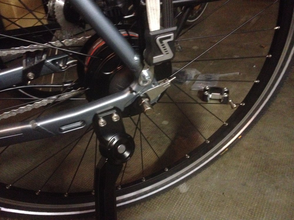

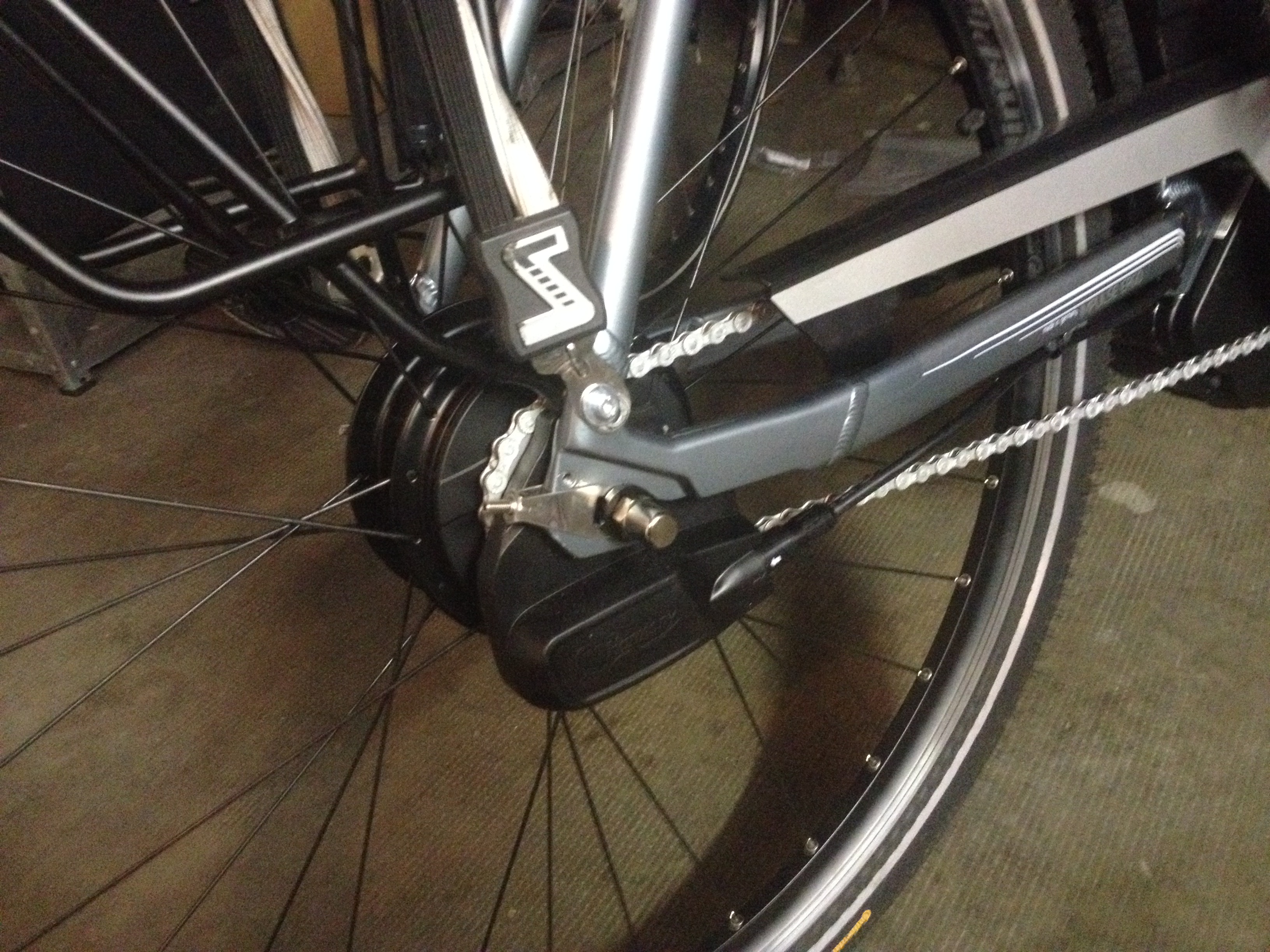

  13. @[mention=9180]JohnCade[/mention] I received the first set - the Batavus Chain Tensioner Short Stainless. I've got to tell you I can't see whether they might fit or not. I can say that the Nuvinci hub on my bike and the way the frame/dropouts are designed does not make it look easy to fit the tensioner in on the drive side. I wish someone who has fitted these things could write a bit about how they are fitted and show some pictures. Below I've posted some of mine. In picture 3 you can see me holding the chain tensioner near where I imagine it goes. The thing occupying the acrew directly behind the wheel bolt is the anchor for some cargo straps I have over my carrier rack. They used to fit differently on my previous Kalkhoff. Picture 4 gives you the lay of the land. Any comments? Thanks for the info on the new dropouts. I can't see whether mine are different, because the automatic shifting stuff covers part of the dropout. I think they are different from the 2012 Agattu, because the way the baggage carrier and any possible straps fit on is different.
  14. @[mention=9180]JohnCade[/mention] Given the delivery delay from HollandBikeShop (especially since they require a signature and I'm redirecting the package to a postal drop-off place that probably won't sign for it), and the fact that you indicated doubt about whether they'll fit, I decided to order two pairs of all four of the Batavus chain tensioners available on that online shop's site. Batavus Chain Tensioner 62 Mm Bolt 45 Mm Batavus Chain Tensioner 45Mm Bolt 30Mm Batavus Chain Tensioner Short Stainless and my latest find: Bicycle Chain Tensioner Batavus Stainless One of them ought to fit! Then I'll have a whole bunch of useless chain tensioners. But I don't want to have to take my bike to the workshop and leave it more often than I have to. Sucks to have a new bike off the road for so long. I rang up the HollandBikeShop online store and complained about the lack of detail and fitting information. She conceded the point, but said the site originated as a parts site for bicycle mechanics, and has become more end-user focussed. She told me they're well into planning a new site that will feature a lot more information. And it will be more multilingual. However, she clearly ignored my not so subtle effort to get a discount. What "later version of that pdf" are you talking about? I got the latest manual off the Kalkhoff site. There don't seem to to be any individual manuals for each type of bike. Are you saying you don't believe the "more general" torque reading list? Even though it sounds like 30 N-m would be better than 45 N-m to avoid the bolts stripped (that happened to me a lot when I tried to tighten the bolts on without a torque wrench)? Where are we supposed to get credible torque specifications for Kalkhoff bikes? I keep on thinking about getting a torque wrench, but my first Kalkhoff was such a nightmare that it's scared me off from doing my own maintenance. Does anyone here like the Park Tool TW-6 or is that just overpriced branding? I don't have access to an Aldi or anything similar. I'll probably have to order online. I didn't keep a picture of the dropouts on my earlier Kalkhoff e-bike - an Agattu XXL C8. I wish I had done so, to document what can happen to the frame/dropouts from too much abuse. I can only confirm that the dropouts face the same direction, not whether the dropouts are any beefier. I'd be interested in your source on Kalkhoff having beefed up the dropouts in the 2015 models - that's apparently what I have. Where did you see that? if anyone's interested I could upload a picture of what the rear drop-outs look like. @[mention=6825]RobF[/mention] Thanks - so that's the same company behind the Rose Versand online bike shop? Too bad they don't do electric. Thanks for taking the time to explain. @[mention=982]tillson[/mention] Thanks for that Shimano link. I looked for the equivalent for my bike, and found it: http://www.fallbrooktech.com/sites/default/files/videos/N360_TECH_ENGLISH_web.pdf They suggest the rear wheel bolts be tightened to 30-40 N-m. Interesting as it's just below the 45 N-m that @[mention=9180]JohnCade[/mention] thinks stripped his bolts.
  15. Dear all, Thanks for your replies. So that's my conclusion: the rear wheel wasn't properly installed and it moved/is moving. A visual inspection showed that the rear wheel appears to be off-centre with respect to the fender - on the right side there's a lot more tire. (That's the side opposite from the speed sensor and magnet). I can confirm that my 2015 model still has forward facing dropouts. Just like the 2012 version bike it replaces. @[mention=9180]JohnCade[/mention] I've taken your advice and ordered a pair of the short wheel tensioners from the Holland Bike Shop. I live in a hilly area and have already experienced a bike's alloy dropouts/frame wearing out because of constant wheel movement/reinstallation and adjustment. I honestly don't know why Kalkhoff doesn't offer its own brand. t hope you're right that the short ones will fit. I see there are three variations (Batavus Chain Tensioner 62 Mm Bolt 45 Mm; Batavus Chain Tensioner 45Mm Bolt 30Mm and the Batavus Chain Tensioner Short Stainless, which the site says are made of iron.) I ordered the third kind. My bike is staying off the road until these parts arrive and are installed (to avoid multiple long trips to the bike shop). A bike shop installed a pair on my then-soon-to-be defunct Kalkhoff Agattu, so I know something like this can be fitted. You noted how this problem (the wheel moving, the stripped bolts) seemed to start when Kalkhoff moved from a Panasonic motor to their Impulse unit. Well, imagine the effect of the even-more powerful Impulse 2.0 motor. On the subject of torque values and torque wrenches, Kalkhoff does make the torque values available in its 2012 manual, downloadable from their site at: http://manuals.derby-cycle.com/manuals/kalkhoff/en_kalkhoff_2012_20140818_09.pdf, on page 64. The rear axle nuts are to be tightened to 30 N-m and the front ones to 25. 30 equates to 22.126864479 foot-pounds, so even less tight than you now have it. However, I don't think the bike workshop at the store where I bought my bike even uses a torque wrench. One more thing: how on earth do you "recut the non-rotation washer"? @[mention=6825]RobF[/mention] What's a Rose frame? That rear dropout looks pretty cool. @[mention=982]tillson[/mention] Thanks for your analysis. I've relayed your recommendation on how to install the wheel without fighting the tension. We'll see if that gets it right. Once more, thanks to everyone who replied.

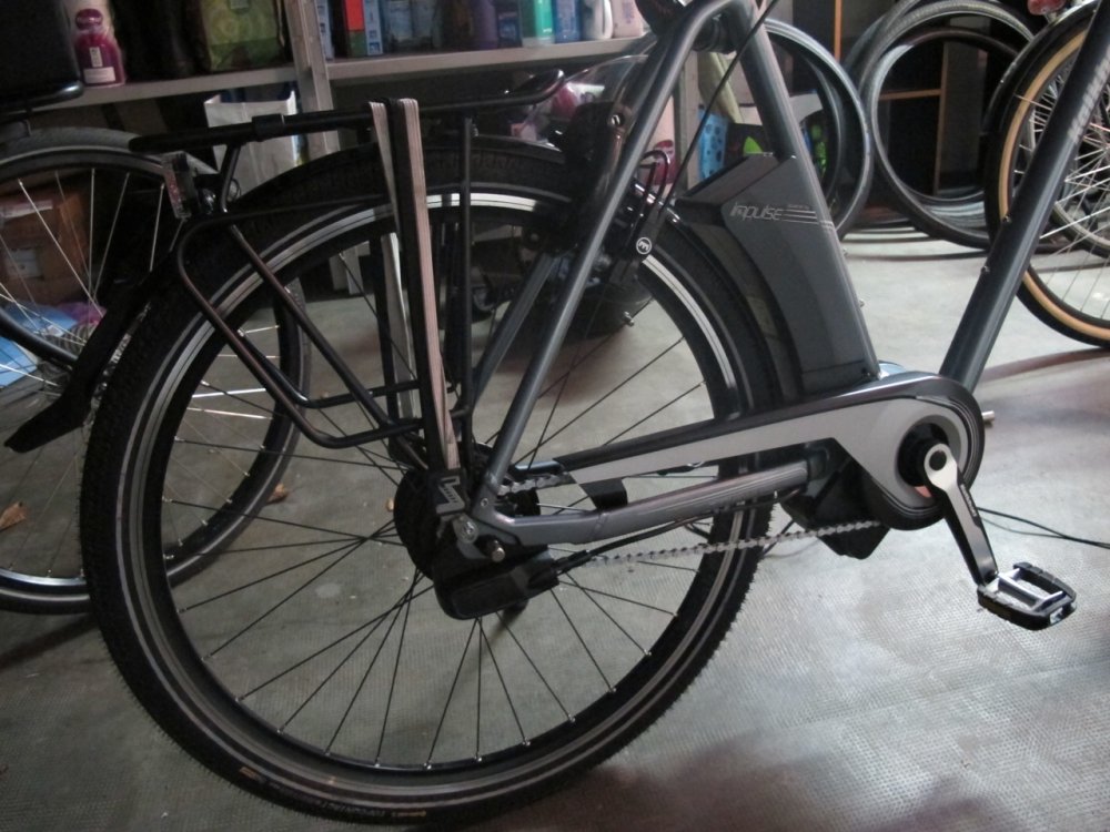

  16. Hi all. I just picked up my new Kalkhoff Impulse Ergo XXL. I had some problems with it right away: the magnet mounted on a rear wheel spoke is hitting the speed sensor placed on the frame next to the rear wheel. I took the bike right back for an adjustment. It seemed to be fixed in a short test in the parking lot. But soon after resuming my trip home I heard that "thunk thunk thunk" from the rear wheel. The problem seems to become particularly obvious at higher speed and after I've been cycling for more than a few minutes. However, once I start hearing the noises, it doesn't go away until I stop. I have checked and when I look at the clearance between the sensor and the magnet, it seems there's a sufficient gap that there should be no contact. But there is, unless something else is causing the noise. (I didn't have time to go back for a second time today, as the mechanic had left.) This is not the first time I've had a Kalkhoff bike. The Impulse Ergo is a replacement for an earlier 2012 Kalkhoff Agattu XXL which was declared not usable by my retailer's mechanic. The fatal issue was that the area of the frame where the rear wheel is secured had worn down, making it impossible to lock the wheel in place. This was said to be caused by having taken the rear wheel off and putting it back on too many times. One of the earliest problems I had with that bike was this same issue of the spoke magnet hitting the speed sensor. From my experience, there are a couple of issues involved with this particular problem. There's the issue of the wheel being properly centred, then there's the question of whether the speed sensor is close enough to the spokes (or too close) - with some spacers that can be removed under the sensor. There is another problem if the magnet is too far from the sensor - the motor assistance level drops to a low level and the handlebar controls flash. I learned all this from my experience with the Agattu. To any of you who say this is an easy fix, I should say that I've concluded that I am not able to properly install the rear wheel on Kalkhoff bikes, as I can't seem to centre the wheel, ensure sufficient chain tension, keep clear of the sensor and tighten the wheel all at the same time. (Especially as the wheel bolts tend to get stripped if over-tightened. I don't have a torque wrench, nor do I know the correct tightening specifications for the bike's bolts.) I don't know why I keep on having this problem with Kalkhoff bikes. I also don't want to do anything that might damage the bike. Can anyone give me some tips on how this should be handled? Why would the spoke magnet only start hitting the sensor only at higher speeds and after a certain amount of time? I look forward to any input. Mike
