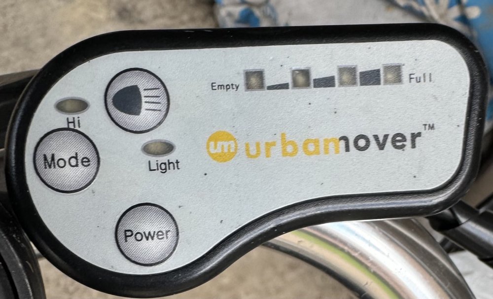

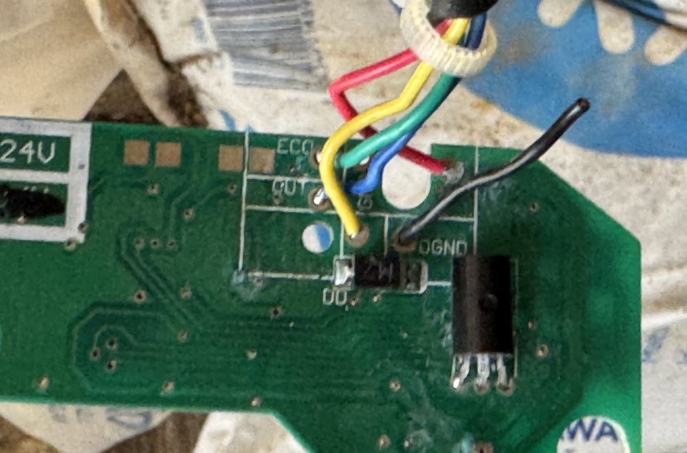

  3. I am a retired power generation engineer, who still occasionally finds himself doing STEM (science tech engg maths) business, albeit on a voluntary, informal or part-time basis. My research background often takes me back to fundamental principles in most things I do, while most other people would probably not bother with such an approach! I came across Pedelecs purely by accident while surfing. I have been using electric bikes since 2008. My main interest in joining is to keep my existing URBANMOVER UM55 Cruiser on the road electrically, rather than using it as a pedal bicycle, which is what I have been doing for the last few weeks. I may become a customer of another e-Bike in the future. My dream e-bike is a Full Throttle, step-over or folding and rear motor one. However, I would only buy it, if the battery could be renewed, or replaced, at a reasonable cost. Further, detailed information including circuit diagrams of any pcd's and control units must be available, and all essential spares that are prone to wear off in a few years must still be available for at least ten years after purchase.
