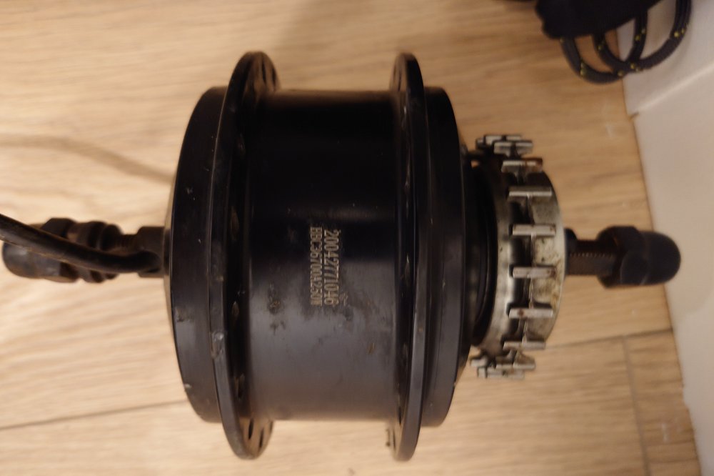

  1. Finally found out what's up with it , it's a custom shell ( not confirmed by anyone just got a spec sheet from a dealer over at Lishui ) of AKM100SX(R2/RC2) so not the wavy model from Tongsheng-e.com . I've been informed i can buy spare nylon gears if i please to do so however i can't seem to get prices from this contact

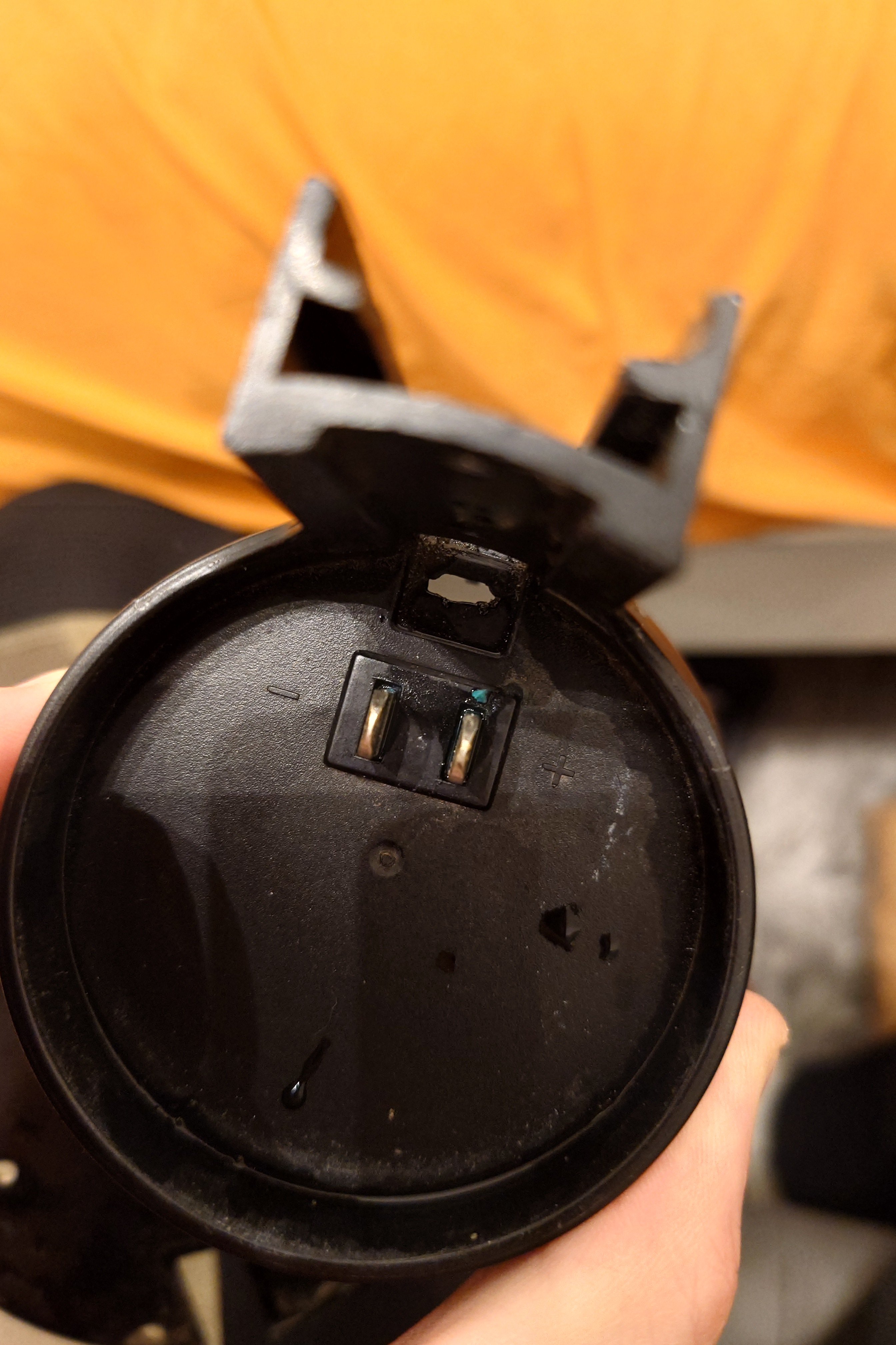

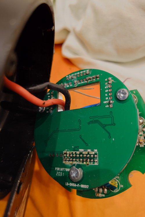

  3. £32 wasted and the shipping fee of £22 or £25 . I ve found my old controller with the munched up accesory loom connector which it has an externally attached soldered wire to make it work , the motor is behaving normally now with this . Lishui hq is somewhat weird to deal with , since i got like a prototype with this weird hole instead of being covered and also without the guide rail and holding strap for the battery , it wasn't even potted / silicone waterproofed against water ingress i guess as the old one is bomb proof , i did open it to have look .. think Analog Motion done the work for the factory for sure at their London HQ . Anyways, the lady at Lishui said the shell is about to be EOL so will likely move to KT , maybe a dual motor config since i do Deliveroo and do grocery orders time to time , any advantages to these 48v controllers or should i stick with 36 .
  4. It's a Lishui LSW1488-34-4F , bottle style controller and is potted however i think the lady from Lishui got me the last piece they have made as i have recently got in touch again to make sure i secure an additional one as a spare and i got told the casing is almost EOL ( end of life ) . This particular one has the water drainage hole at the back uncovered , i did not see this unit before hand all she wanted to know is my old label from the controller which btw i could plug in later one if i can find it . That one cable which connects the accesory loom is a bit damage which i've resoldered , it still works and i will def test with it . Can't tell if it's sensored , basically it's silent not loud like the kits kids buy these days and terrorize the civic centres . It has a 9pin connector
  5. I need to know if it's geared ( nylon wheels ) cause i used my bike with a throttle for a while and although i m just 56kg i believe the motor did not like it that much on the uphills , after not even 200 meter the hub sounds like it's got loose bearings of some sorts but will be absolutely silent when pulling the throttle from a standstill non loaded and of course after i have not ridden it at all . The one pictured is just the old one which i've replaced just because i found a whole wheel with the very same model via Ebay and the rim and it's nipples were busted anyways . I'm planning to have it on my little brother's Orbea MX20 and now that a problem has occured on my main bike it would be wise for me to know what happened and if i can rely on these motors anymore before spending £65 with SJS cycles for a wheel build

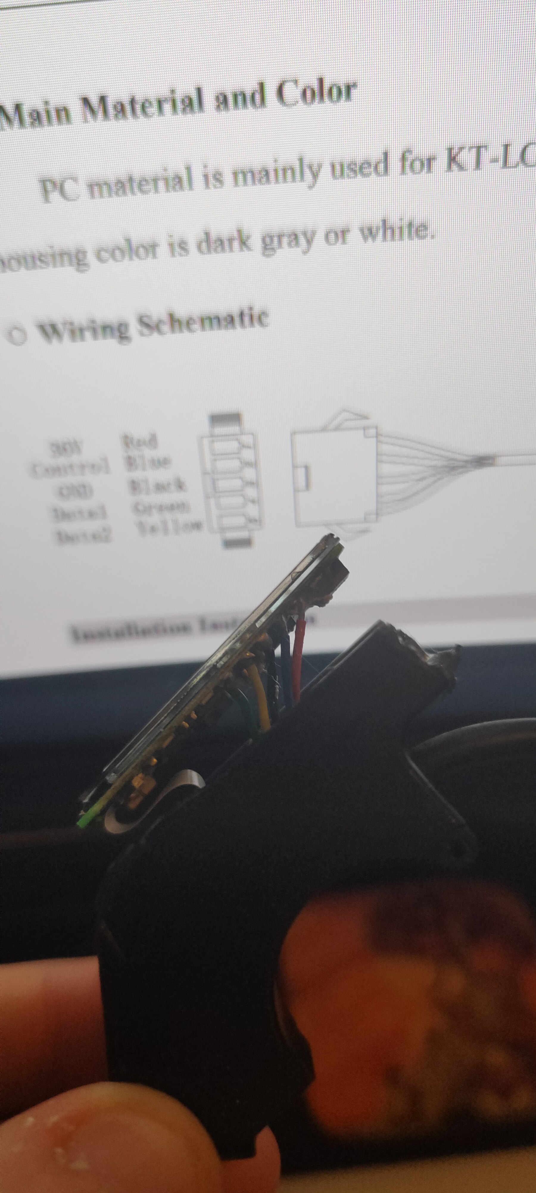

  7. Hi there , anybody able to identify this for me , i've looked at AKM but can't seem to identify it on the website . support is useless
  8. is it a big deal , should i take the controller to a tv repair shop or somewhere else with good soldering skills etc ?
