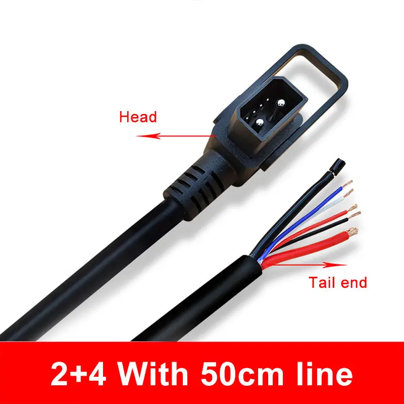

  2. Yes the lead is in there, I just meant, can I just cut it off and wire it into a xt60
  3. Thank you for the replies. It seems the bike uses an unusual connector. The only references I find online are that it is a 2+4 connector, with the 4 pins for data/signal and the 2 for the power. I assume I can cut off that plug and wire the power lines directly into xt60 plug for better compatibility with commonly available batteries (following recommendations you've given)?
  4. Hi all, I have an eskuta sx-250 series 3, as it was the most comfortable ebike for my bad back. Unfortunately the battery was stolen, it's stored under the seat and the lock is easily jimmied. I was wondering if anyone knows about these battery packs and if they can easily be replaced with a generic 48V 26Ah battery off Amazon. The only issue I see is the connector which seems to be a proprietary 2 pin square. There is plenty of space under the seat and I'd prefer a low capacity smaller battery that I could take away with me next time.
