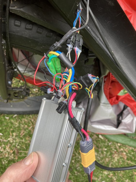

  3. Many thanks, Antony. So the Bafang motor itself does not mean that some specialised controller using a particular communication protocol is required (in my research I have come across controllers specifically labelled “ Bafang controller” ) it’s just the connectors I have to look out for?
