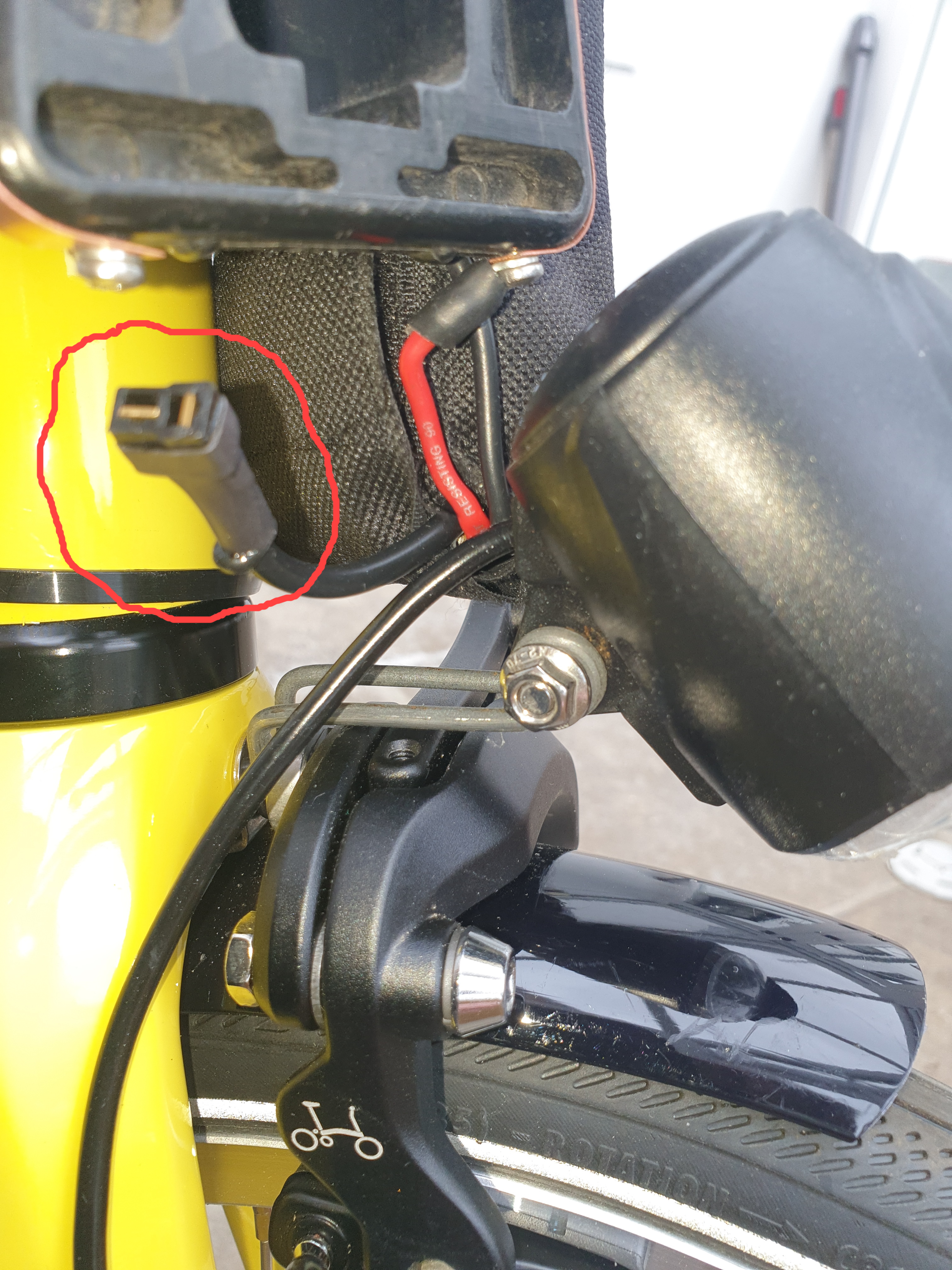

  2. Many thanks for the informtion and the suggested possible solution for the 03 error. For the latter I am very pleased to say that you were spot on. The cable to the motor looked as if it was tight but a serious push took it a little further. The motor now performs, albeit under no load conditions. When we get a bit of fine weather (tomorrow) I will take it for a proper test. I see what you mean about Dean connectors being all over the place. I think I will need some serious homework to find the best variant for the job. Thanks again for the suggestions and the repair offer. Most appreciated.
  3. Good Day Pedalelecers I am one of the many wrinkly Boomers residing in Aberystwyth in western Cymru (Wales). As most of you will know Cymru is a land of Dragons and Hills so my 20 year old 6 speed a la cart Brompton has been struggling. It seemed sensible, therefore, to splash some of the Kids Inheritance (there being no kids) and get a 12 speed T Line. That has been painted and then Tony Castles of Nano fame added power assist. The result is a nice ride that is unfazed by all the hills, if a little hard on the bum (100 psi tyre pressure). However, I have two problems to solve. Firstly, Tony never got around to finish off the fitting of the running lights. He has left a socket for me to connect into, but I do not recognise it nor do Iknow where to suitable connectors. If anybody recognises I would be grateful if you could explain. (See photo). Happily I can cope with the wiring. My second problem is that the machine has just died on me with the error message 03 - Motor Hall Sensor. Now I happen to know that Tony C is currently overwhelmed with running Nano on his own given that, like me, he is also a wrinkly Boomer but also disabled. I am sure that he would fix the bike in the end but I am looking for results soon. So my second question is whether anybody can recommend a competent e-bike shop that could fix the problem that is within a reasonable distance. Aberystwyth to Shrewsbury is 2.5 hrs, while Swansea is half a day and similarly Bangor. I look forward to your advice. Regards Pete
  4. Good Day Pedalelecers I am am one of the many wrinkly Boomers residing in Aberystwyth on the west coat of Cymru (Wales). Cymru is, of course a land of Dragons and hills which makes for interesting cycling. My 20 year old 6 speed a la cart Brompton just cannot cope with the gradients here so I decided to splash the Kids Inheritance on a T line 12 speed (given that there are no kids!). Additionally I have had it painted and had Tony Castles, of Nano fame, add electic power assist. The result has been very pleasing and with a couple of custom addition this should be exactly the right bike for a person like me living here. However there are a couple of Problems. Firstly Tony never got around to finishing the fitting of the running lights and secondly the motor system has just failed with the error code 03. That is "Motor Hall Sensor Error". Unfortunately Tony C, who is also a disabled wrinkly Boomer, is sinking uder the weight of running Nano on his own. His ususal support team have gone off to France for the summer! Thus any chance of speedy assistance from that quarter is probably zero. Fitting the lights is not really an issue for me, but I am seeking a connector to mate with the socket that Tony has provided. Does anybody recognise it and know where I can get connectors? (See picture below) My second question is whether anybody knows of a competent electric bike shop that could fix the 03 error for me, bearing in mind that that Aberystwyth is 2.5 hours drive from Shrewsbury, for example and hald a day from Swansea. Many thanks. Pete
