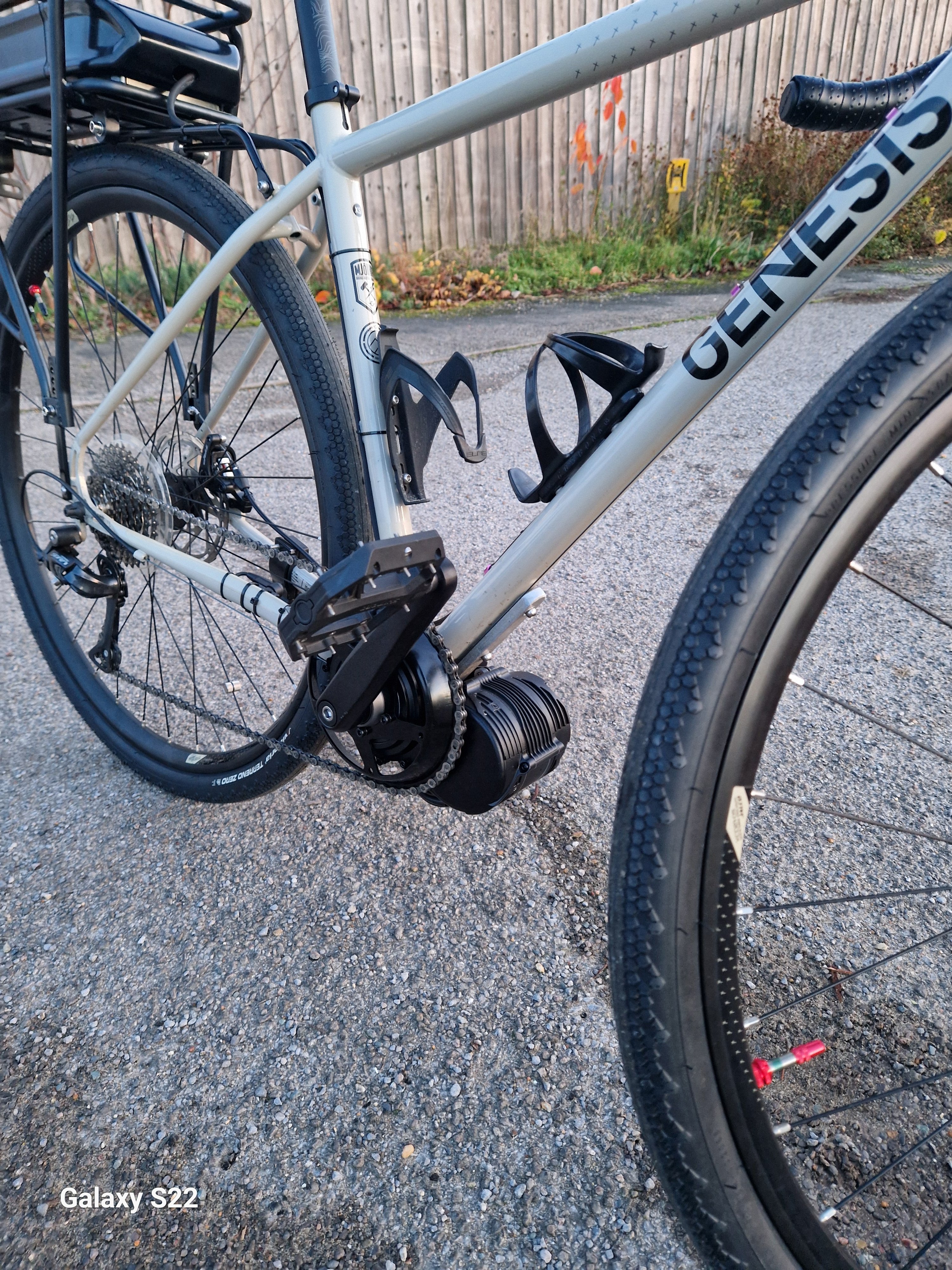

  12. Does any know of a chainring with a bigger offset than the standard 20mm that you get with the tongsheng tsdz8. As you can see on photo my chain line is way out. It just pulls the chain off the inside
  13. Hi all ive just finished my conversation on my Genesis croix de fer. Took it around the block what a piece of kit. I was sooo surprised by the assistance. I only had it on ECO mode and it truly felt like I had Bionic legs. So impressed. Here are some pics
