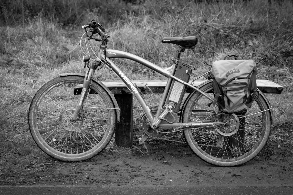

  3. Hello David, Yes I use the bike regularly for the daily commute, and at work its parked up outside in the elements. I think this has happened because the cable exit to the brake is pointing upwards and the cable has a dip in it, so when it rains water gets in but can't drain out, so despite regular oiling it still rusts. I'll get it all sorted this weekend, and get it back on the road. I'm half thinking of fitting hydraulic brakes, like those on the current model. Obviously as the brake levers have switches in them I'll be needing Wisper parts. How much would it cost me for the parts (not labour) to replace the brakes? Karl.
  4. That's good, and the existing sleeve is 150cm, so it'll cut to fit. Cheap as chips too. I was thinking of getting a stainless steel cable, which won't rot http://www.edinburghbicycle.com/products/fibrax-stainless-steel-brake-wire Karl.
  5. Hello, A year and a bit later with the sicking getting progressively worse, I finally got off my idle backside and investigated properly. Took the cable out and came across this: http://farm4.staticflickr.com/3825/11950577535_18426d2e13.jpg As the cable exit hole to the rear brake points upwards it looks to me that water had gotten in, accumulated at lowest point and rotted the cable. So I've now cleaned the sleeving with soapy water, loads of WD-40 and can of bike oil that contains PTFE and just need to get a new cable this weekend. Karl.

  12. This isn't moisture. The bike had been indoors for three days before, and it wasn't raining.
  13. Hello, With the recent cold weather the rear brake on my Wisper 905 SEL keeps freezing, the lever becomes locked solid and the brake won't engage. Its the early version of the bike with the cable brakes. The brake itself is OK and the lever the cable attaches to moves as expected. It seems to me that there is some oil in the brake sleeve that is solidifying in the cold. As soon as I get the bike somewhere warm the cable frees up and the brake works. Any suggestions on how to fix this, clean the cable, without having to remove the cable or sleeving from the bike? Karl.
