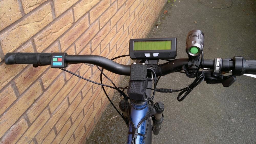

  2. [ATTACH]6368.vB[/ATTACH][ATTACH]6369.vB[/ATTACH] [ATTACH]6370.vB[/ATTACH][ATTACH]6371.vB[/ATTACH] Hi all, Well thanks for all the replies, my route to work is very open rolling country side with plenty of view of the road ahead, you are right about the stopping distances, you need to think ahead and start planning to stop way before you need to, I also find it helpful to assume every driver out there hasnt seen me and wants to try and knock me off my bike and then ride to avoid them, so far so good, its a trick I learned as a long serving motorcycle rider. Oh I use regen braking on the back, its stops me seriously fast but is way too agressive for most applications so I only use it when I need to. Anyway heres some pics of the bike. Q

  4. Ok photos to follow but specs for the moment are: Standard GT chucker MTB Crystalyte HS3540 rear hub motor 72v 100A capable Lyen controller 48v (58.4v) lifepo4 16s headway cells (In a rear motorcycle box for the moment) Cruise control, cycle analyst, twist throttle Max speed so far 37mph, 30mph on flat, 20mph general cruise speed to prolong battery life/range It makes for a very enjoyable little electric cruiser, increasing battery voltage will allow me to increase my cruising speed to around 30mph with a bit of luck.
