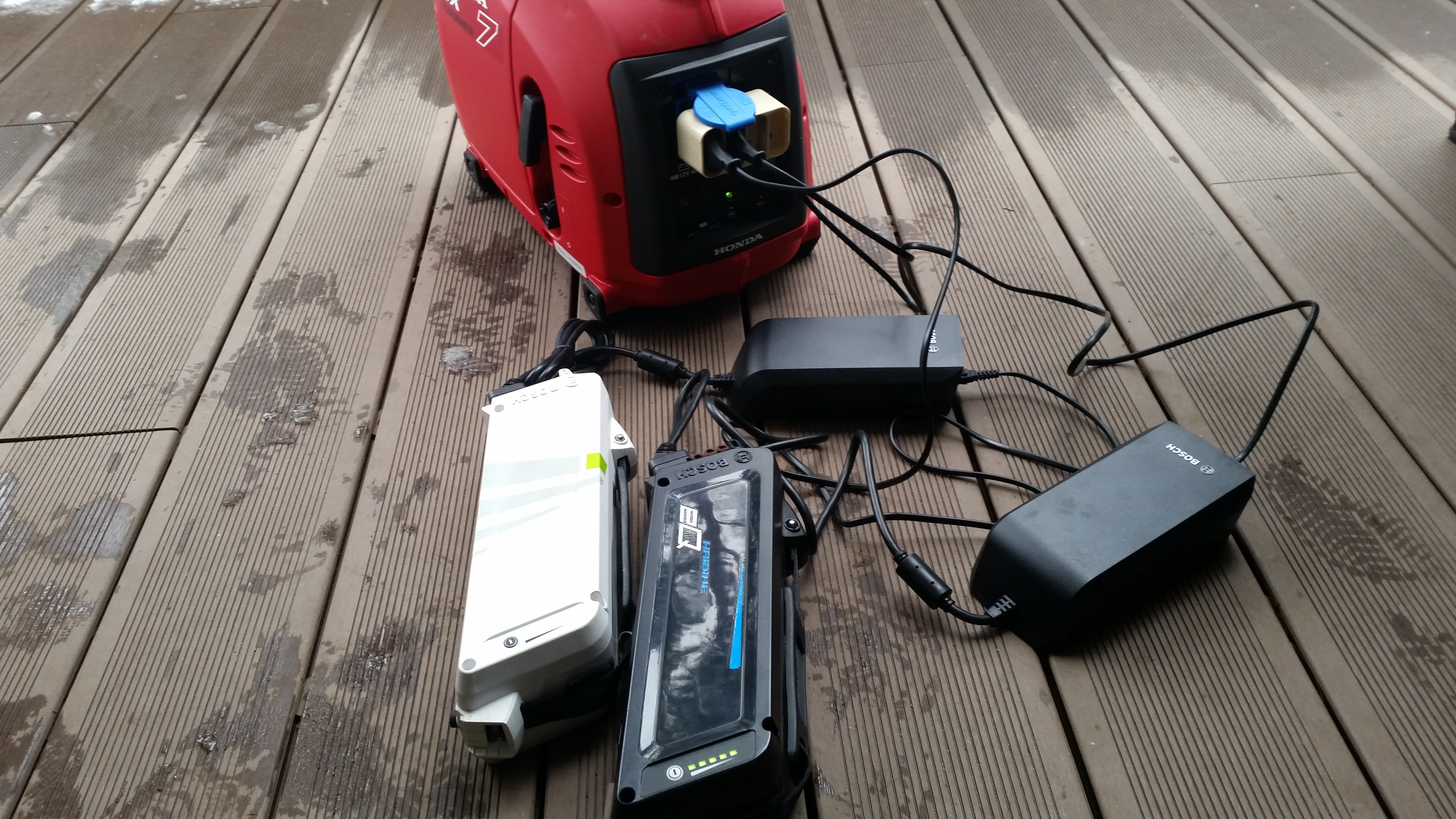

Done testing overload issue - 1.started the generator (Honda EX7) 2. connected charger nr 1 and there was tiny drop in rpm sound 3. connected charger nr 2 - no change in rpm 4. Both chargers are working, generator is stable and no overload signal is presented. I would say Honda EX7 is one of the smallest and quiet gens on the market 12kg and 83db Next ill see what happens if 3rd charger is connected.
Using a lightweight generator to charge Bosch e-bike battery
I tried to research this subject 1 year ago and ended up with small honda eu10 generator (83db) as an answer to long ebike run. Until recently I didn't have to much time to play with it but Today ill put it to the test and check if its capable of charging 2 Bosch 400 powerpacks at the same time (with 2 chargers).
