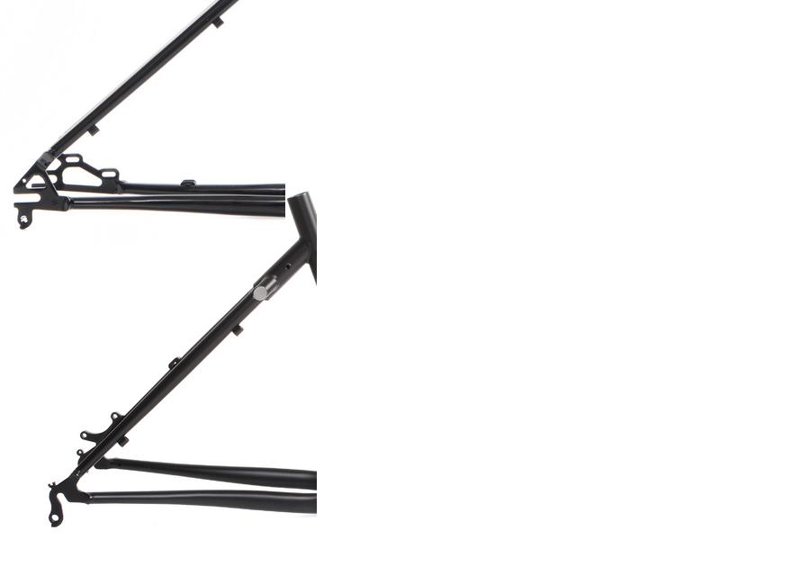

  13. torque and drop outs could anyone advise the best type of dropout for the rear cst motor if i was to change my frame, [ATTACH]7238.vB[/ATTACH] my current frame has verticle drops and i'm looking at replacing with either of the 2 in the picture, the horizontal slide in dropouts seem better to me with regards to torque if the wheel was to slip and easier to adjust, is that correct! thanks
