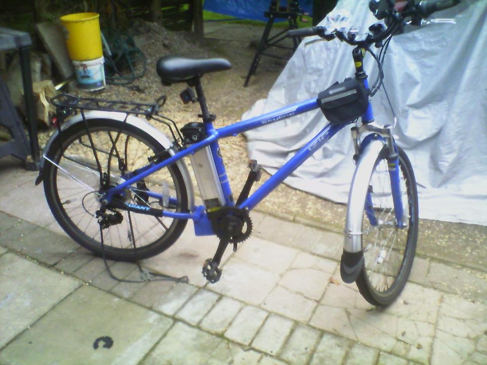

  8. pictures of pas sensor fo izip skyline bike Hi All Pictures of bike and mangled sensor.[ATTACH]4191.vB[/ATTACH][ATTACH]4192.vB[/ATTACH]I did not pay attention when magnate disintegrated and don,t know if there were magnates in every square as you can see there are holes on 2 radias an outer one at the max of the radias and another slightly more back from the max of the radias. Thanks to b8veh for his support,the sensor is still intact it is only the magnates that are mangled.i have a 5 magnate disc which i origanaly ordered only to find it did not work,i used the new magnate with the old sensor which may have been a mistake. REGARDS
  9. [ATTACH]4189.vB[/ATTACH][ATTACH]4190.vB[/ATTACH] Hi All Thanks for the replies it has been a great help don,t know if i have attached picture correctly.Have been in touch with shop in notts that someone suggested and they have been very helpfull,but they have warned me that support for this bike is dwindeling albeit that they still sell the bike,he is going to look at bike in salesroom and try to identify the pas sensor.The ones that have been sent to me are 5 magnets and the one i need seems to be 10.the magnets seem not to be in line it seems there are 5 on outer and 5 on inner radias.if the pictures turn out you will see what i mean. Thanks
