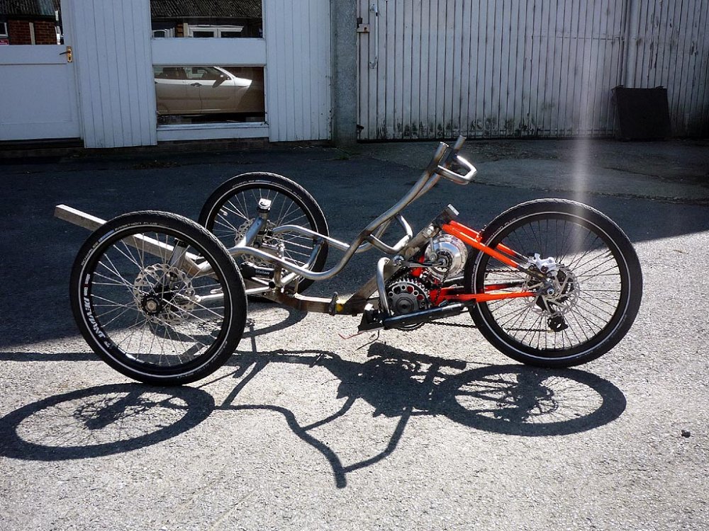

  1. Finally finished and very few problems in the end, it handles well, pulls lilke a train uphill, but I do need to alter the peddle gearing( too much assist and not enough peddle for my needs) I think I need to bling it up a bit to make it more visible, flags ,lights etc

  7. Hi all, Just thought I might give you all a laugh at my efforts at an E assist trike, Q100 hub motor as mid drive and counter shaft so me and motor can use all the gears, it will work or be a very costly pile of scrap HAHA comments of all flavours welcome Thanks in advance regards John

  13. Hi all, having added a hub motor to my partners trike after she rode one of Twinkles machines, I have started building two touring trikes for a trip round the Netherlands,I am using Q100 motors as a mid drive with drive sprocket on the disc mount side to a jackshaft then across to a normal 3 ring crankset minus pedals of course, those are at the pointy end. I have one problem which again seems to mean making my own is the throttle twistys and thumb throttles are just ergonomicaly no use on a trike with bar end shifters and upright steerers so waiting on Hall effect devices to arrive to put in my own push button casing, pics of build to date if anyone is interested, the motors go in the gap in front of the rear wheel Q100 motor S12S controller pedal assist thingy gearing as yet to be decided regards john
