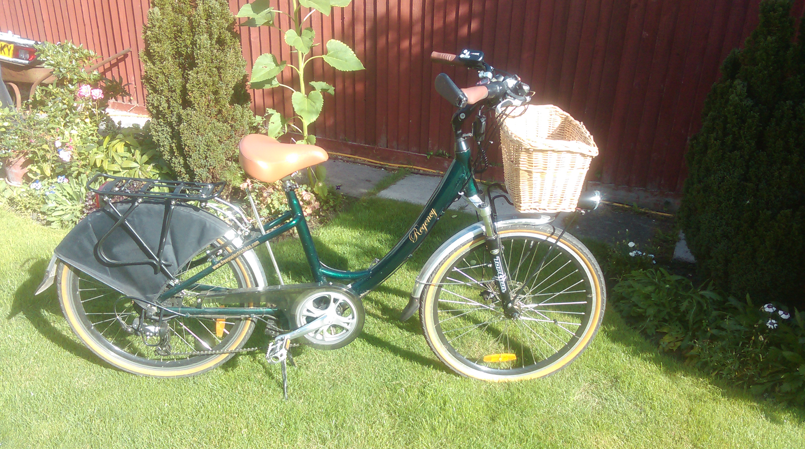

  1. For Sale,Swop The wife wants a folder that we can put in the boot of the car and not have to lift the bike onto the bike carrier when we go off for the day somewhere as she is recovering from a shoulder op and although can now ride , it is a bit heavy lifting it up even for me. We have had the bike from new 4 years ago,and has been in use all the time, it has a 16ah battery that is still providing good miles of travel ,26" frame ,7 gears,3 levels of power assistance full throttle control even from standstill, if any one has a freego folder they would consider swapping with a cash adjustment please contact us . the regency bike is kept in the dry and has only rarely got wet when we got caught when out and about..The bike has only been used probably about 2/3 times a month for trips out in the summer and occassionally to the shops at other times. we are in West Wiltshire but could deliver within 50/60 miles simon.cutler1@gmail.com http://freegoelectricbikes.com/electric-bikes/freego-regency/

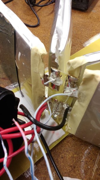

  4. its a Turnigy Accucel-6 50W 6A Balancer/Charger.I have tried charging the dodgy cell with it set to 4.2 v for 60 mins and the cell quickly dies away to 1.5 volts with no load on it after . looking at the way all the 4 cells are connected together its almost impossible to replace. http://www.pedelecs.co.uk/forum/media/freego-battery-pack.280/

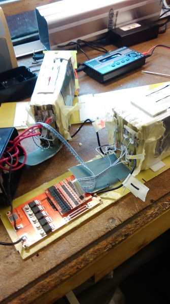

  6. Well, have finally got it all apart,have a Turnigy charger and power supply, now I just need to do is figure out what settings to set the charger to. any one tried this before ? I think one/ two of the cells are below 2.0 v so will try to charge them individually up. regards simon c http://www.pedelecs.co.uk/forum/media/freego-battery.279/
