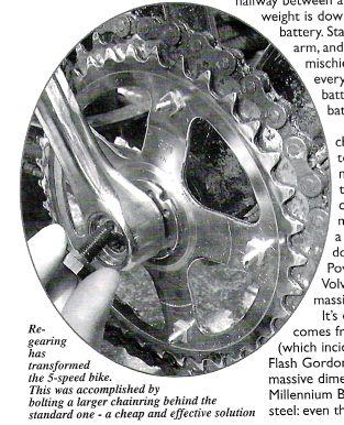

March 10, 201214 yr Powabyke chainwheels were non-standard so yours may be too. A to B magazine solved the problem on one by bolting a larger chainring onto the existing chainwheel as here: [ATTACH]3306.vB[/ATTACH]
March 10, 201214 yr Author Thanks flecc . That`s my kind of solution . It is likely to be low cost using salvaged parts , and has the added advantage that you can return it to standard , or try different sizes . I will keep my eyes [sorry eye] open for parts .

March 11, 201214 yr You need a 48 tooth 5 bolt chainring,I bought mine off Ebay.(you will need to measure the distance between the bolts on your chainring)
March 11, 201214 yr Author @johnone . Thanks for that specific information , that is a big help . I was thinking about it on my ride this morning . Will I have to extend the chain , and how can I work out how much ?
March 11, 201214 yr Any 5 spoke 48 tooth chainring should do, since you'll need to centralise the chainring and drill the chainwheel on your bike to accept it. There's no existing holes to bolt it to. The chain will need to have an extra link for each 2 teeth increase.
