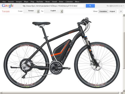

Eddie has pointed me to a new BikeTec Flyer road bike model with this Panasonic motor, this model called Vollblut (Thoroughbred), they've integrated the battery nicely with their trademark "S" bend downtube. Various versions from EU legal to 500 watts and fast:
[ATTACH]6379.vB[/ATTACH]
