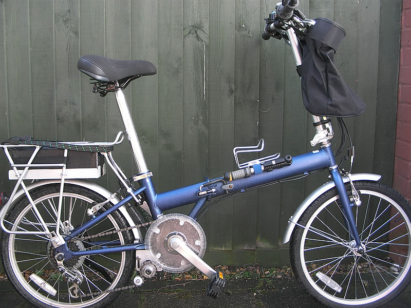

I have just received delivery of my 3rd electric bike, the Viking e-go. I also have a powacycle windsor and previously had a Thompson (lead acid battery). I am semi disabled and need a bike to get around as i cant walk very far. I mainly use my bike for shopping and have panniers on my windsor.
I have just noticed that the e-go has no throttle and requires pedalling to work so i'm now wondering if this is a suitable bike for me. I also cant see how i would attach a rear carrier to it.
does anyone have any experience of this bike?
A rack would be very difficult because of the battery and rear suspension. You should be able to fit a basket too the front.

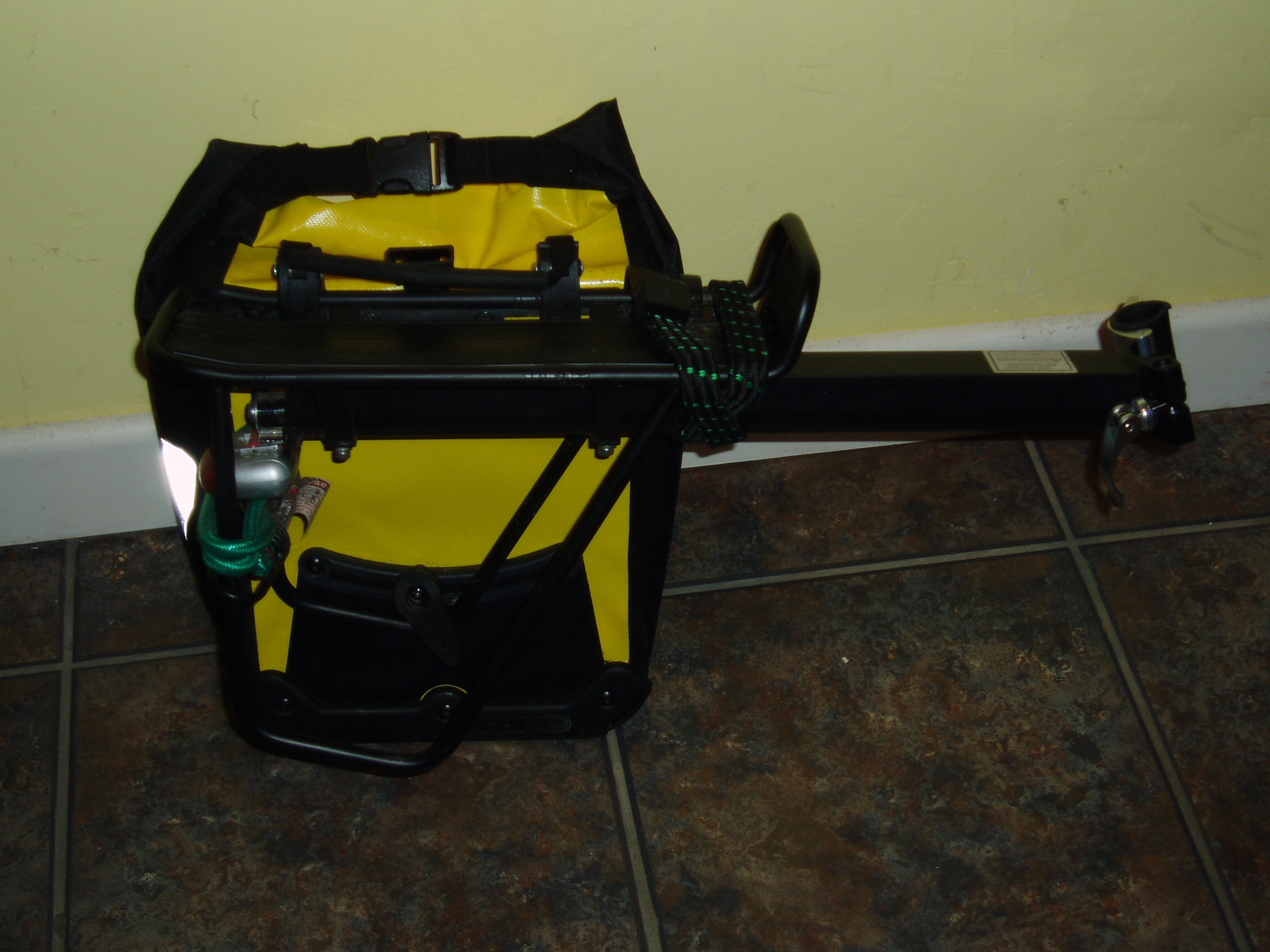

Hi -I have a Tesco Hopper which is almost the same bike. I took off the basket at the front on mine, as i found the steering very twitchy , especially going slowly, and every time you put the bike on stand the front wheel did a 180 degree.

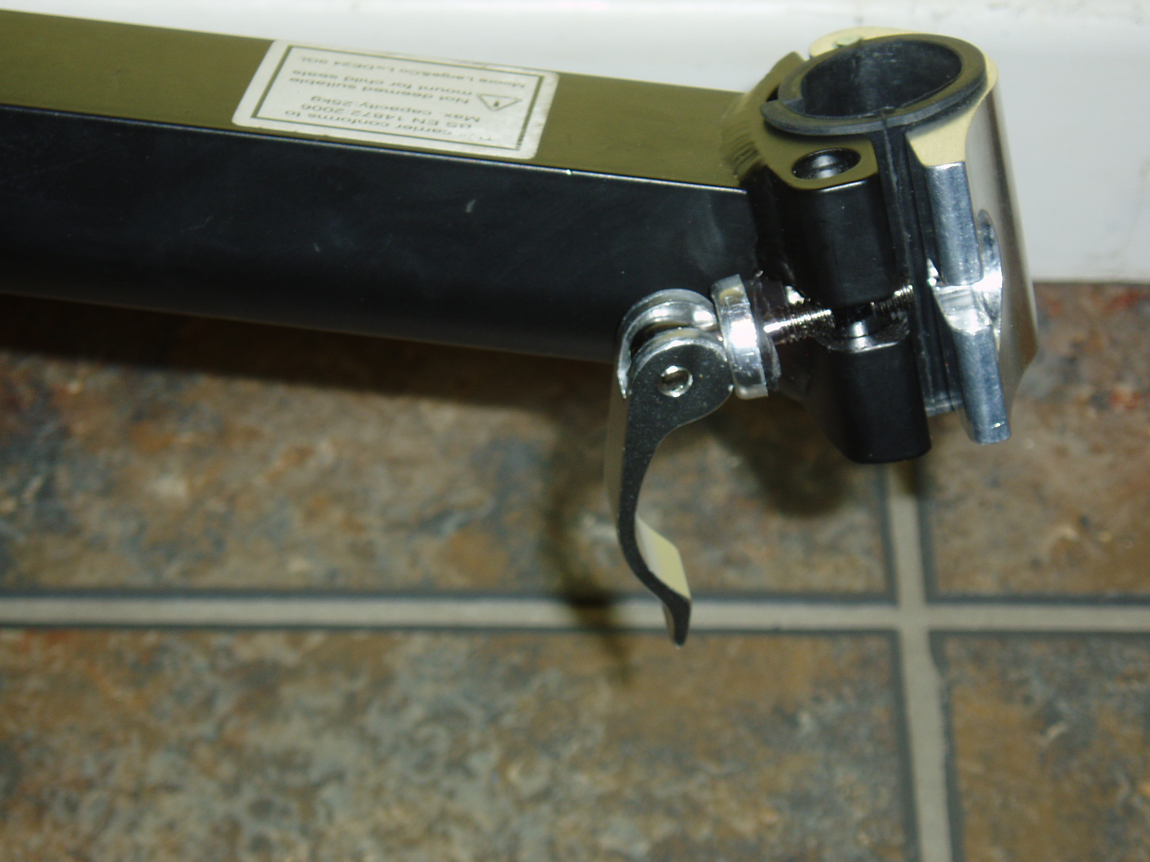

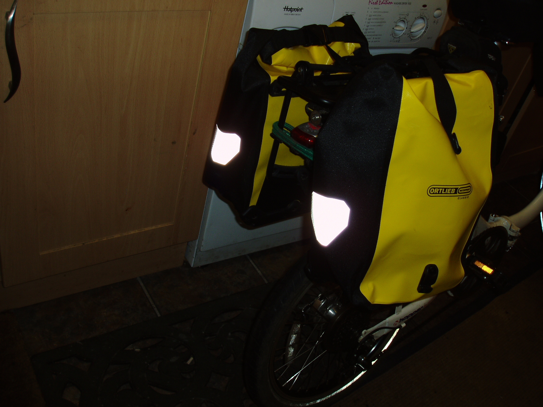

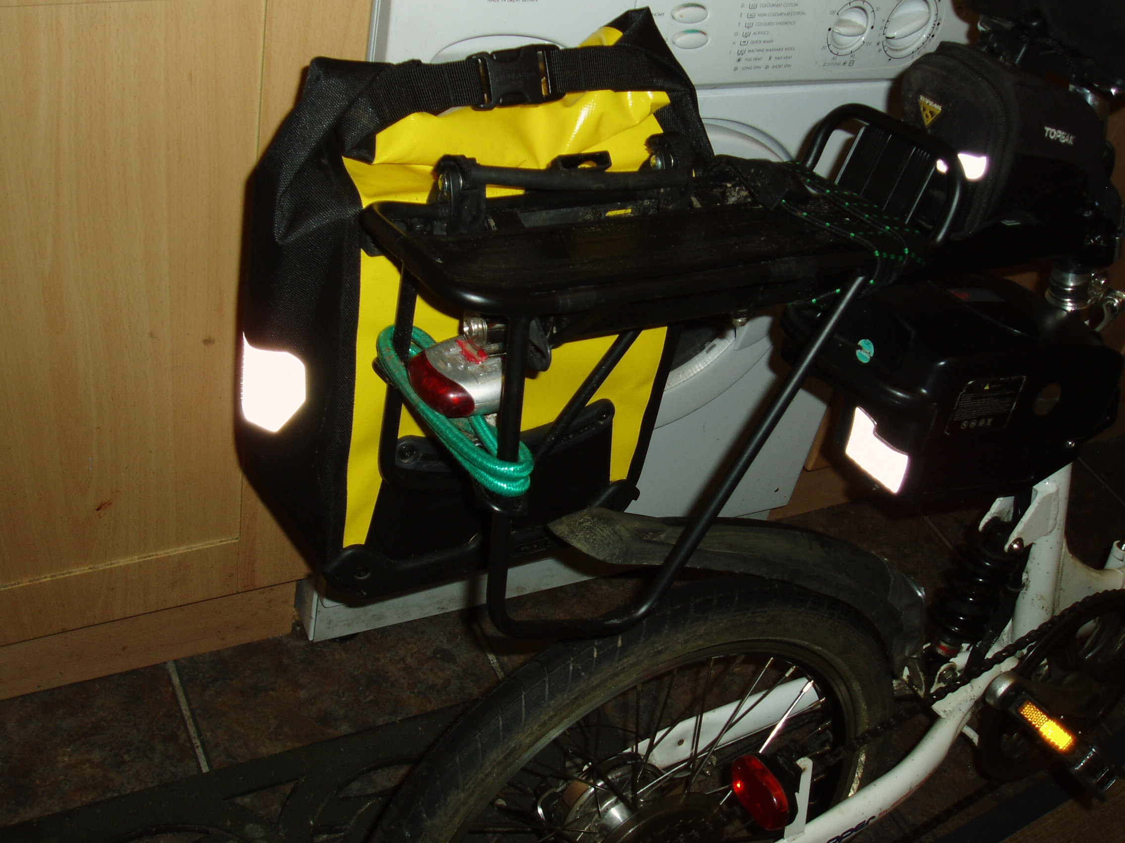

Bought (at £15.00 from Tesco) a seatpost clamp-on rack. Got a pair of Ortlieb Back Roller waterproof panniers. May be a bit pricey, but worth every penny. So secure and takes 2 seconds to lift on and off. These are slightly smaller than the standard ones. But it puts less strain on seatpost, and they are not too close to the ground with 20" wheels. But can still carry a bit more than a basket. There is plenty of room for suspension travel and you can still add or remove battery, and see the LED,s.
You can remove the rack very easily and theres room for a small seat bag for tools, etc.

With 20" wheels i think you have to accept smaller panniers as the full size ones come a bit close to the road.
