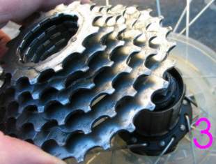

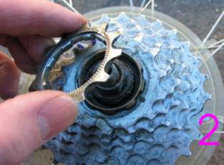

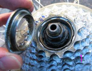

The pics I said
Thanks for your kindness,
These are the first 5 pics I told you in my last post:
n.1 I screw off the locking flange
n.2 the smaller sprocket is free
n.3 the set of the other 6 sprockets (the cassette) can be removed
n.4 that’s the free wheel with outside cogs (not equal divided)
n.5 a detail of the groove in the rear forks, in the Bionx site I red that the system must be fitted with “the notch” (what’s that?) pointing to the ground, but this groove is 30° degrees tilted in respect to the horizontal line and so I must use a strange Bionx tool to rotate that notch.

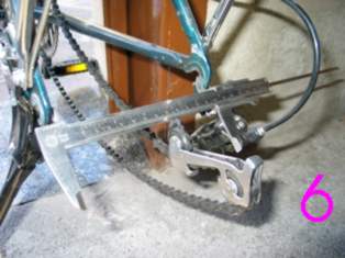

The pics I said
The rest of the pics:
n.6 the inside measure of rear forks: 134 mm (5”1/3)
n.7 groove inside measure: 10 mm

Sorry you've had no answer yet Alberto, but as I'm not familiar with the BionX hub centre I'm leaving this for Nick's knowledge. Hopefully he'll see it soon.
Hi Alberto
This looks the same as mine, and I think the dimensions are the same too.
Unfortunately, I haven't got anything with which to measure this:
I am assuming the sprocket mechanism is a cassette - Flecc? It does not look like the freewheel I got with my Bionx which screwed onto the wheel.
I am not sure I've been much help really - can the Bionx supplier help, or maybe you could email Bionx themselves? As you've guessed, I am not that up on the technical aspects which, whilst perhaps not very helpful for you, is good news in a way as if I get on OK with the Bionx, then anyone should be able to!

Yes, the first four pictures look like the old cassette and the splined centre needs to be removed with a removal tool, you may need to ask a bike shop to remove that for you Alberto.
Once that's off you can screw on the new freewheel with it's sprocket set, assuming the BionX has a standard thread for that, I feel sure it must have. I don't understand the references to measurements and the rear frame measurements or why that's necessary. Perhaps you could explain further Alberto?
Edited by flecc
