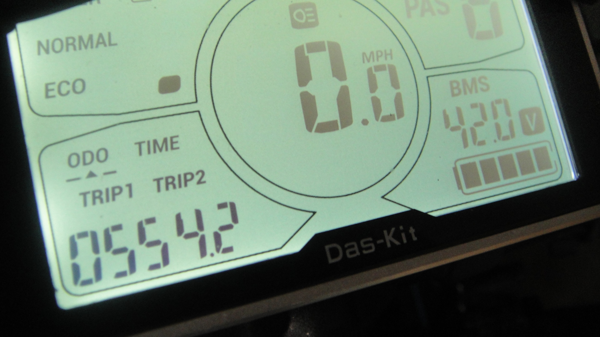

And his other oxydrive kit bike, that I now have, is going well and not too far behind. Maybe they're worth that little bit extra. :)
[ATTACH]15041[/ATTACH]
Yeah I was thinking that looking at them. Maybe ;)
