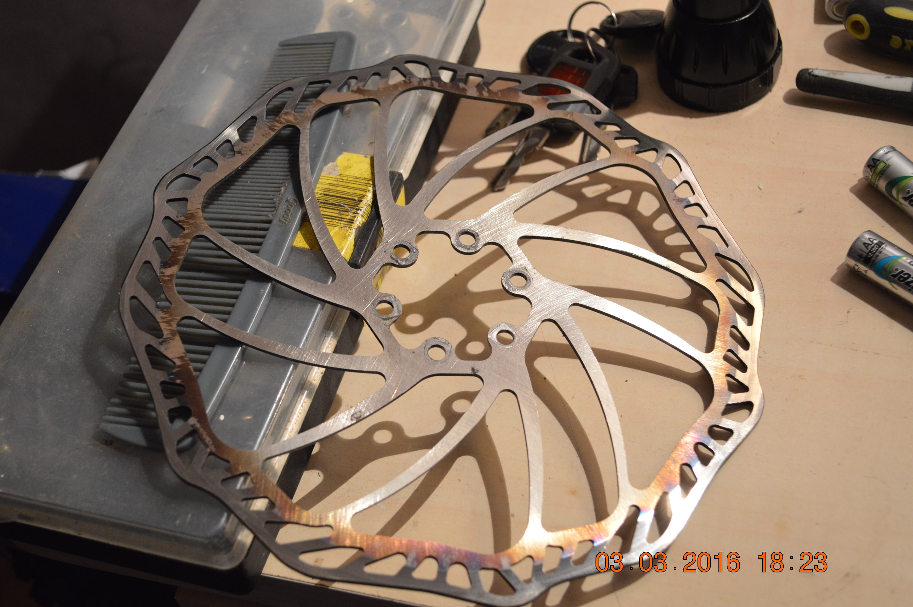

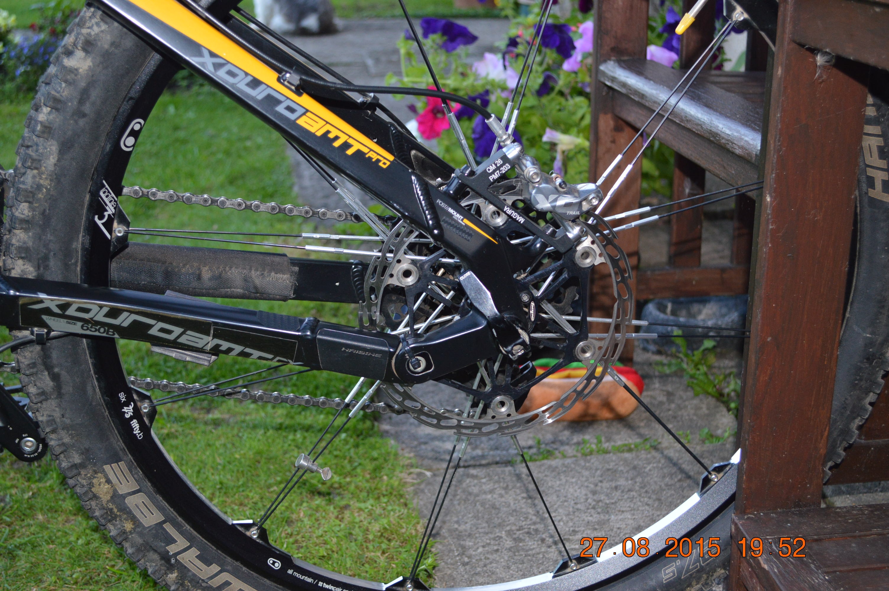

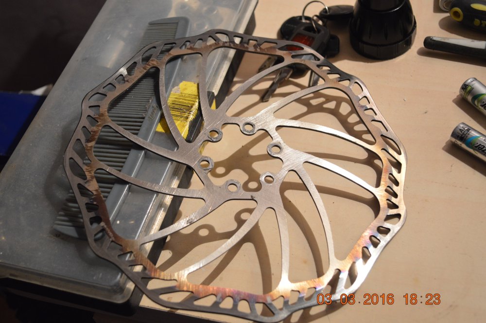

December 13, 20169 yr yes but going the speed you want to go you need hydraulic brakes and good ones at that and decent rotors as well over 30mph i set fire to 1 piece rotors. thats a 203mm rotor of the rear and replaced the with hope 2 part rotors
