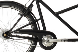

It's possible to flip the cog on this hub to gain about a cm on that, but then the chain rubs against this "intermediate chainstay" I have on my frame.
I have the feeling this is really just for show, but I'm still a bit hesitant to take a hacksaw to it!

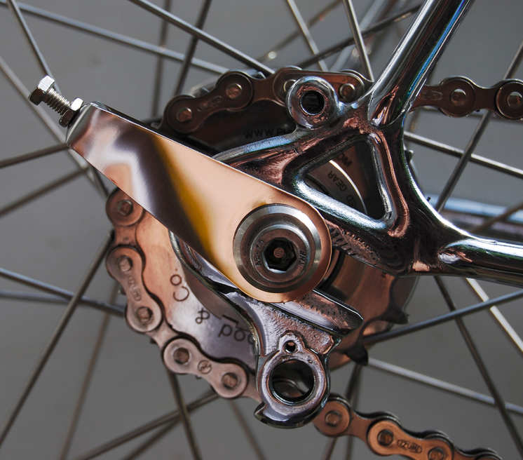

[ATTACH=full]19034[/ATTACH]
Sorry if I'm being foolish but do you hub gears (like photo appears to be) or deraileurs?
I have a feeling I am missing something here!
If you have hub gears then a singulator or tensioner can help
Exactly. But at the moment I have less than an inch of play. The frame is built for hub gears after all.
I guess I could make a couple of tensioners like this if I wanted it still tighter with more fine-grained control.
On the other hand the spring loaded tension provided by a singulator could be qualitatively different in some way I've not realized yet. :)

What I find slightly confusing is that I have horizontal dropouts, so I can make the chain as taut as I want, but you write as if it's self evident that a singulator would be better.
Are we just talking past each other a bit here, or am I just not aware of why these spring loaded options are superior?

In my mind (and im no engineer) the difference is the you set chain tension with horizontal drops. Once done real world influences such as chain stretch , big bumps and rattles of actual cycling can only mean increased chances of. the chain jumping off/slip. Riding can only in the setup deteriorating over time
In my own words a "passive" solution
A singulator /tensioner is, again just my words, an "active" solution in that it should respond to the changing variables around it (e.g. Chin stretch) and maintain tension. Setup shouldn't deteriorate in the same way
A singulator /tensioner is <snip> an "active" solution

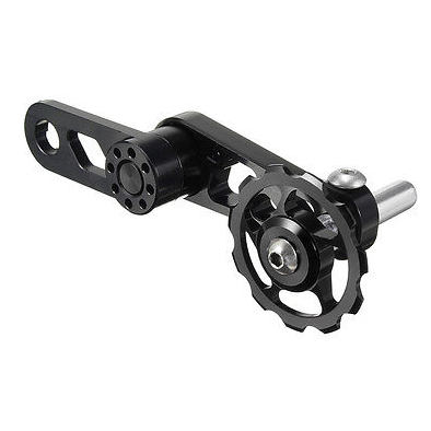

I hope that's not your bike. the chain joining link clip is on backwards.
It makes little difference whether you use a tensioner or adjustable axle locks, although I think a spring-loaded tensioner is better because you don't have to keep adjusting it.

You could say the problem is the 32t bling-ring. The original Bafang 46t massive steel Frisbee from hell "wraps around" the final drive gear much further and provides a chain-line with with possibly just half of the offset. However the bike came with a 34t chain wheel and considering the heavy cargo and hilly terrain around here I don't really want to go in that direction.
If I encounter problems under load with the motor, I think I'll try a singulator first, and then see if I can get that "intermediate chainstay" changed a bit so I can flip the rear cog.
