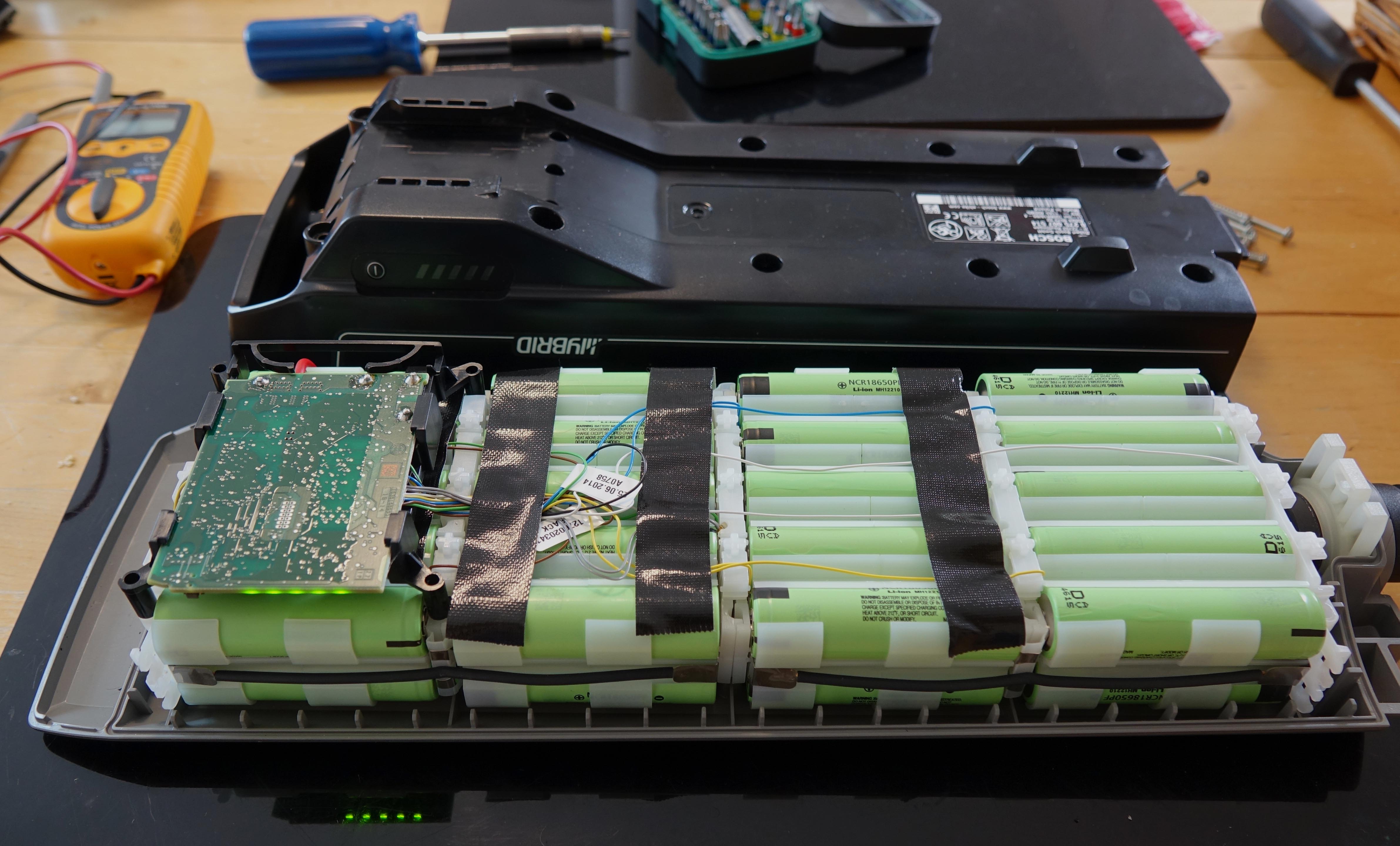

Won't seem to charge past 39v. All cells I can reach with the multimeter read 3.89v, but I cannot read the accumulative voltages, the pins are just too small for the multimeter.
Also, although the incoming voltage from the charger also reads 39v, there is a third pin to/from the charger, so DC voltage is only turned on at the charger when a specific signal is received from the BMS, this makes it very difficult (thanks Bosch) to diagnose, for all I know this voltage isn't fixed at 42v and is increased from the charger as required (how else do they justify £140)
I actually suspect the charger rather than duff cell or BMS, anyone in the Gloucester area with a Bosch active charger/battery so I can see quickly where the issue lies?
Don't worry about the fifth charge light being on, it's just the camera capture moment, the fifth light keeps blinking forever indicating incomplete charge, I can also assume that all lights solid indicates full charge as there are no lights on the charger or anywhere else to indicate completed.

All options are welcome, but there is a discrepancy between the bars on the battery and the LCD display. Unfortunately as the pins are so close together on the accumulative voltage returns on testing, I shorted across two and melted the wires. This makes it way more tricky to fix. Nothing connected to the BMS so no other damage but the individual cells are losing charge overnight with no connections except the total voltage to BMS. Down from 3.92 to 3.82 with no load. Anyway I'll get the charger tested, probably purchase a new battery so the summer isn't wasted and then try to get some money back by getting this one repaired. Looking more and more like a dodgy cell drawing voltage from the rest, no warm cells or BMS though, energy just disappears into thin air.

.. when you are getting the charger tested, you should also get the battery tested also. If the charger was connected to the battery at the time of taking your measurements. It was probably in constant current mode and adjusting it's voltage to suit the current, so a reading of 39v would not be wrong. Not happy to hear about melted wiring and how confident are you that the BMS was not involved?. As I understand it, and I may well be wrong, the Bosch units have microcontroller intelligence in the battery pack identifing energy per cell and number of charge cycles , so if it were disconnected, it would need to be reset
You might expect a small voltage drop after a number of hours off charge, it doesn't signify power loss just charge redistribution. The extra amount of energy stored in the last few millivolts per cell is negligible, as a discharge curve for these cells would show.
Just reading similar stuff online regarding "suicide" tamper chips in Bosch powerpacks since 2014. Mine is probably post this, but close to this date being an active model. The microprocessor certainly gets readings x 10 for every 4 cells to check accumulated voltage is even. Cannot get the battery tested in its current state, although I could desolder the main inputs and charge unbalanced to check total voltage. Also according to my kids who can hear higher pitches the BMS board is buzzing.

Well the motor is an "active" which is gen2? So how can you tell for the battery pack? Also some of the balance wires are disconnected/melted, but (and I'm not sure) these are read only by the BMS, the main voltage supply is still connected.
all i know is the gen 2 batts bms is tamper proof and the gen 1 batts could be easily re celled as been doing it on the german site for ages now even adding booster packs to them.
best bet is to give jimmy at insat a ring and see what he says as it is the only place that can fix it if it has a gen 2 bms.
