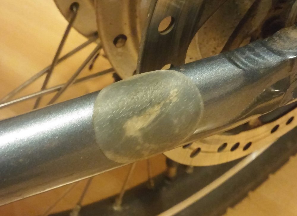

Pic shows how handlebars scuff frame when folded down on Gale. Suggest a rubber buffer is glued on frame to avoid damage to paint.
Pic shows where forks scuff frame when Gale folded. Suggest another rubber buffer here to avoid damage.
Pic shows where forks scuff chain-stay when Gale folded. Suggest yet another rubber buffer to avoid damage

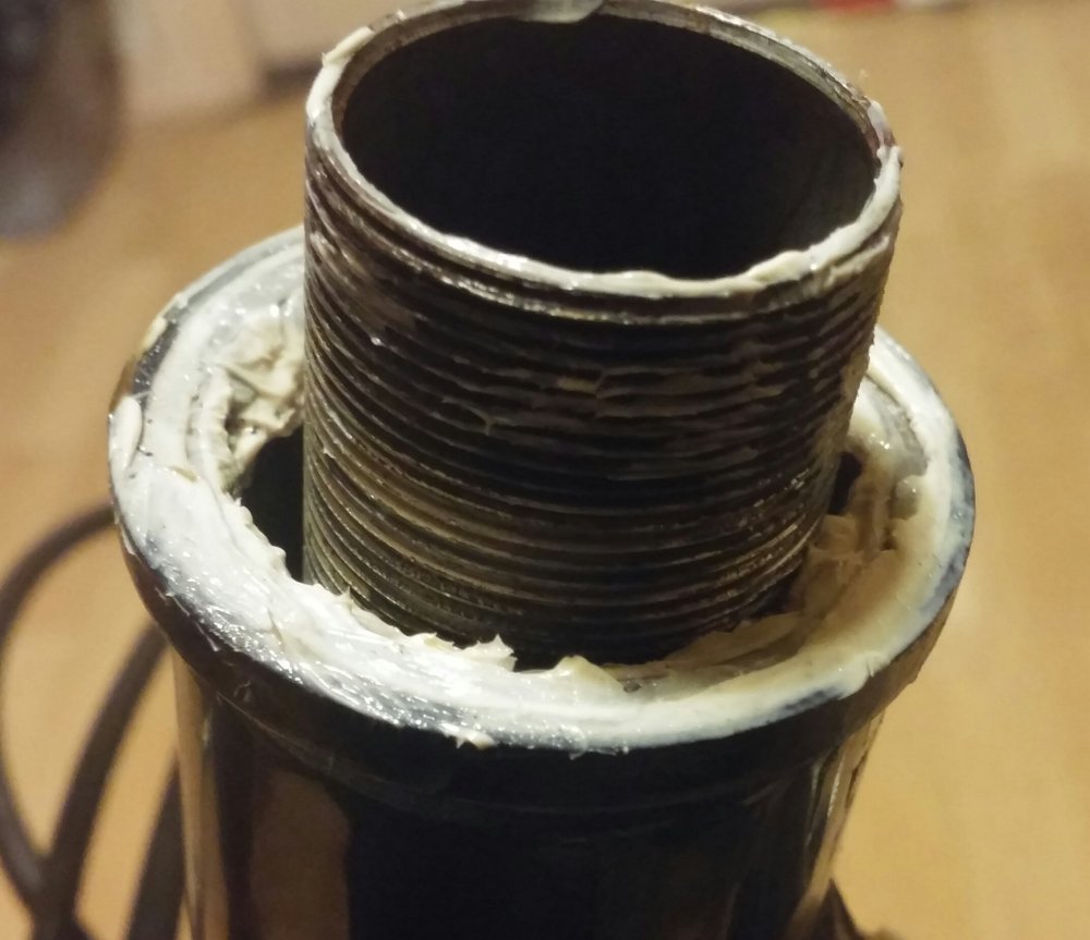

The Gale headset may wear prematurely, and you may be unable to keep them adjusted. So fit new ball bearings in cages, with plenty of grease and hope the bearing races have not worn thru the hardened layer, or you'll need a whole new headset. Not expensive, but a fiddly job or costs if a shop does it.

If you mean to Velcro ON some buffers, yes. If you mean Velcro the frame folded, no, that wont prevent the parts of the frame damaging each other. I mean rubber buffers in BETWEEN the frame parts. They could even have the Woosh logo on them and be used as part of the branding on your folding bikes.

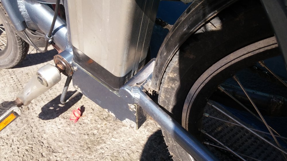

20170708_182314.thumb.jpg.ba440d1d21b77147ab07018448b2ed6d.jpg Also if the Gales rear mudguard wasn't cut short but came down to the bottom of the controller housing it would keep water away from it and keep the bike cleaner. 'Two birds..' again :)

Rain still getting in even tho ive plugged both cable entries! A rear mudguard like this would stop rain being directed over the frame to the bottom of the battery pad and into the controller housing.IMG_0689.jpg.f364218a2c15307fee383282d53a0166.jpg
the controller is well sealed, so it can resist a little amount of water but not for long, the water needs to be drained.
If you don't want to keep the cabletie on the lid of the controller box, you need to drill a 5mm hole at the lowest part of the controller box to channel the water out.
