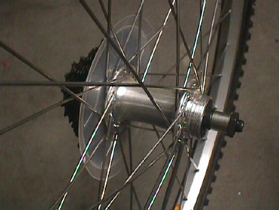

I forgot to mention - the 50cycles Izip has a Shimano 7-speed freewheel "block" i.e. not a "freehub cassette", so would that imply that the motor/wheel must have its own freewheel?
Any geared reduction in a Currie takes place in the motor & chainwheel cog system, no? So shouldn't have the same issues as hub motors? That's another reason I'm warming to the Currie :)
As for the difficulty of pedalling unassisted, that could mean "difficult to accelerate" which is possible for a quite heavy bike, & in the context of using motor power to "get speed up on a relatively flat canal towpath as the bike is hard to pedal unassisted" it seems clearer to me, since the towpath if a bit muddy, would be hard work to get up speed on even a lighter bike.
I read elsewhere that "since the top speed is only 15 mph, and the bike is quite heavy compared to traditional bikes, it's alot of effort to go faster than 15 mph, since the electric motor freewheels and offers no assistance at speeds over 15mph" which I find harder to reason out unless either the freewheel is somehow resistive at higher speed or, possibly, the rider is unaware & unfamiliar with the extra forces acting against travel at speeds of 15mph+ such as much higher wind resistance. I've heard it said that when the power assist subsides at the motor's top speed, it feels like you hit a strong headwind suddenly, and it seems to me that's what is being said: so its not really due to the bike's weight that its harder to go much faster, but simply because you are overcoming air resistance by legpower only beyond that speed, and suddenly its not so easy to accelerate further :).
So its not conclusive, but I'd be surprised if the Izip did not have a reasonably good freewheel.
