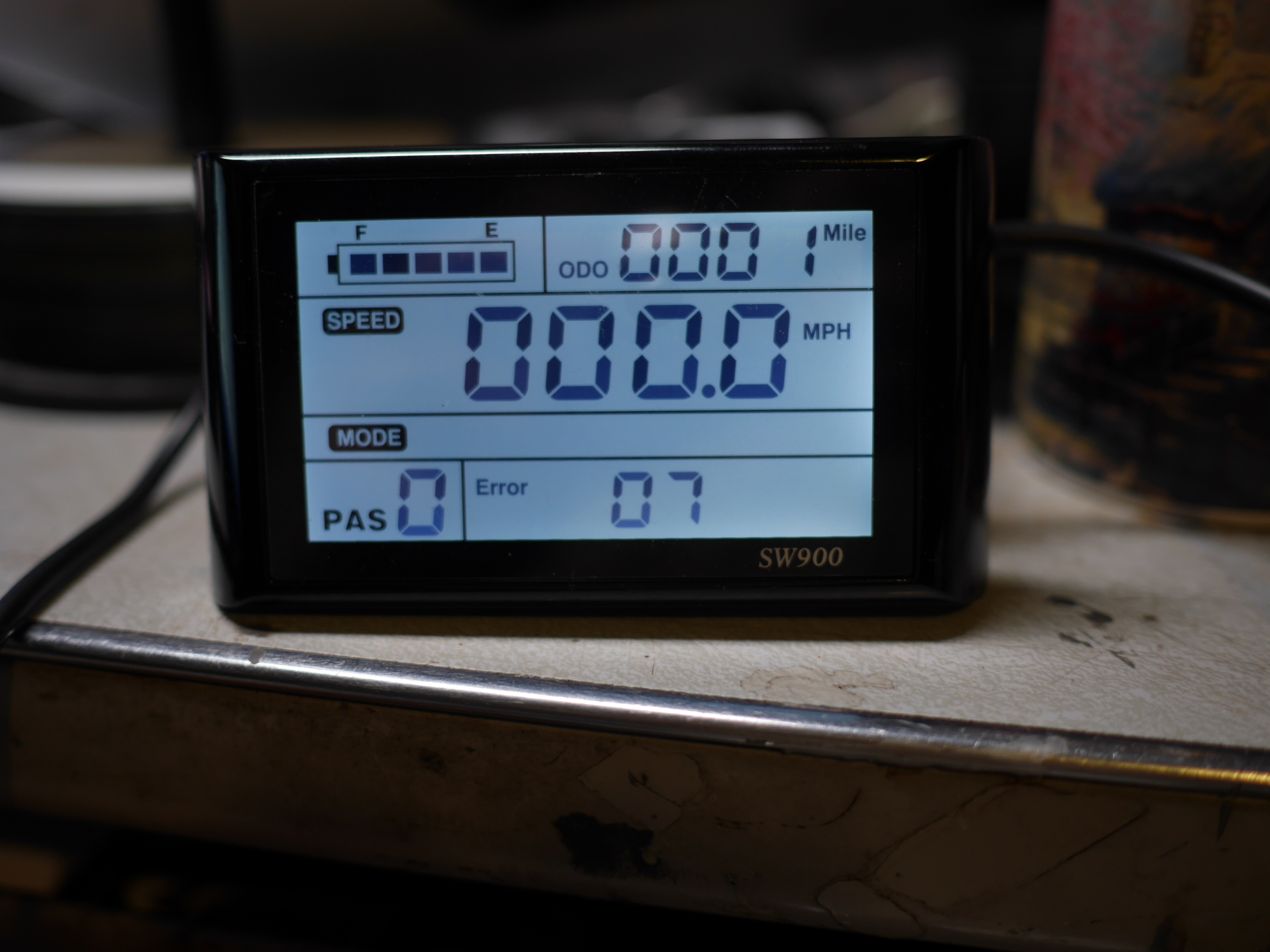

You UK guys might know more about this display. I have used KT controllers and know how to wire in a speed sensor. The controller that came with the SW900 doesn't have a separate connector for speedometer. It doesn't show the speed when coasting. Might be a setup issue, but I think it needs a sensor.
There might be an input on the controller circuit board, but I'd have to just guess and probe by trial/error. However, the docs for the SW900 says it has an extended function for speed sensor, as well as lights, etc, but I only have the typical 5 pin plug with power, Rxd, Txd, etc. I've googled and found a picture of the SW900 with an extra two pin connector, but no description.

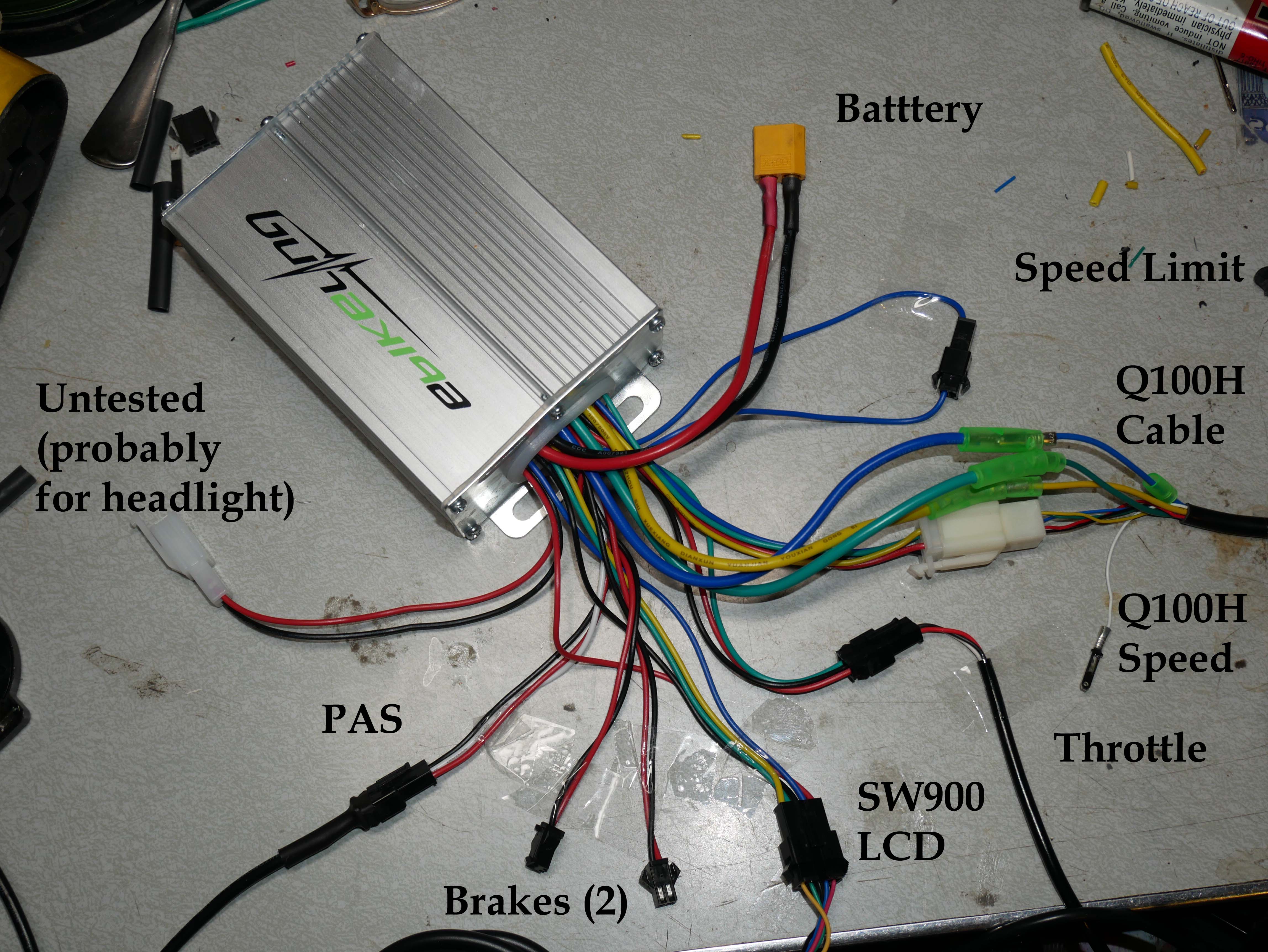

Post a pic? Sure.

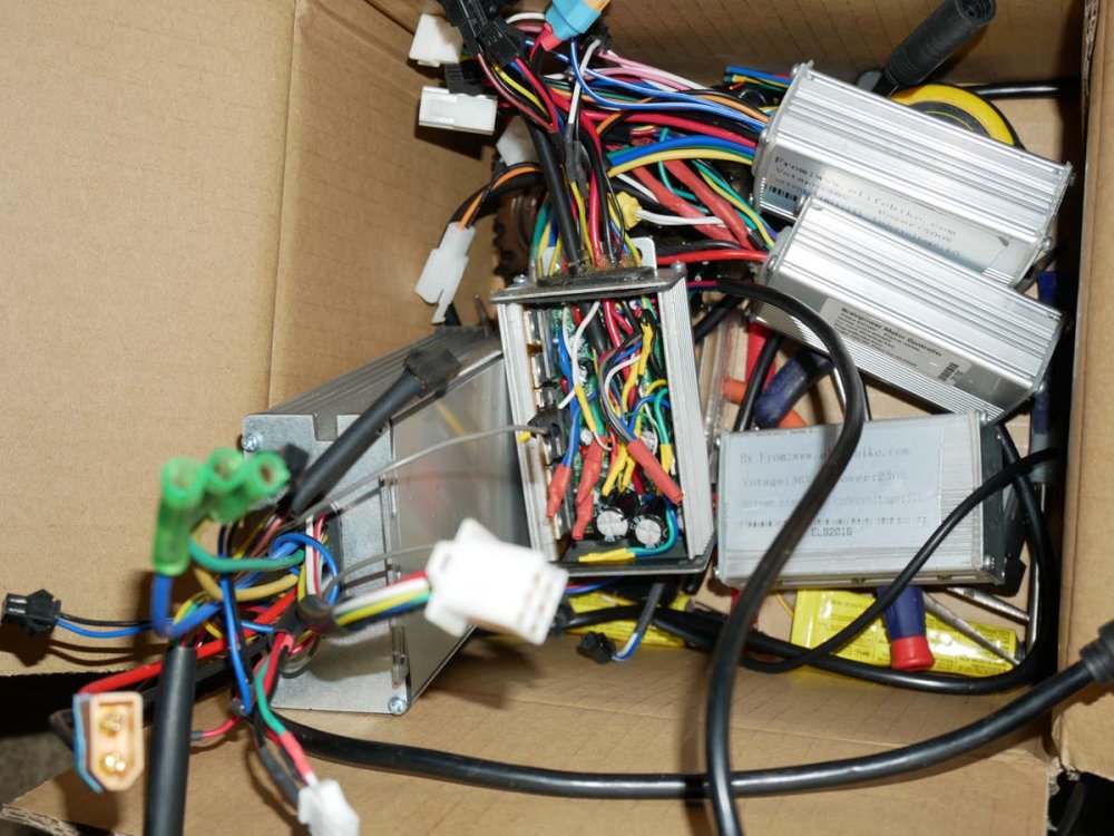

The first is my parts box, working controllers but unused because they were either too low in power or too big in size. Not a newbie.

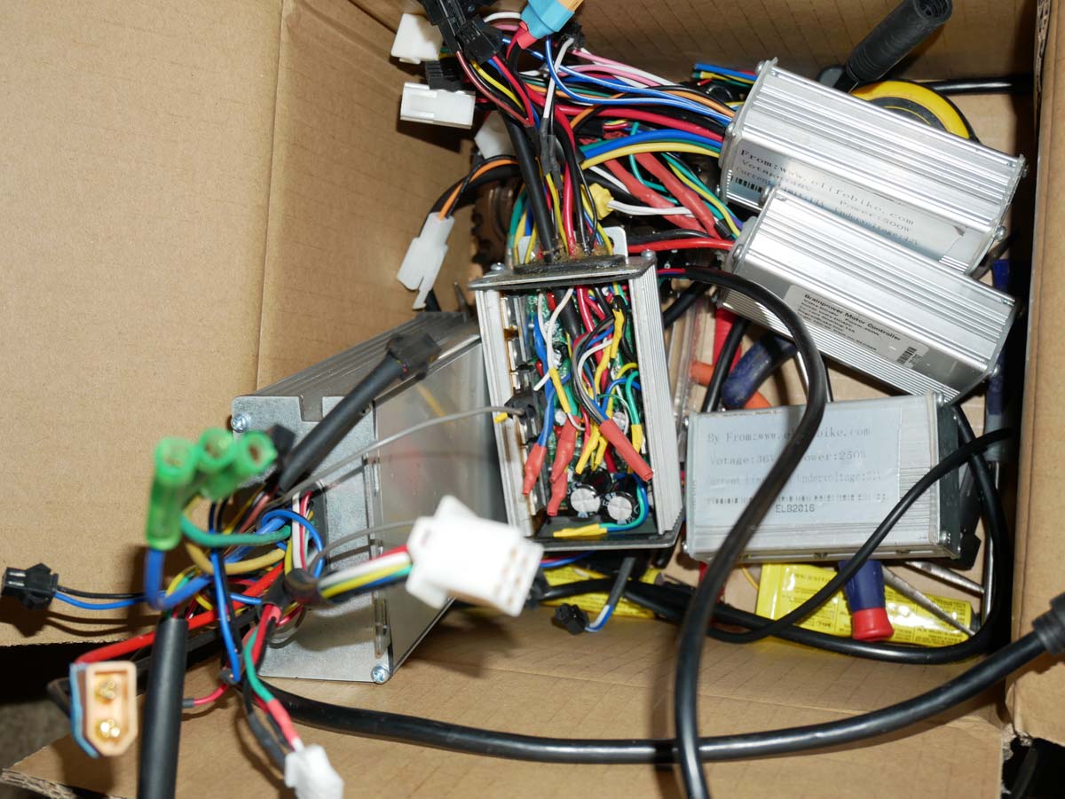

The second is the controller in question. I've tested it with every connector as labelled. The controller's Hall plug only has the 5 Hall wires, so I plugged in a Q100H motor to show the lonely white wire. Everything is spoken for, except speed.

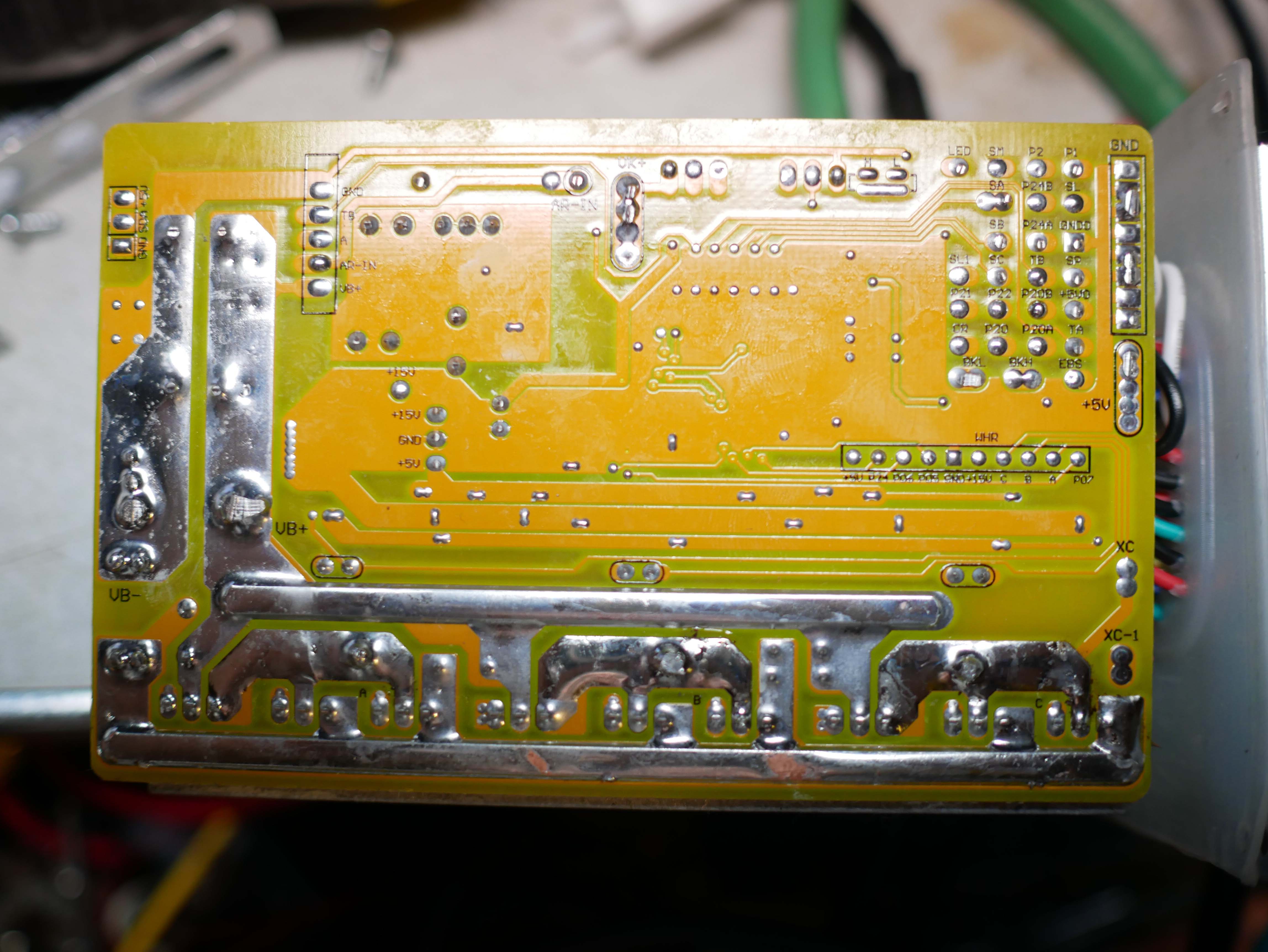

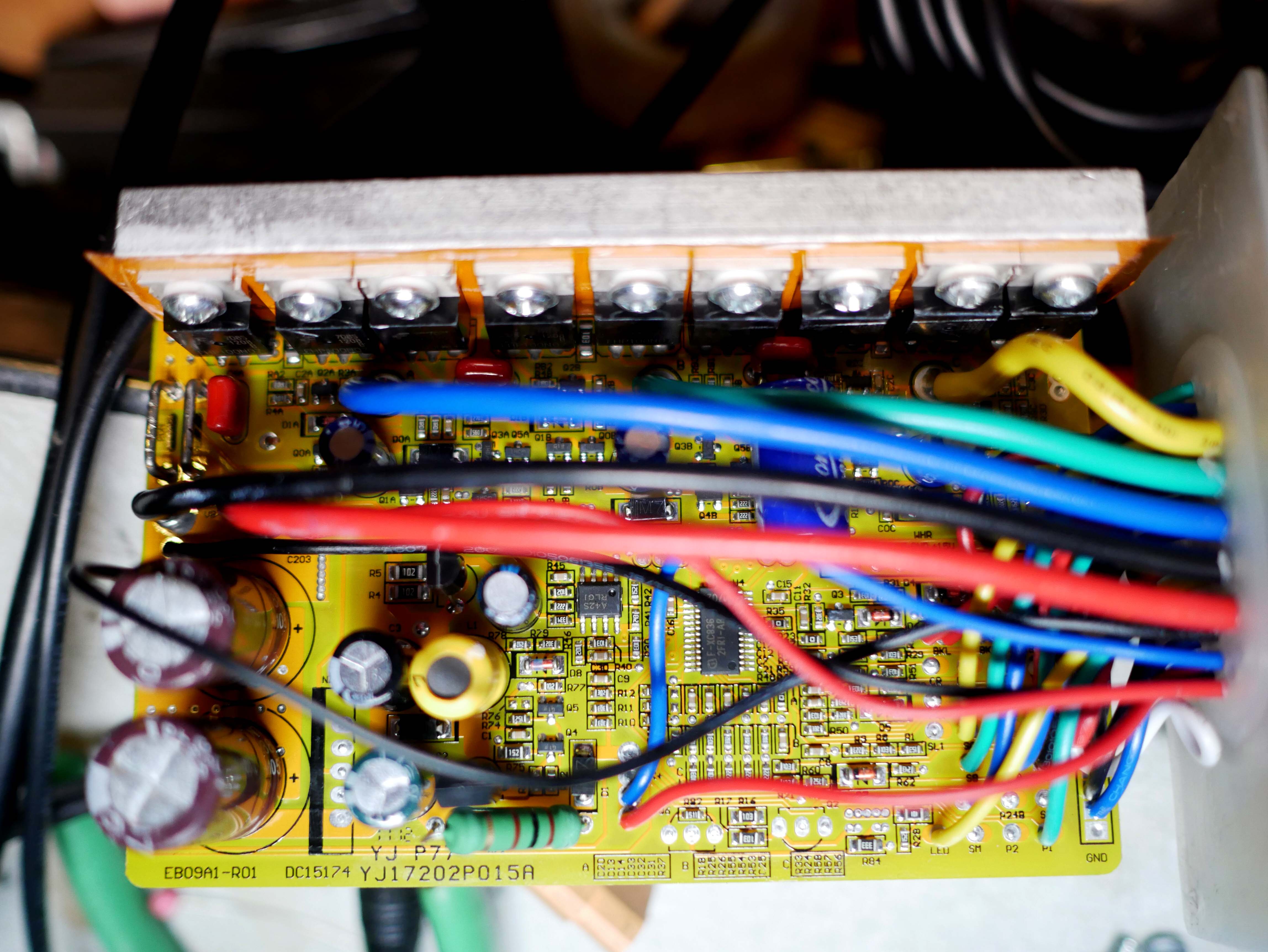

Third/fourth are circuit board. There's an array of inputs in one corner on the 4th pic. One or two of them appear to have no wires connected. I may have to poke a speed signal and test ...after I ask the vendor if his factory can tell me.

Sp looks promising. If it's not already used, solder a wire, then tap the other end on the 5v and ground to see if either gives a speed signal. Often, there's an LCD setting too, to tell the controller what to use for the signal.
I guess that controller was intended for a DD motor. They never tell you that when you buy them.
Could be SP. My eyes are too old to see what's on the controller unless I look at a picture. I'll hook up a speed sensor output and probe around.
The seller sells both DD and geared. Might be the same controller. I suppose many DD guys are on throttle 24/7. Gotta be boring.
All the speed sensor does is provide a pulse. For testing, you can use a single wire, like I described above.
While I will everntually be using the motor that came with this kit, I already got the proper signal wire already coming out of my Q100H motor. Just gotta poke it around and see if the LCD responds. Will put a resistor on it.
Failed. I found 25 unused pads, split between 0V and 5V levels. as unable to produce a speed reading connecting a working speed sensor to any of them.
Oh well, my pack of inexpensive bike computers arrived in the mail today. They will always work,

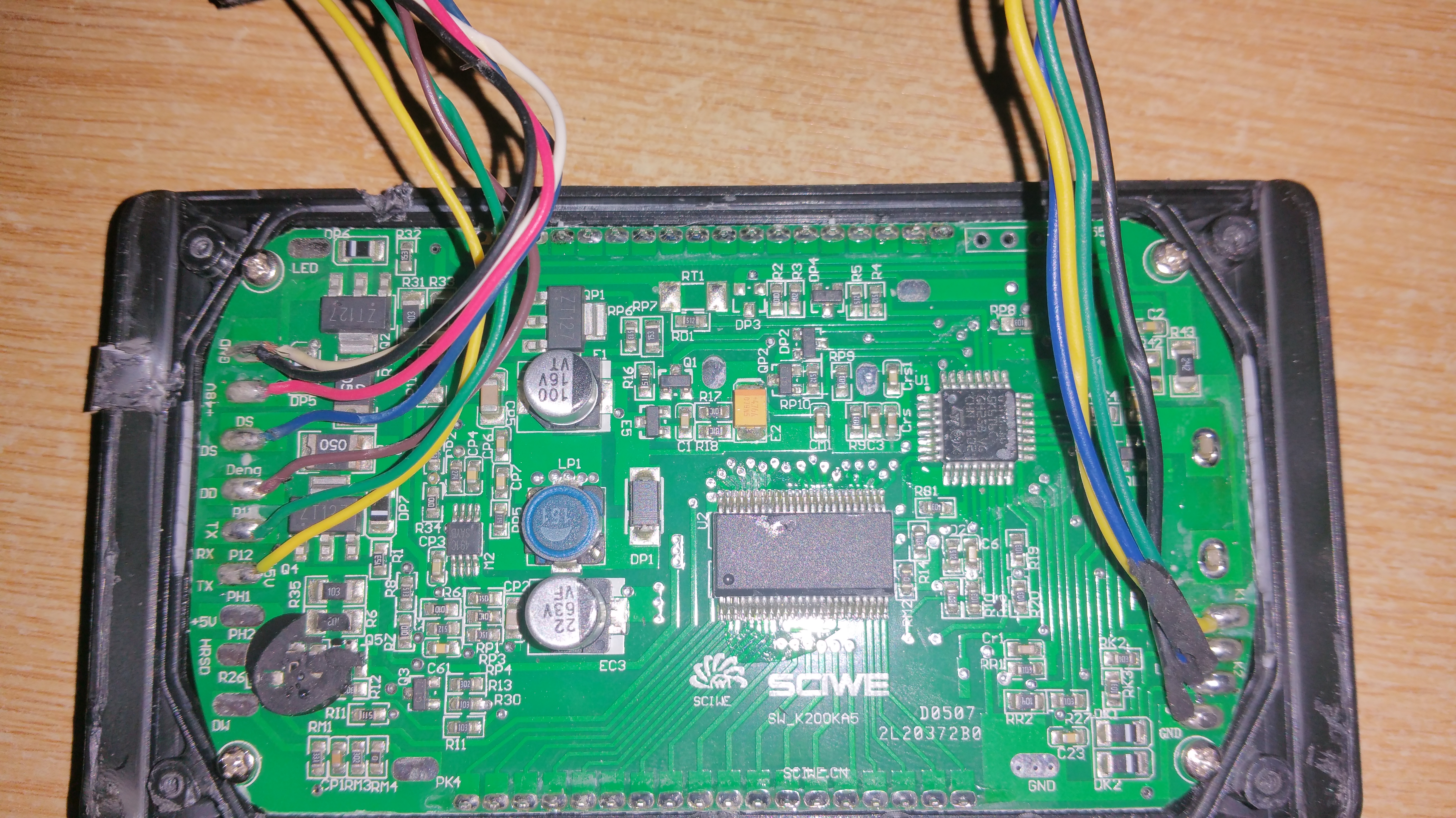

Hi I was wondering if the 2 extra wires on the sw900 was a speed sensor and found this thread and a another saying it was lights.
I connected the red and black to a 52v battery and the brown and white where putting out around 45v and when I turned the lights switch on it dropped to 11.75v. switching the lights off it returned to 38v .
Opening it up (lucky it was broken as it definitely is now) and the white wire goes to ground and the brown ro "deng".20200110_201205.thumb.jpg.e4c05bdccc9534e4d419f0f17a8b4371.jpg
