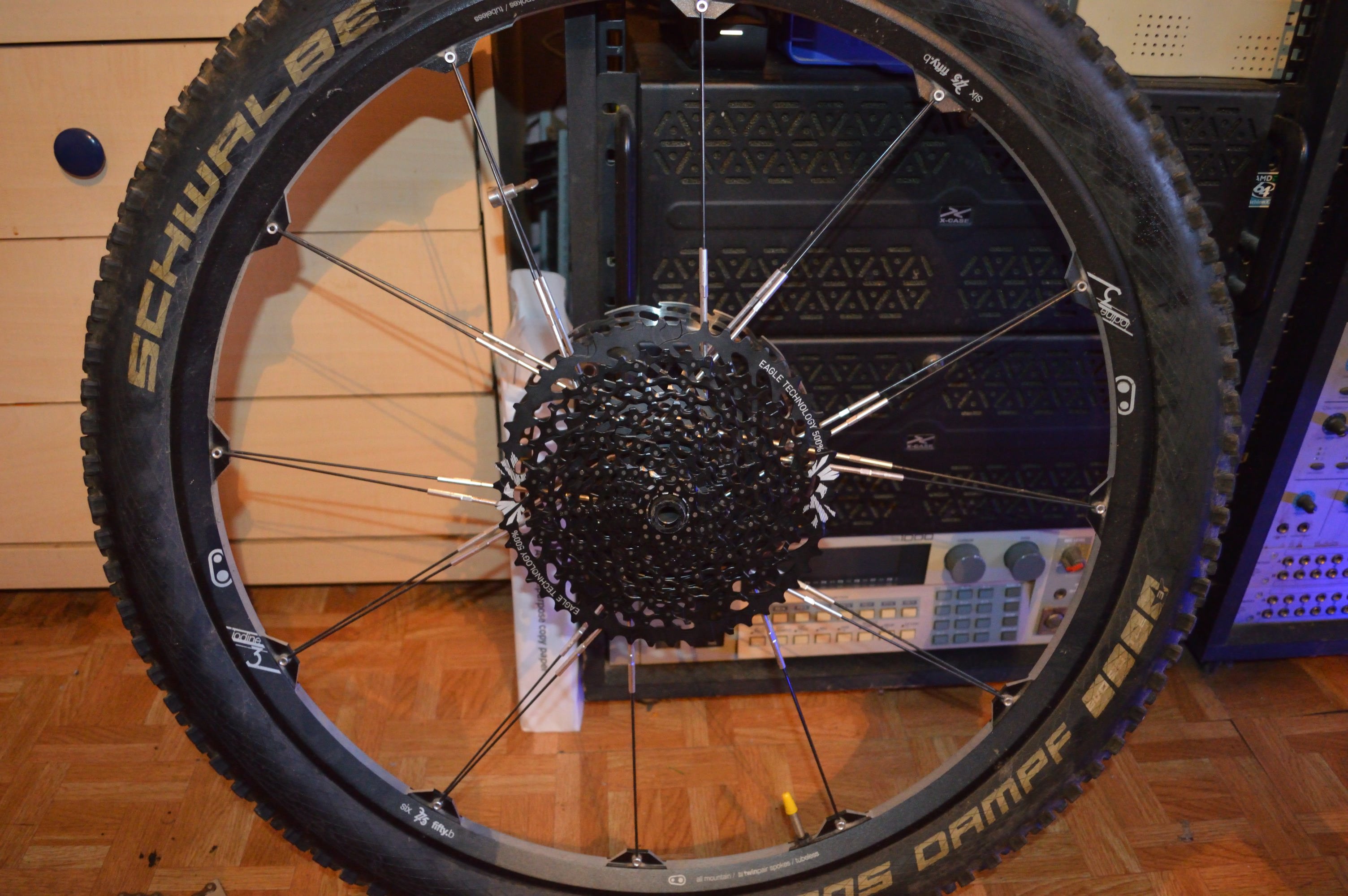

June 25, 20187 yr you will need tape as not many wheels have no spoke holes like my crank bros wheels that has a solid rim and no holes to adjust them as mine are in the middle but the spokes cost 20 quid each! n only 1 lbs can true a wheel like this.

June 30, 20187 yr Wow SW that looks suspiciously like an Akai sampler in the rack...not seen one for years. I still have my expanded s950 in the loft but the Atari (and cubase) went many years ago . Good days
June 30, 20187 yr it is and it still works not like today's crap! also got a s5000 and scsi drive and replaced the floppy with 8gb compact flash memory. dont do bugger all these days tho fkn instructions is the size of the old yellow pages.
