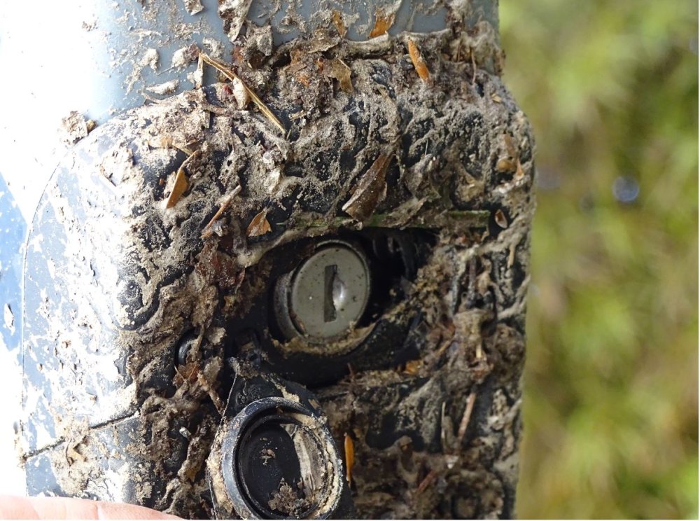

Moving on to the battery, I cannot pretend that I am generally a fan of fully integrated down tube batteries, and in the case of the Scott, this is no exception. I struggle to see any logic or reason to mount a battery, with the power on button, the key position, and the charging point, all facing the front tyre, and in a position that means that everything gets covered in mud within moments of starting a wet ride. I’m sorry, but that is to me a design disaster. The battery is also not the easiest of designs to install and remove, but others I’m sure wouldn’t share this opinion, and might even like the downtube mounted design.

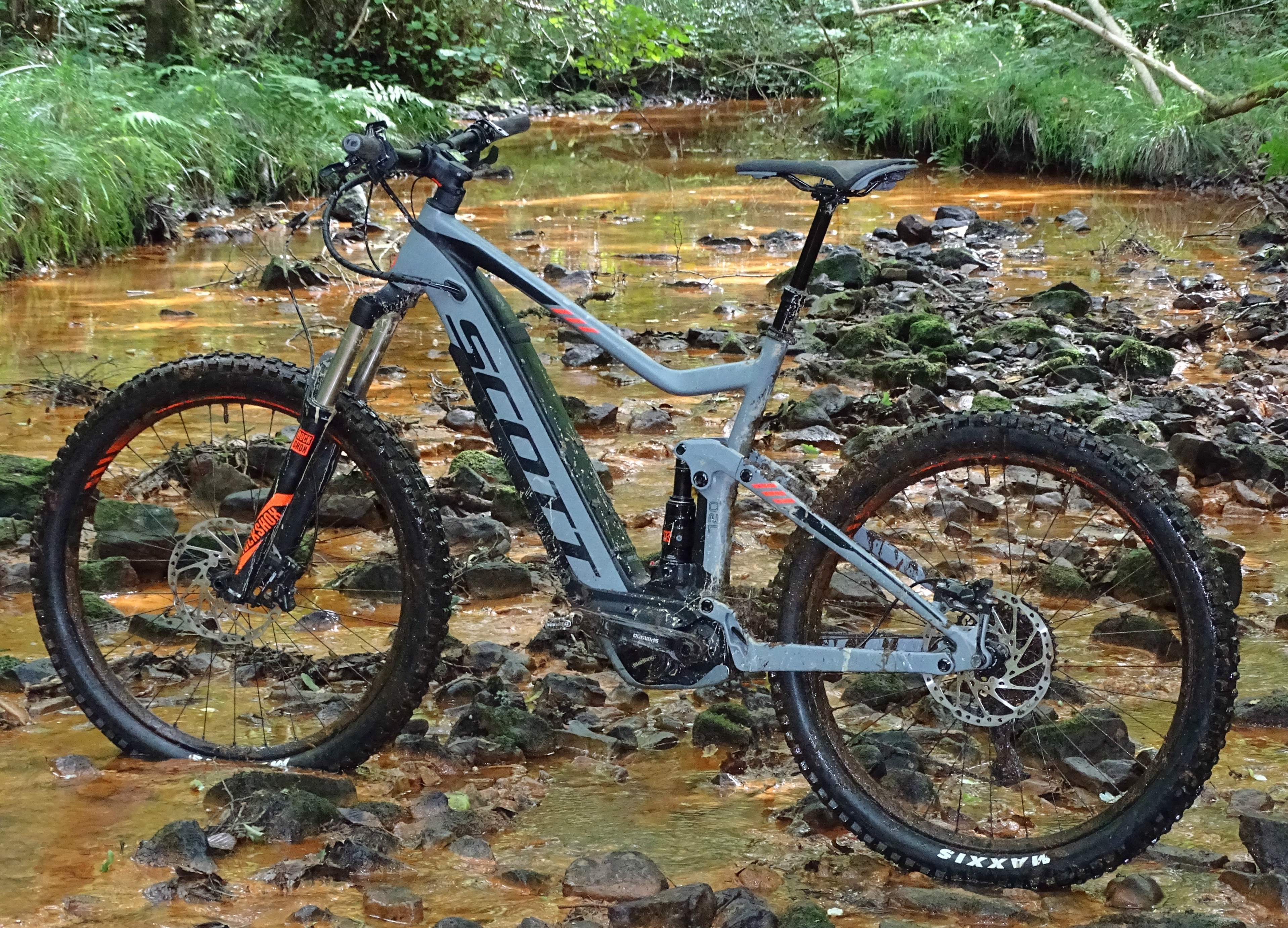

Any eMTB test wouldn't be complete without a little mud, and as lovely as the summer weather has been, I'm really missing my wet and muddy fun.

I have just come across the following photos that I had long forgotten about.
Why would anyone design a bike with such a poor battery and lock location.

I own one of these and have to agree with concerns over battery location but to date it has never actually got the contacts muddy so all good on the point to date
